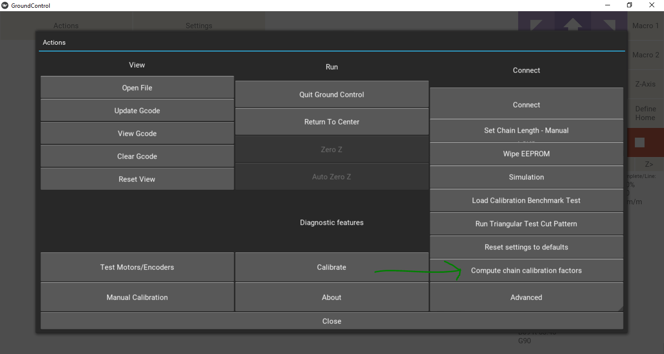

**Post date:** [May 8, 2018, 5:47pm UTC](https://forums.maslowcnc.com/t/what-must-be-adjusted-to-correct-out-of-round-circles/3162/111 "2018-05-08T17:47:19Z")
Here’s where things are on my end.
I’ve got the automated process for computing the chain tolerances finished and it will be included in ~~1.14~~ 1.13 which is released on Wednesday. The process asks for a manual measurement from the edge of one motor to the edge of the other then measures the left and right chains automatically.
It seems like it’s working properly because after doing the process to compute the chain correction factors I get the same number for measuring manually and for measuring in the automatic way during the calibration process.
The bad news is that something is still wrong somewhere with the way the chain calibration factors are interacting with the rest of the system because when I use my automatically computed chain calibration factors my accuracy drops considerably to 3.66-1.39 which is much worse than what I see after using the automatic calibration process with the chain correction factors set to 0 so I would still recommend leaving them at 0 while I keep digging.
I would be interested to see what chain correction factors the process computes for different folks to we can start to establish a range of what is normal. You can launch the process under the **Advanced** tab:

**Post date:** [May 8, 2018, 8:03pm UTC](https://forums.maslowcnc.com/t/what-must-be-adjusted-to-correct-out-of-round-circles/3162/113 "2018-05-08T20:03:10Z")
Yes, they are separate for now. When the new one works well enough that it’s an improvement over the regular calibration routine we can integrate them.
I recommend computing the chain tolerances by clicking **Actions -\> Advanced -\> Compute chain calibration factors** , snapping a screen shot of the last step and posting it here so we can see how similar our chains are, then setting the values back to 0 in the settings for actual cutting.

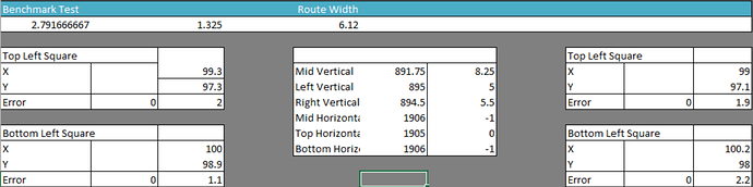

**Author:** ![ScrumdyBum](https://yyz1.discourse-cdn.com/flex031/user_avatar/forums.maslowcnc.com/scrumdybum/32/4779_2.png) [@ScrumdyBum](https://forums.maslowcnc.com/u/ScrumdyBum)\
**Post date:** [May 23, 2018, 5:22pm UTC](https://forums.maslowcnc.com/t/what-must-be-adjusted-to-correct-out-of-round-circles/3162/117 "2018-05-23T17:22:29Z")
I built a new collapsing wall frame. I have 2 2x4’s a crossed the middle and a waste board attached that are not in this picture.
 ![20180521_181613](https://canada1.discourse-cdn.com/flex031/uploads/maslowcnc/original/2X/3/3f5e70dcda3c3febd51b70ca638d6032799fd5cc.jpg)
Latest benchmark test. 1.13 and new frame!
 ![20180523_104557](https://canada1.discourse-cdn.com/flex031/uploads/maslowcnc/original/2X/d/d7db25421a8ee7fa09117f333d641059fcfe98b2.jpg)
