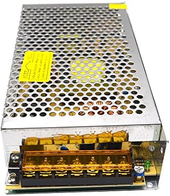

If you order a supply from one of the usual suspects get a spare or two; never know when another project will come along.
With a power cord and DC cable with the proper end you can use one of those perforated metal switching supplies, which will give you more options. They’ll have exposed connections so take the usual protections against contacting mains voltages.
Random example:
> **[Amazon.com: Padarsey 110/220V to DC12V 10A 120W Switch Power Supply Driver Power Transformer for CCTV Camera Security System LED Strip Light(12V 10A): Home Audio & Theater](https://www.amazon.com/dp/B01JSC7E7M)**

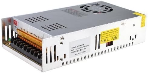

I have a 30amp version of the same power supply mooselake linked is that too much or does it matter. Still trying to piece together a build since the next order is a ways out.
> **[Amazon.com: eTopxizu 12v 30a Dc Universal Regulated Switching Power Supply 360w for CCTV, Radio, Computer Project : Computers & Accessories](https://www.amazon.com/gp/product/B00D7CWSCG/ref=oh_aui_search_detailpage?ie=UTF8&psc=1)**
**Post date:** [March 26, 2018, 3:36pm UTC](https://forums.maslowcnc.com/t/what-power-supply-for-arduino/2778/10 "2018-03-26T15:36:54Z")
That one should work fine. 👍🏻
**Author:** ![Zach\_Scott](https://yyz1.discourse-cdn.com/flex031/user_avatar/forums.maslowcnc.com/zach_scott/32/3914_2.png) [@Zach\_Scott](https://forums.maslowcnc.com/u/Zach_Scott)\
**Post date:** [March 26, 2018, 3:37pm UTC](https://forums.maslowcnc.com/t/what-power-supply-for-arduino/2778/11 "2018-03-26T15:37:27Z")
awesome thanks for the quick response.
