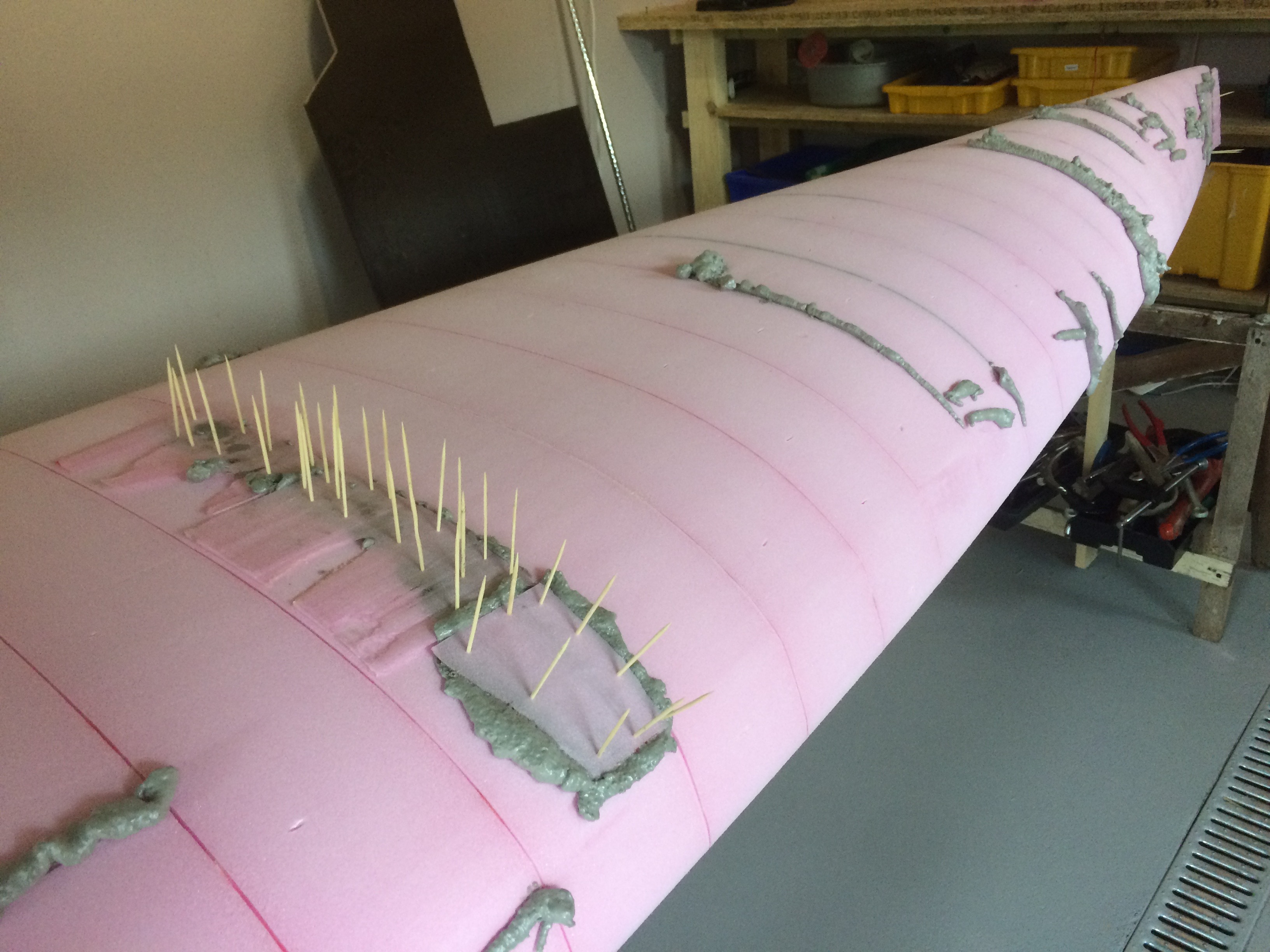

Using hull profiles as patterns, styrofoam and home made hot wire cutter, I’ve cut slices of my hull;
 ![IMG_6009](https://canada1.discourse-cdn.com/flex031/uploads/maslowcnc/original/2X/e/eceb01bd4aa625e6ce2f64130ee148be1c92cb35.jpeg)
and glue them together;
 ![IMG_6047](https://canada1.discourse-cdn.com/flex031/uploads/maslowcnc/original/2X/a/a48d71bdccc0fdd81d6449af5c928b3d3effa871.jpeg)

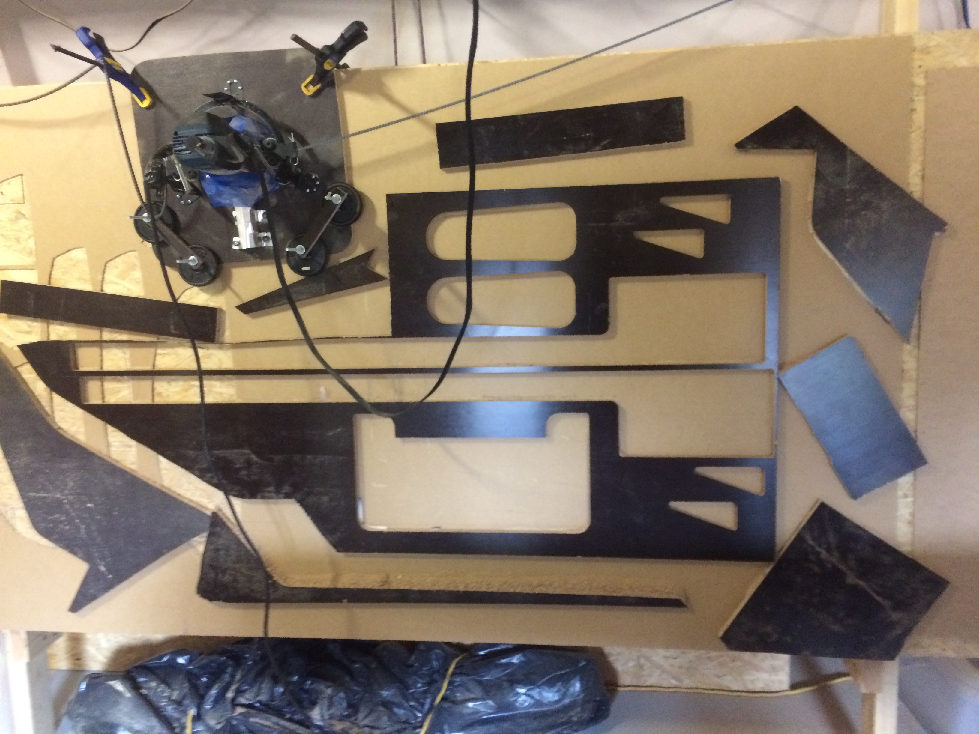

Now it is time for Maslow to shine - cutting outrigger. (I used up every piece of my marine grade plywood - hence this funny mosaic on Maslow ;-))
 ![IMG_6081](https://canada1.discourse-cdn.com/flex031/uploads/maslowcnc/original/2X/5/589b4281cb92a80f96bff04d0edf4f0e81b0bd9b.jpeg)
It turned up pretty good.
 ![IMG_6104](https://canada1.discourse-cdn.com/flex031/uploads/maslowcnc/original/2X/a/a24cb3d41acdb806aeab3de75e90b7a573d90697.jpeg)

Now back to hull - endless fairing, sanding, fairing sanding…
 ![IMG_6065](https://canada1.discourse-cdn.com/flex031/uploads/maslowcnc/original/2X/2/27573d3f2a142c104e0d12346d942214ddf4076c.jpeg)
and fibreglassing (with little help from my friend…)
 ![IMG_6143](https://canada1.discourse-cdn.com/flex031/uploads/maslowcnc/original/2X/1/122bb355d5bb1113a34e04229cfc465efdfdadd2.jpeg)
and fairing, and sanding…and painting… and sanding… and…

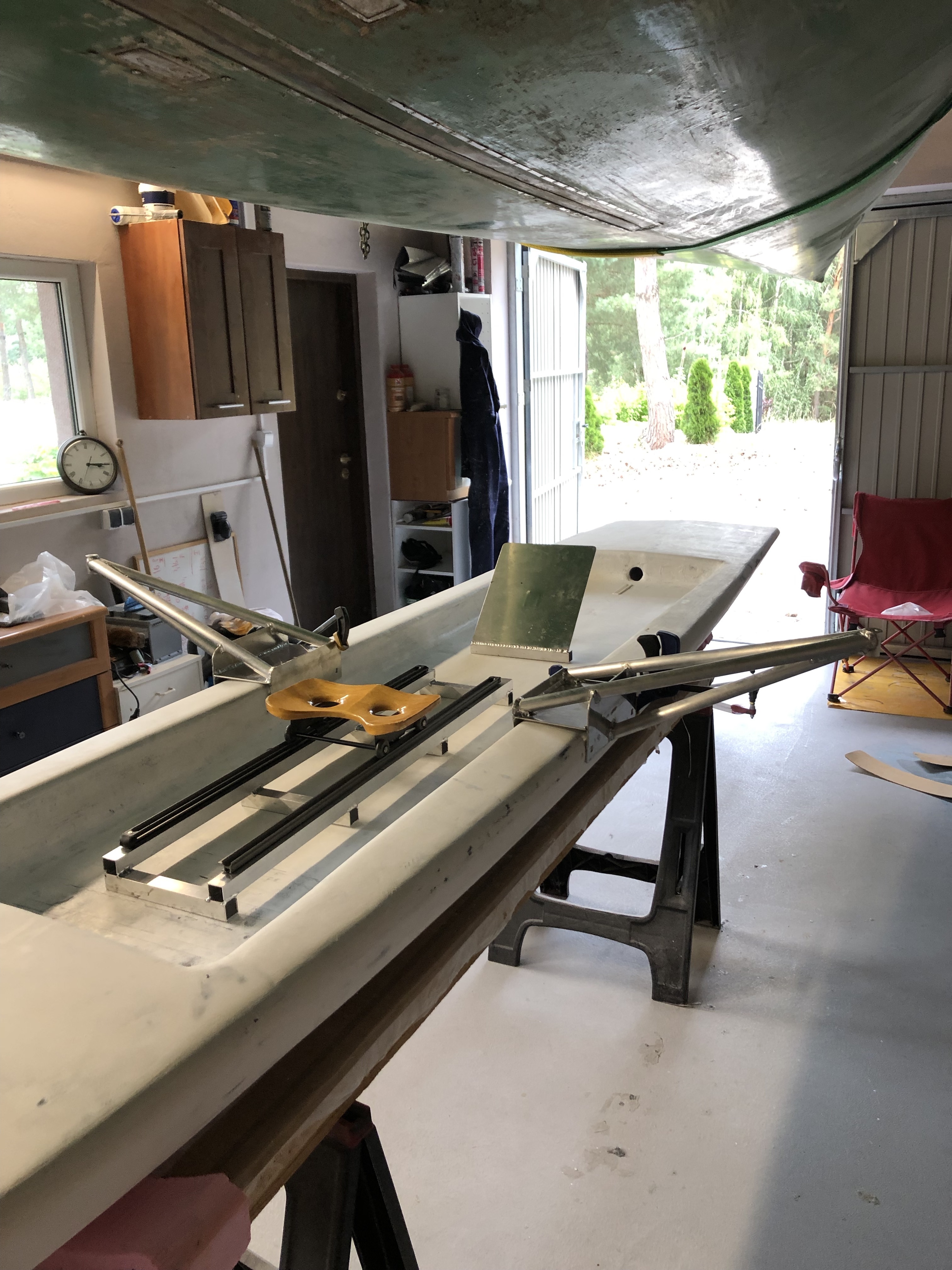

4. Fittings: you’ve nailed problem 😉 good question! I thought that drilling a hole, pouring thicken with micro bubbles epoxy and sinking bolts will suffice. Men I was wrong! I ended up with reinforcing screws with SEVERAL layers of heavy cloth - specially foot stretcher which exerts both pulling and pushing forces. Bolting riggers through gunwale is good idea but still I laminated through an aluminum tubes for reinforcement. Under slider there are no big side or up forces as your weight is always down but under stretcher definitively you need reinforcement. Hardwood laminated between layers of cloth will be sufficient but watch potential rot problem in future. Riveting works for bungee cords hooks for holding camping gear but not for carrying handles which I put on the transom and bow - those needs reinforcement as well.
5. Riggers: At first I wanted to buy it too but it is custom boat build to my hight, arms length, tights length etc. Additionally I wanted her to be easy de-riged for transport. It takes me 30min to put her on the roof, drive to lake, rig her and enjoy rowing. So I designed identical port and starboard outrigger and build a wooden pattern/holder as on the pictures below.
 ![IMG_0128](https://canada1.discourse-cdn.com/flex031/uploads/maslowcnc/original/2X/3/3f840821237a96312229cbbf3a79d06cbe2d8a67.jpeg)
 ![IMG_0129](https://canada1.discourse-cdn.com/flex031/uploads/maslowcnc/original/2X/e/e3332f3df76bb87b8564b417d80f64fcbeeefc4a.jpeg)
Then I cut pieces and fitted to each other, as my holder kept structure as designed - a lot of elbow grease but with quality files (flat, round and semi round), custom made vice to hold pipes you can do it - clock-master precision is not required as small gaps will be filled during welding.
 ![IMG_0130](https://canada1.discourse-cdn.com/flex031/uploads/maslowcnc/original/2X/6/6a22a426034346c9b12bef9696b7dea9b44657d3.jpeg)
And here is the most difficult part - find a friendly welder with TIG welding machine for aluminum - my parts are 2mm thick so it is quite delicate job. Fortunately I found THE guy - I took holder and all parts to his shop, we figured out order of welding and piece by piece we put it together. As port and starboard rig are the same we used the same holder. Wood of the holder burnt a little but after several hours and $50 I had everything: rig, stretcher and slider.
 ![IMG_0132](https://canada1.discourse-cdn.com/flex031/uploads/maslowcnc/original/2X/5/50d90f08b006a8ce971ed64f5a1441c85ca6e709.jpeg)
I prepared her with two coats of epoxy primer following with filling low spots and light sanding, and then finished with two coat of two parts polyurethane.
 ![IMG_0148](https://canada1.discourse-cdn.com/flex031/uploads/maslowcnc/original/2X/b/b94fd3bb3c2a219f3d2c11527cae9c8051d6d2d8.jpeg)
I had to add about 3 inches of heavy padding on top of the seat to move my butt up as shoes are a little too high - other option would be to dig my feet down into flor which will require redesign stretcher and a little fibreglass job, well next season 😉
Shoes are typical, from the shelf shoes for … road cyclist ;-o Its waterproof, have two screws at the sole and velcro straps. Rowers supplier wanted from me 180 EURO! Identical one for cyclist in the shop like Sport Check, cost 60 Euros!!! No brainer…
Sculls are Concept 2’s Bentam Compact with medium stiffness Ultralight carbon fiber shaft - it is fantastic for my recreational rowing and I easily maintain avg speed 8.5km/hr on 10km (4.5kn) and I do 500m in calm conditions at 9.6km/hr (5.2kn)
Not bad and I think that she looks pretty 😉
 ![IMG_0154](https://canada1.discourse-cdn.com/flex031/uploads/maslowcnc/original/2X/b/bb6adefe904566530356a51a60ce3e31884b1b1a.jpeg)
Please let me know how is your project progressing and I hope that my explanations helps
Cheers
Tomasz
