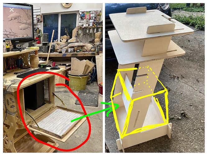

Gary - Thank you for these files!
I imported them into Fusion and am trying to scale it up to fit my computer case in the bottom, but I can’t figure out how to scale the X and Y dimensions without messing up the slots (that are currently sized for 1/2” plywood). Any suggestions?
My other goal is to enclose the area around computer case so I can use a typical home air filter on one side to keep dust away from the PC (an idea inspired by this design: [https://www.etsy.com/listing/1142694586/cnc-rolling-workstation-for-desk-top-pc](https://www.etsy.com/listing/1142694586/cnc-rolling-workstation-for-desk-top-pc) ).
This image illustrates what I’m ultimately trying to do, but scaling it up without messing up the slots is part of it. Any ideas welcome and appreciated. Thanks!

Seth,
Well, the only thing I would try is to draw a box or connecting poly lines around each existing part then scale the boxes without messing with the original part outline. Don’t draw the slots , just a rectangle enclosed object.
Then draw lines and enclose the slots on the original. Select one slot at a time and snap the ends to the redraw dimensions with changing original x,y position.
Remove the slot end to create the opening and radius as required.
Should work…. BTW I use Vectric Aspire and QCAD. For drawing cad files.
Gary

I’m going to draft it up in onshape so that it is parameterized.
I’ll probably have something later today.
