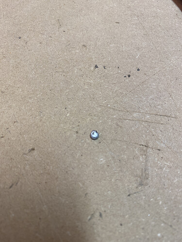

Thanks for the quick reply. I have the jumpstart kit. Bought it on Amazon. It came with x and y stickers but I guess it’s the right motor. But I’ve just noticed that upon opening the gearbox theres a tiny piece of metal in the gears. I pryed it out. Let me try again…
You can see it wedged in the gear that has the red top on it.
 ![image](https://canada1.discourse-cdn.com/flex031/uploads/maslowcnc/original/3X/c/e/ced7c973465ca54bdafa2e42f9256975fb4e383b.jpeg)
Here’s another of the metal chunk. It’s flat. [image|375x500](https://forums.maslowcnc.com/uploads/short-url/zhRoVCzJNw443SWZAWc7lb6UgcZ.jpeg)

Well maybe that caused damage or something. Still doesn’t work. Ive run the motor test several times. The connections are solid. The other motors work. If I plug into the left motor cable it still doesn’t work. There’s just a clicking sound.
**Author:** ![Lesroc](https://avatars.discourse-cdn.com/v4/letter/l/c37758/32.png) [@Lesroc](https://forums.maslowcnc.com/u/Lesroc)\
**Post date:** [February 22, 2021, 1:38am UTC](https://forums.maslowcnc.com/t/y-axis-motor-quit-working-abruptly/16164/5 "2021-02-22T01:38:38Z")
I got it! After having a meltdown( screaming and tears) I took an hour off and came back to look at the gearbox. The binding of that piece of metal caused the nylon gear to slip off that main brass shaft. The teeth were stuck end to end. Just pulled it up a bit and it slipped into place.

Great find in locating the jam!! Can you see where the chip came from? Is one of the gears missing a tooth now? I saw a post a while back that the nylon gears could be replaced with stronger metal ones, so I wonder if you can get a replacement part for one in there if it broke. It would be ideal if you could pinpoint where the metal came from. If not, you should inquire with Makermade if they are the company who sold you the kit on Amazon.
One of the causes of gearbox gear failure is an overweight sled or excessive tension on the chains. Users have reported sled weights from 20-35 lbs.

Haha. Thanks. I’m actually pretty proud of myself right now… I can’t identify where it came from at all. All the teeth are there and it working great. It almost looks like a cap of the top of one of the rods that holds the gears. It’s rounded on the top but has a sheared off look on the bottom. I don’t know…

That chunk looks like its leftover chaff from manufacturing. it doesn’t look like part of the gear train. Follow Orobs advice and inspect and clean all of your gears for damage.
Just to add that its a good idea to treat the drive motor hardware from any of the kit suppliers like you would treat a tool from Harbor Freight. Be prepared to have to do an inspection, cleaning and re-lube before you give it any serious use. Its not the kit suppliers fault, they are at the mercy of the manufacturer. They can’t nor shouldn’t be expected to open every motor before they ship it out. Besides, these motors have always struck me as being made so economically that they were designed to be a commodity item anyway. Given our application, its probably a good idea to do periodic inspections of the gearboxes anyway. You want to catch the potential failure of that main drive gear BEFORE it fails.
