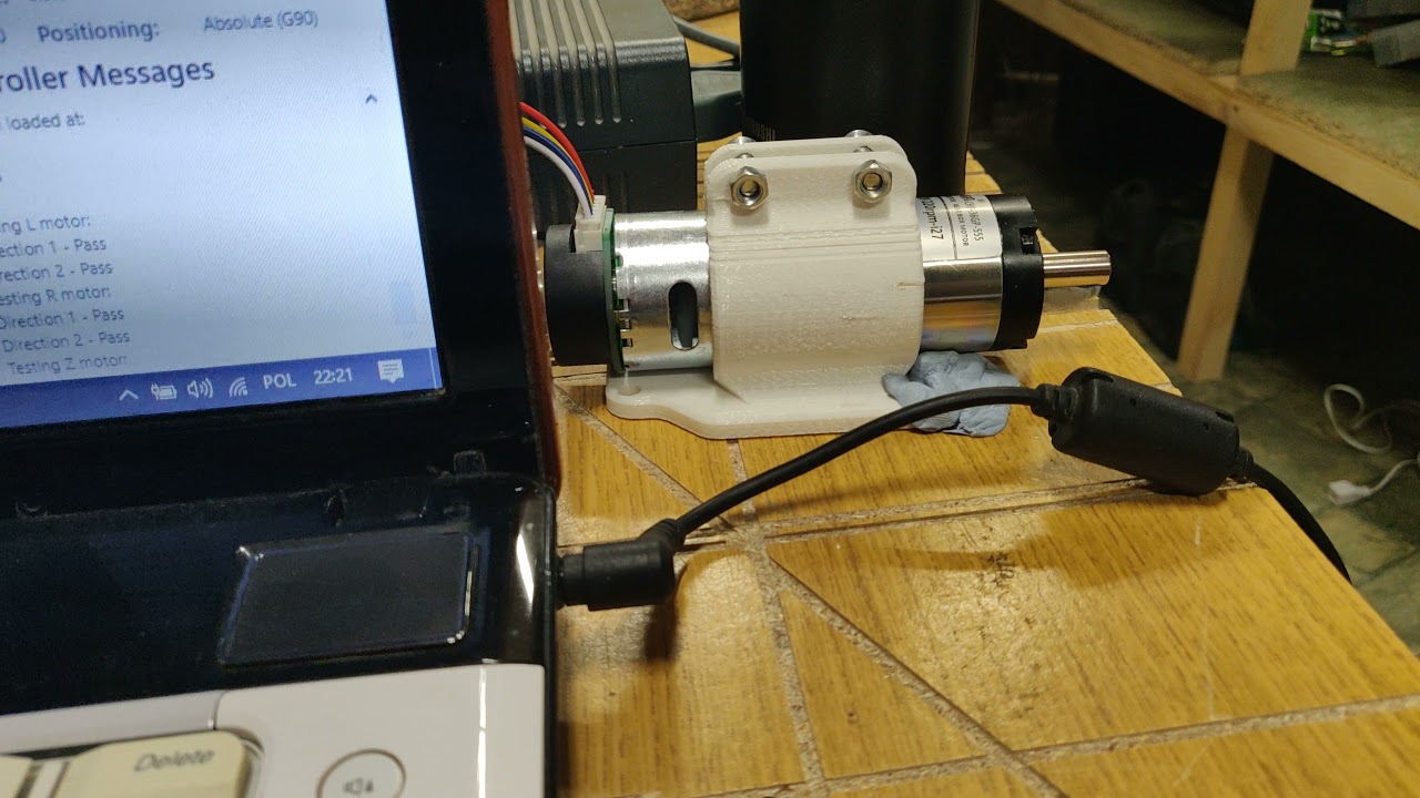

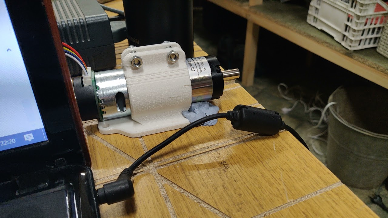

Hello. I have custom made z Axis with CHP-36GP-555-ABHLL motor which is 220rpm, 34 pole encoder that equals 1836 transitions per 1 rotation. And I have problem with setting pid for that motor. In code I found Zmaxrpm 12,6 and if I increase that value my motor is not spining faster. While in motor and encoder test motor is spining full throttle and is spining nice but while doing gcode motor is choppy. How to set faster feed rate for z-axis?

**Post date:** [April 3, 2021, 5:00pm UTC](https://forums.maslowcnc.com/t/z-axis-max-rpm-not-working/16391/2 "2021-04-03T17:00:27Z")
Thanks for the videos! Those are super helpful to communicate what is going on.
> [@powieff](#):
My first instinct is that that what we’re seeing is the feedrate being set in the gcode. If the gcode like is something like `G01 Z100 F200` then the motor will spin at the speed required to move the z-axis 200mm/minute regardless of how fast the motor can spin at max speed.
The jerky movement you are seeing is absolutely a PID control thing. Because this motor is so different from the stock motor you will need to tune the PID values. I would start by reducing the P and I terms.

Thanks for reply. I know that I can set in gcode but I believe z Axis is hard coded for Zmaxrpm 12,6 in source code, but when I enter value of 100, 200, 2000 it seems to have no effect. Also I tried tuning PID but also without succes values can be big as 200 for KP or small as 0,000000002 movement is choppy all the time. I tried to connect this motor as Left and used pid tuning tool but those values where also choppy. My last hope is to increase speed of that motor…

**Post date:** [April 7, 2021, 9:23pm UTC](https://forums.maslowcnc.com/t/z-axis-max-rpm-not-working/16391/16 "2021-04-07T21:23:22Z")
I’m not sure which firmware version you are using so I’m going to use mine as the example. They should all be pretty much the same.
What we’re trying to do is figure out how the speed is being limited.
Let’s print out what the feedrate read from the gcode is. To do that let’s add a print statement after line 778 in the file [GCode.cpp](https://github.com/MaslowCNC/Firmware/blob/master/cnc_ctrl_v1/GCode.cpp) so that it looks like
sys.feedrate = sys.inchesToMMConversion*extractGcodeValue(readString, 'F', sys.feedrate/sys.inchesToMMConversion);
Serial.println("Feedrate read from gcode: ");
Serial.println(sys.feedrate);
Then let’s print it out again after the feedrate is limited on line 793 in the same file. Something like:
sys.feedrate = constrain(sys.feedrate, 1, sysSettings.maxFeed); //constrain the maximum feedrate, 35ipm = 900 mmpm
Serial.println("Feedrate after global limiting:");
That will let us see if the feedrate is being limited globally.
Then finally let’s check to see if just the z-axis is being limited by adding a print statement after line 955 in the same file to see if it is being limited for just the z-axis. Something like:
sys.feedrate = constrain(sys.feedrate, 1, sysSettings.maxZRPM * abs(zAxis.getPitch()));
Serial.println("Feedrate for just z:");
That should give us some insight into where things are slowing down.
One more thought I had is that are you sure the pitch of your z-axis is right? If it thinks there is a super coarse threaded rod in there it will move more slowly because the number of rotations to move one mm is less. Probably a long shot, but I thought I would put that out there.
**Author:** ![powieff](https://avatars.discourse-cdn.com/v4/letter/p/a183cd/32.png) [@powieff](https://forums.maslowcnc.com/u/powieff)\
**Post date:** [April 9, 2021, 5:54pm UTC](https://forums.maslowcnc.com/t/z-axis-max-rpm-not-working/16391/17 "2021-04-09T17:54:59Z")
So I am sure that pitch is 8mm, and I entered those print lines but, last println just for z is in other line not 955 cause my whole gcode.cpp is 893 lines long. I am using 1.26 firmware . When I upload that new compiled firmware to Arduino should I make any steps in webcontrol?
