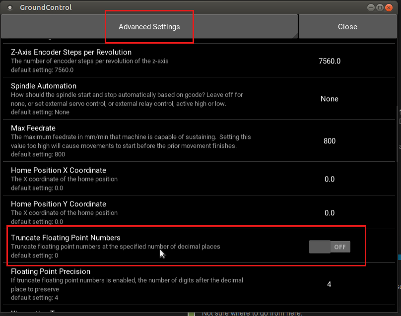

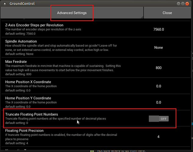

Edit: I see the makercam metric problem with the up to 16 digits and sent my sled in orbit with that in the past.
Would you try if changing a other setting helps?
-\> In GC click on settings and then on the grey bar with title ‘Maslow settings’.
You should see an options for ‘Advanced’
If that’s clicked, there is a button to cut off those numbers, -\>truncation.
 ![image](https://canada1.discourse-cdn.com/flex031/uploads/maslowcnc/original/2X/b/bfda0c85b89f483a18d9c1ddf7e6cf73a5547786.png)
Can you turn that on and see if it help?

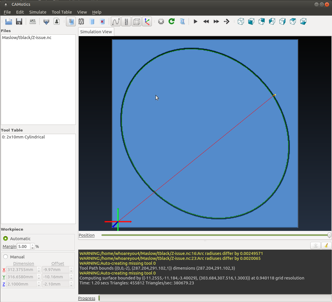

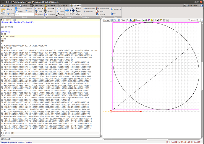

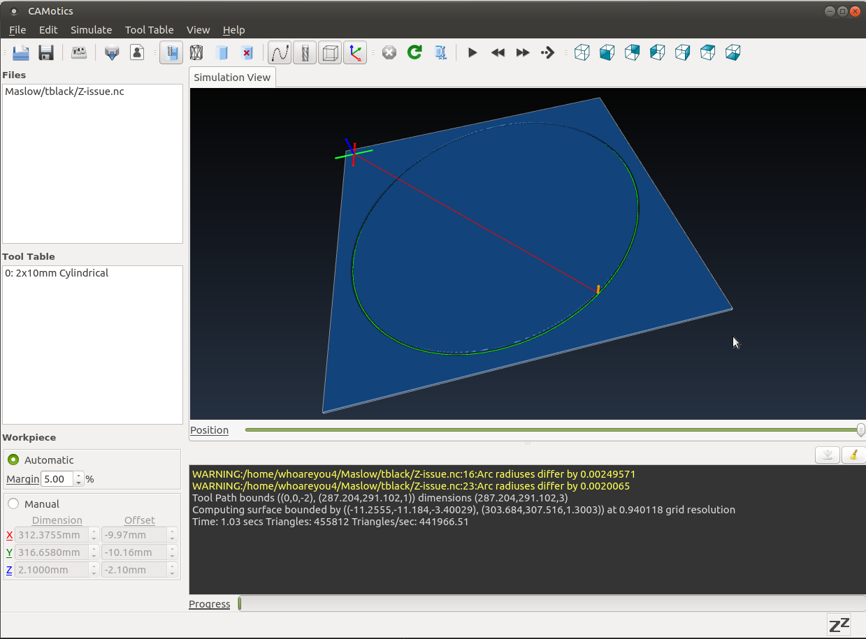

**Post date:** [December 27, 2018, 7:41pm UTC](https://forums.maslowcnc.com/t/z-axis-motor-problem/8246/16 "2018-12-27T19:41:19Z")
![image](https://canada1.discourse-cdn.com/flex031/uploads/maslowcnc/original/2X/c/cf194a7eb7f51d0cacbd7a8fcb8e3ef2262efd3d.png)
Checking wit CAMotics there are also issues with arcs. (kind of confirming the digit issue)
With what was the .svg for makercam created?
**Author:** ![Martins\_Berzinskis](https://avatars.discourse-cdn.com/v4/letter/m/5daacb/32.png) [@Martins\_Berzinskis](https://forums.maslowcnc.com/u/Martins_Berzinskis)\
**Post date:** [December 27, 2018, 7:53pm UTC](https://forums.maslowcnc.com/t/z-axis-motor-problem/8246/17 "2018-12-27T19:53:53Z")
Svg’s are made from exported dxf in solidwork, then online converted to svg
**Post date:** [December 27, 2018, 7:59pm UTC](https://forums.maslowcnc.com/t/z-axis-motor-problem/8246/18 "2018-12-27T19:59:09Z")
Is a sidewards ‘egg’ what you want to cut?
CAMotics and bCNC show this:
 ![image](https://canada1.discourse-cdn.com/flex031/uploads/maslowcnc/original/2X/1/1ef1860fcb6f2008828a5b9d9fb48c7085b70c05.png)
 ![image](https://canada1.discourse-cdn.com/flex031/uploads/maslowcnc/original/2X/0/0a93f39ed0c024f142bcd42eb0759c515a55be2c.png)
