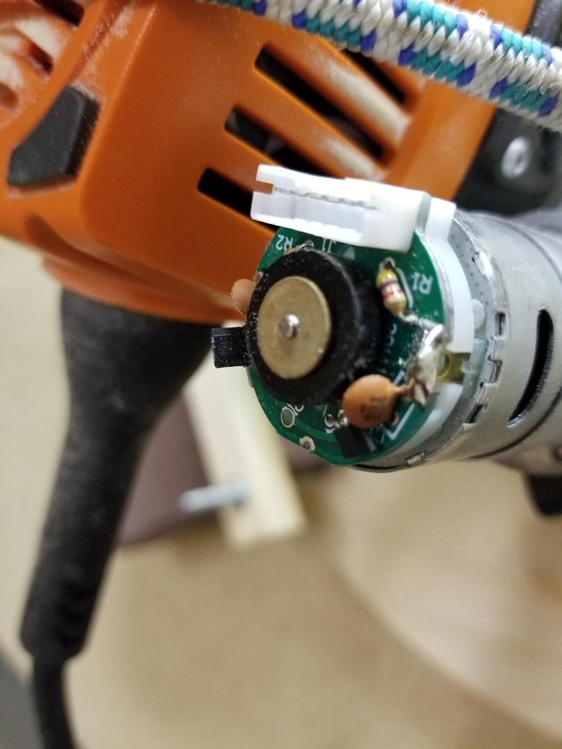

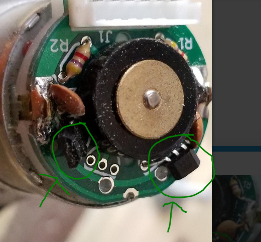

**Author:** ![VoigtRob](https://avatars.discourse-cdn.com/v4/letter/v/ed655f/32.png) [@VoigtRob](https://forums.maslowcnc.com/u/VoigtRob)\
**Post date:** [October 10, 2019, 2:41am UTC](https://forums.maslowcnc.com/t/z-axis-moves-whenever-router-sled-moves/11285/15 "2019-10-10T02:41:10Z")
Per the suggestion, attached are snapshots of the end of my z-axis motor (after disconnecting cable). As I mentioned before, it doesn’t have an end cap. Since it didn’t originally come with an end cap, I never realized it was missing. The close up picture certainly makes it look dustier than it does to naked eye, it looks pretty clean until you zoom in for the picture. If anything appears broken from pictures I can give it a shot at fixing. I’m reasonably good with solder iron and precision soldering.
 ![image](https://canada1.discourse-cdn.com/flex031/uploads/maslowcnc/original/2X/1/1fb60fa070cb0e07de2f6b376db24cf6c96ef930.jpeg)
 ![image](https://canada1.discourse-cdn.com/flex031/uploads/maslowcnc/original/2X/6/6045ec108719172061f3c1c32a0e7a98aa2c06fa.jpeg)
 ![image](https://canada1.discourse-cdn.com/flex031/uploads/maslowcnc/original/2X/4/4d7d5a44524778f99fbab3d45e75bd9c9caccf19.jpeg)
**Post date:** [October 10, 2019, 9:40am UTC](https://forums.maslowcnc.com/t/z-axis-moves-whenever-router-sled-moves/11285/16 "2019-10-10T09:40:55Z")
Oh fantastic! I think we can be pretty sure its the z-axis motor at this point then 😀
I would contact them about getting a replacement, the black cap which protects the electronics will go a long way to preserving the life of your motor.
The good news is that we might be able to get you up and running without even doing any soldering. Dust should be OK because the sensors use magnetic fields which can pass right through the dust. To me it looks like the issue is that the hall effect sensors which measure the magnetic fields have been bent away from the magnet. That’s these here:
![image](https://canada1.discourse-cdn.com/flex031/uploads/maslowcnc/original/2X/8/889f27998f5bd1bb724ba4aee2e0015e3b6172e5.jpeg)
If you can carefully bend those back up without breaking them off I think you might be good to go.
![image](https://canada1.discourse-cdn.com/flex031/uploads/maslowcnc/original/2X/b/b99b6a251bdc68ff51b09f8040973e90b47632a3.jpeg)
They should be close to the edge of the black disk without actually touching it. Post more pictures if you have any trouble!
**Post date:** [October 15, 2019, 2:30pm UTC](https://forums.maslowcnc.com/t/z-axis-moves-whenever-router-sled-moves/11285/17 "2019-10-15T14:30:26Z")
Bar -
Congratulations and thanks! It appears you may have found the issue, since it now “passes” the z-axis encoder test. I made progress on getting z-axis working last night based on your last recommendation. I was able to bend back the sensors, which was a bit challenging since one of the sensors was both bent and “twisted”.
One of the sensors (on the left in the marked up photos) appears to have a longer “cap” that extends down and leaves very little of the connection (mounting) wires exposed. However, the other sensor (on the right) has roughly 3/8" of the connection (mounting) wire exposed. That sensor was sufficiently bent that two of the three wires were actually touching. Not sure how that impacted motor behavior, but it may have contributed to original problem that started the troubleshooting thread (z-axis raised whenever sled moved).
I can’t actually raise/lower the router since my orange lock tab was shredded by the runaway z motor. The bottom line is it now passes z-axis encoding test, z-axis raise/lower each seem to rotate the motor as expected, and testing sled motion does not engage z-axis motor. I have to re-calibrate again (for what feels like the zillionth time), since my cable/controller swaps during diagnoses messed up calibration. Hopefully it will complete the “bow tie” test cut during calibration without chewing up another orange lock tab - I only bought 5 spares and I’m down to last one.
