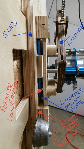

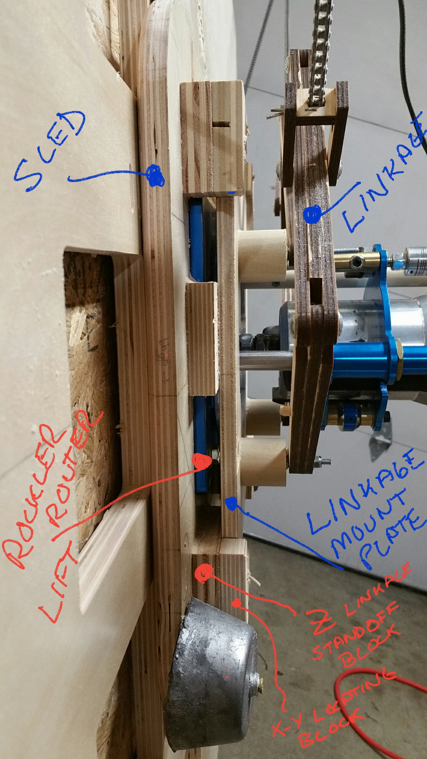

**Author:** ![1845greyhounds](https://avatars.discourse-cdn.com/v4/letter/1/34f0e0/32.png) [@1845greyhounds](https://forums.maslowcnc.com/u/1845greyhounds)\
**Post date:** [August 6, 2018, 3:10am UTC](https://forums.maslowcnc.com/t/z-axis-upgrade-is-almost-ready-for-prime-time/1649/60 "2018-08-06T03:10:03Z")
Yes, the $220 version.
The setup requires use of the wood parallelogram linkages (it’s too big for the ring kit), and the z-axis is 1/2 again slower than the Rigid R22002 (16 vs 8 pitch lead screw threads), but it’s super accurate, durable, and all things relative, easy to setup.
Here are some pictures of my sled. Note that the linkages are mounted to a standoff plate that sits above the router lift plate. It was easier and more accurate to mount the router lift to the non-work side of the sled than pocket it into the sled’s work face. I’ll create a new thread specific to the Rockler Router Lift with the build details.
 ![20180805_230802](https://canada1.discourse-cdn.com/flex031/uploads/maslowcnc/original/2X/a/a978fbfffbc3b839d9bf4b9333758a74102a07c2.jpg)
 ![20180805_224123-1](https://canada1.discourse-cdn.com/flex031/uploads/maslowcnc/original/2X/1/18a0e3d2b5d38212d85803d081f9ce738e9d700a.jpg)
**Post date:** [August 6, 2018, 3:13am UTC](https://forums.maslowcnc.com/t/z-axis-upgrade-is-almost-ready-for-prime-time/1649/61 "2018-08-06T03:13:53Z")
wow very nice. not sure if you saw the other thread, but people are using this faster motor to make the z axis move faster. sounds like it might help you out. [https://www.amazon.com/gp/product/B01MEGLCPL/ref=b2b\_gw\_d\_simh\_a1\_0\_p/130-4988803-4232509?ie=UTF8&pd\_rd\_i=B01MEGLCPL&pd\_rd\_r=1P547DGCQXSQNZJ0PXF3&pd\_rd\_w=QRk8R&pd\_rd\_wg=BjI8O&pf\_rd\_i=b2b-desktop&pf\_rd\_m=ATVPDKIKX0DER&pf\_rd\_r=1P547DGCQXSQNZJ0PXF3&pf\_rd\_t=ABGateway&refRID=1P547DGCQXSQNZJ0PXF3](https://www.amazon.com/gp/product/B01MEGLCPL/ref=b2b_gw_d_simh_a1_0_p/130-4988803-4232509?ie=UTF8&pd_rd_i=B01MEGLCPL&pd_rd_r=1P547DGCQXSQNZJ0PXF3&pd_rd_w=QRk8R&pd_rd_wg=BjI8O&pf_rd_i=b2b-desktop&pf_rd_m=ATVPDKIKX0DER&pf_rd_r=1P547DGCQXSQNZJ0PXF3&pf_rd_t=ABGateway&refRID=1P547DGCQXSQNZJ0PXF3)
