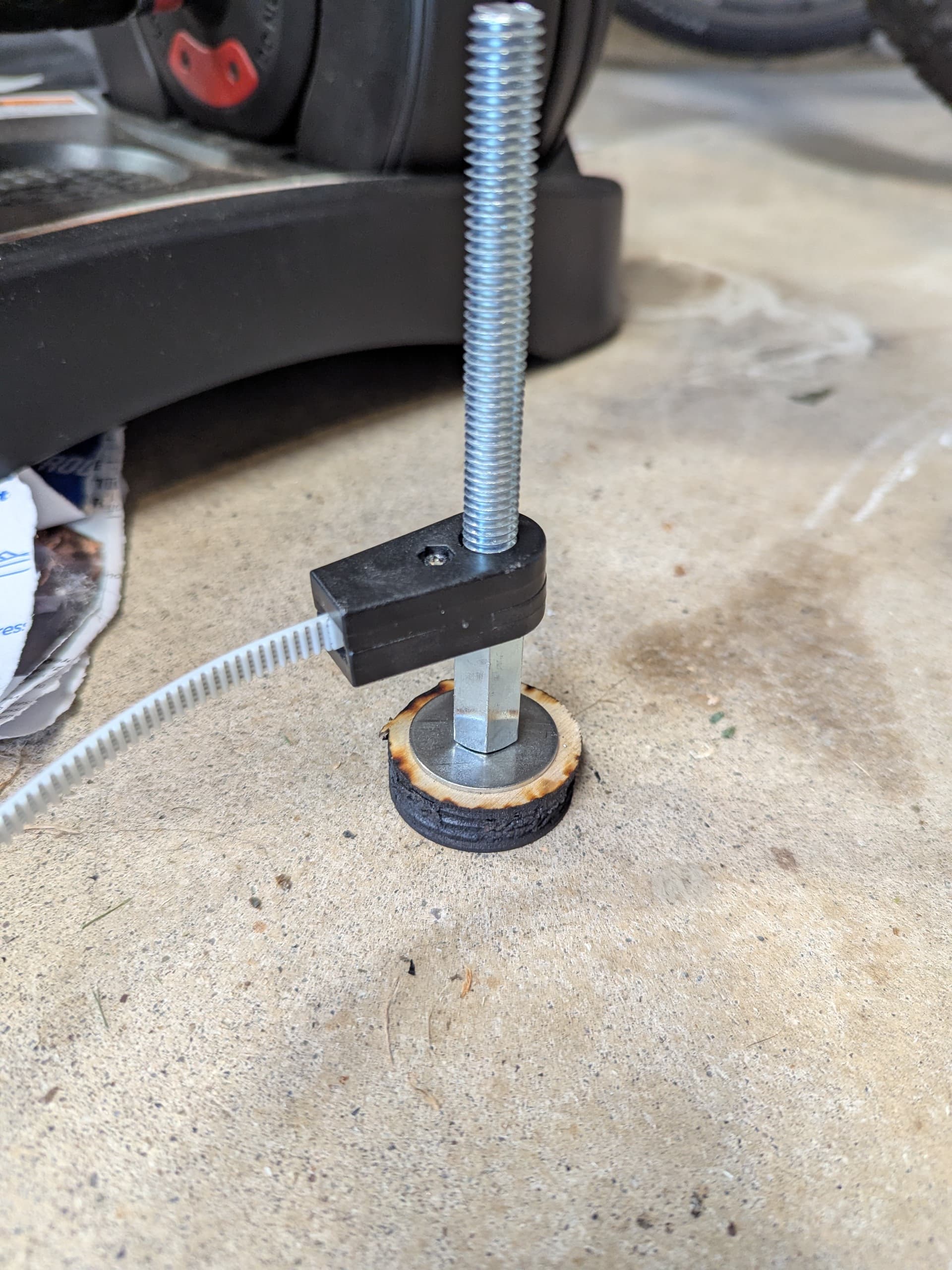

**Author:** ![Allen1](https://yyz1.discourse-cdn.com/flex031/user_avatar/forums.maslowcnc.com/allen1/32/22949_2.png) [@Allen1](https://forums.maslowcnc.com/u/Allen1)\
**Post date:** [June 14, 2025, 1:35pm UTC](https://forums.maslowcnc.com/t/z-offset-and-location-of-belt-loop-on-anchor/24362/11 "2025-06-14T13:35:08Z")
Thanks for the guidance David. I think this is what your describing? I thought they were pretty solid, but you’re right after tightening it down with the nut they feel very static.
 ![PXL_20250614_130927274](https://canada1.discourse-cdn.com/flex031/uploads/maslowcnc/original/3X/4/6/46bfb4c189e8970d59a2933b6ed4319c9161f93d.jpeg)
Top of the plywood is 29.6 mm above the concrete floor.
The wooden thick washer metal washer + standoff nut all measure up to 40.6 mm. The belt anchor is slid. On top of that. I’d like to try and keep them all at the same height as bar had suggested above (or at least start with that.)

**Post date:** [June 17, 2025, 9:01am UTC](https://forums.maslowcnc.com/t/z-offset-and-location-of-belt-loop-on-anchor/24362/12 "2025-06-17T09:01:01Z")
right idea, but I would use a normal or nylock nut rather than the extra long
one you use, staking more plywood disks (but gluing them together to avoid any
possibility of them shifting)
if you have the ability to do so, setup a camera/phone recording a video over
the top of the anchor (possibly with a ruler next to it so you can see how much
it moves) and then pull on the belt (you can pull pretty hard, I think the
maslow can aplly 60 pounds of force or something like that) and if you playback
the video at high speed, it will make the movement really obvious even without a
fuler to show how much it moves.
do this with the bolt by itself, the setup that you have now, and with a taller
stack of plywood and see how much each option moves with similar force.

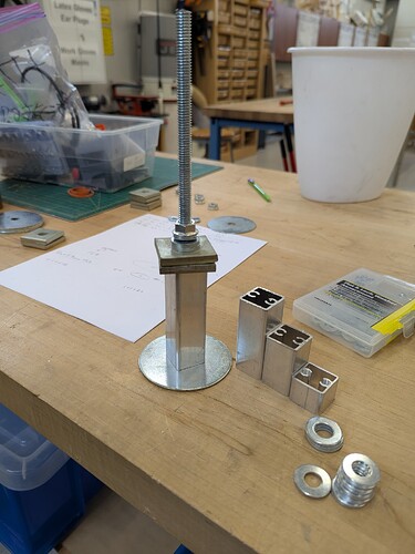

**Post date:** [June 17, 2025, 2:51pm UTC](https://forums.maslowcnc.com/t/z-offset-and-location-of-belt-loop-on-anchor/24362/13 "2025-06-17T14:51:49Z")
Ok! V2.
 ![PXL_20250617_144010150](https://canada1.discourse-cdn.com/flex031/uploads/maslowcnc/original/3X/5/6/561f6e30009c0df26969afbcb276290576ccdab3.jpeg)
I have large aluminum extrusion offset for each arm and enough steel washers / bolts to adjust in case I change my waste board/ cutting material thickness.
I couldn’t find nylon lock it’s but I did include a lock washer.
**Post date:** [June 17, 2025, 5:48pm UTC](https://forums.maslowcnc.com/t/z-offset-and-location-of-belt-loop-on-anchor/24362/14 "2025-06-17T17:48:47Z")
looks better, but still do the test with the camera, you can be surprised at how
such things can shift when they are just stacked (you may need to tack weld them
together up to the first washer on top, which is why I say that plywood disks
stacked should be glued together.
when the belts are close to flat, a difference in workpiece thickness has a much
smaller effect than the same difference when the belts are at steeper angles
