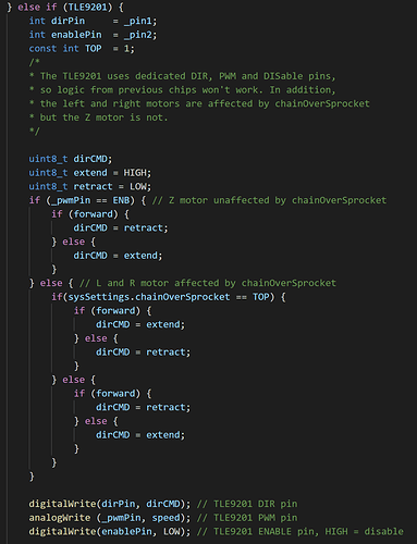

after some messing with it, the reset button works just fine. I accidentally hit the set home button, so once I reconnect the sled I’ll have to use webcontrol and reset the chains, but the calibration should still be valid.
I checked firmware assignments for motors 1, 2, and 3. All function the same with similar pin layouts. the difference is the gearing in the motors, not the communication.
pin assignments in system.cpp
 ![image](https://canada1.discourse-cdn.com/flex031/uploads/maslowcnc/original/3X/1/5/15586933206a77c7c5e073dcb441ab04dc38417e.png)
motor setup in motor.cpp
 ![image](https://canada1.discourse-cdn.com/flex031/uploads/maslowcnc/original/3X/d/a/dab62fbce1b2b8d9066f51417f61b7bf547a734d.png)
stopping motor movement in motor.cpp
 ![image](https://canada1.discourse-cdn.com/flex031/uploads/maslowcnc/original/3X/7/6/76d34289055be101c829e7ab754a06042cd29da7.png)
setting motion in motor.cpp
 ![image](https://canada1.discourse-cdn.com/flex031/uploads/maslowcnc/original/3X/a/3/a303919d70160d23b9791f64c8d6c8cc3c877ace.png)
my read of the tle9201GS datasheet says the disable pin (#11) is low for enable and high for disabled and for the z axis tlc chip (MP2) is connected to mega pin 8 as digital IO. PWM input to the tle is pin 12 and appears to be connected to mega pwm pin 9 as pwm analog output for the z axis movement speed. (maybe the motor speed is wrong?).
