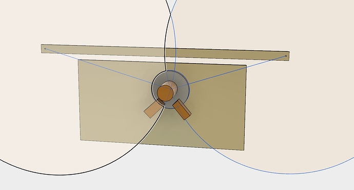

Using a radius centered at each sprocket with the 2 converging at the bit? Gets rid of triangular mathamatics in my mind but maybe I,m not thinking deep enough. Its simpler in my head at least. Am I being too simple? lol
I don’t understand how you would use this.
Don’t you still need to figure the distance between the sprockets and then
calculate the triangle to figure out where you are?
Distance between sprockets yes, but with that the radius’s (radii?) can only possibly converge at 2 points. The top point can always be ignored because it will always be off the work area. Therefore there is only one possible location the bit can be at using the radius method. Make sense or no? The way I see it it would avoid calculating any angles?

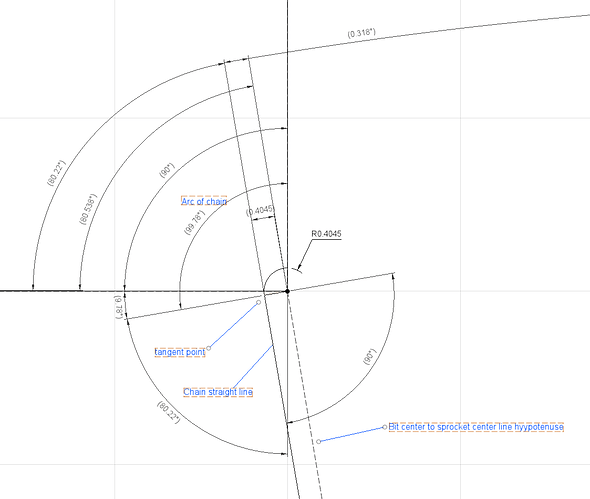

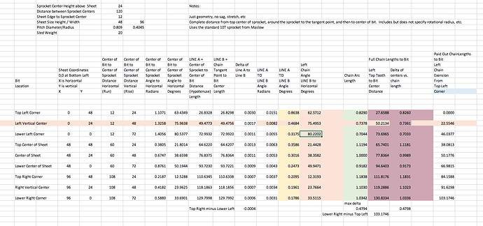

I will try to explain my understanding of the “geometric chain length”.
Knowing the “distance” from the “bit center” to the center of the “sprocket”, or intended distance, is the first part of the calculation. This is expressed as the horizontal distance (run) and the vertical distance (rise) in the attached spreadsheet.
This spreadsheet is set at 120" between sprocket centers, 24" above a 48" by 96" sheet, which is “centered”.
You can change these two values to whatever your machine is.
This spreadsheet calculates the 9 key points of corners, sheet edge centers, and center of sheet.
So for any of the 9 points the distance between centers is the hypotenuse of the rise and run, (columns F and G) and the angle to horizontal is the atan of those values (Columns H radians and I degrees). Column J is the distance from the center of the bit to the center of the sprocket (Line A)
Looking at the attached sketches, the hypotenuse is the long dotted line, and the angle is shown.
The sprocket has a pitch diameter of 0.809, radius of 0.4045 for the standard Maslow 10T sprocket.
We can calculate the length of the (line B) from knowing the hypotenuse, radius, and that the chain is tangent (90 degrees) to the sprocket . This is done in column K.
Just for the fun of it Column L is the difference in the lengths of those two distances. Not too much, but counts in the totals.
Next to calculate the angle between the Line A and line B using the asin, knowing the hypotenuse, radius of the sprocket is shown in Column M in radians, Column N in degrees.
Column O shows the angle in degrees of the tangent line B to horizontal.
Looking at the sketch this is the same angle value as the number of degrees of chain wrap around the sprocket below horizontal on the left side of the sprocket. Add to that value 90 degrees for the top left quadrant (always covered with chain) and take that summed value as a ratio to 360 degrees on the circumference and you get the length of chain wrapped around the sprocket from top dead center to the tangent departure point. This is Column Q. At the bottom of column Q I show the difference in max and min chain wrap, for this example -.4794". almost a half an inch. It counts as a significant calculation when the tolerances we are trying to achieve is so much less than that.
Next Column R sums the straight length and wrapped length to give the desired result, the geometric distance of the chain from top dead center to the center of the bit. (all inclusive of various parameters in the code, such as rotational radius, and whatever else is in there. I don’t know code.)
And again just for the fun of it, Column R is the difference between the center to center distance (Hypotenuse) and the derived value for chain distance.
Column U simply shows that if you say the top left corner is “0” inches of chain, how much more chain needs paid out to reach the other 8 points.
Hope this helps to understand the “distance” of the chain.
This does NOT include any of the values that the guys are trying to calculate for chain sag, chain stretch, etc. This is just geometry FYI.
PS. You can play around with varying the height and width dimension a little bit, and you can see the errors it would create if these were wrong. On a piece of plywood, where you are approximating the center to start, would not be a big deal, but when we put a grid on the sheet, and run all of those optical measurements, it really counts to be correct with the settings.
Maslow Chain Lengths Study 2.xlsx (17.1 KB)
Let me know if you see any errors.
