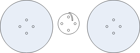

For 12 feet of 1/16-inch rope, which is a little more than you need for a 12-foot top beam, a 4-inch spool end (see below) seems to work well. My spool cylinder is a little over 1.5 inches in diameter so that I can use these for mounting it to the motors (MDF isn’t strong enough to directly mount to the motor’s shaft… I tried, didn’t work well):
If you go to 1/8-inch rope, you need ~5-inch spool. I use this website for the calculations:
http://www.giangrandi.ch/soft/spiral/spiral.shtml
For the bottom motors, I don’t think you have to go with 12-feet wide spacing since all its doing is orienting the sled vertical and assisting the pull into corners… For that, I’m planning on a 9-10 foot “bottom beam” and made some 3.75-inch spool.
I designed the spool cylinder such that the wrap around the cylinder stays “neat” in hopes of maybe one day being able to calculate how much is spooled out using only the motor’s encoders… but as I’m progressing through my testing, I’m finding it very challenging to maintain a perfectly neat wrap around the spool and think it’s unlikely to be reliable enough to depend on.
The center piece (spool cylinder) is 1/16-inch Delrin and the ends are 1/4-inch MDF. I started with 1/8-inch ends but they were too flexible and the force from the rope pushed them apart to allow the rope to slide past the previous layer resulting in some binding… Going to a 1/4-inch really helped… hopefully that will be all that’s needed.

I know exactly what you are asking. I’m trying to use the “roll of tape” method. As much as I’d like to do a constant diameter spool, I think the complexities of keeping the winding neat is too great (though I have some ideas, but not sure if they can be realistically implemented). To do something like above, I think you’ll need a level winder to achieve such a neat wrap and that makes a build much more difficult. As I alluded to in post above, the hope for the “roll of tape” method was to be able to calculate how much rope was spool out at any given time based upon the formulas used in that website I linked to. I just think at this point that’s too optimistic and am just focusing on using external encoders and wrapping cable up in the spool as neat as possible without overlaps/pinches/etc.

Well, I’m liking the idea more and more. Last night I spent a lot of time trying to get the end stops incorporated into the pillars to handle the “slack” condition and it’s getting really, really complicated. Sometimes you have to take a step back and re-evaluate.
My main goal is to avoid the need for custom fabricated parts where you have to pay a company to mass produce a quantity to get it affordable. Now, I’m thinking that as with laser cutting services, you can readily get parts 3D printed and even if they are expensive to produce as one-offs (or four-offs), 3D printed spools can probably eliminate $125-$150 in parts needed for using external encoders (encoders, laser-cut mounts, bolts, etc.) and it might just turn out cheaper…
I’m thinking of something like this:
I’ve got 1/4-inch D-Shafts (can’t seem to find 8mm shafts for whatever reason), couplers, and bearings so I have all the parts I need to make it once I get spools designed and printed.
The spools will be under an enormous amount of pressure from the rope… my monoprice mini delta can print PLA and ABS. Do you think that will be strong enough?

I was able to print a spool, but the scale is off a bit and the dshaft won’t fit … I’ve struggled with getting the scaling correct on this printer to accommodate PLA shrinkage. It seems challenging to get a specific outside diameter and a specific inside diameter to come out correctly. I’ll try some calibration cubes to see if I can get it to work better.
The design I was a 1.5 inch spool body with 0.085 in. diameter grooves to accommodate the 0.0625 in. rope (1/16th inch). I wrapped the rope by hand and it seems to wrap neatly, but I think @bar might be right about the risk of something going wrong with the wrap for some unforeseen reason. So, I think I’m going to try to make the grooves deeper (same diameter, just deeper into the spool body) such that the entire rope is “embedded” in the spool… roughly like this.
