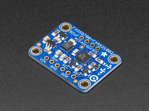

how about 0.01 degree? see: Auto-Calibration Mods?

that’s why I linked a much more accurate chip, (in the video).
no idea if the claims are true, but it sure sounds like something we could take a look at if we worked out a method of calibration.
