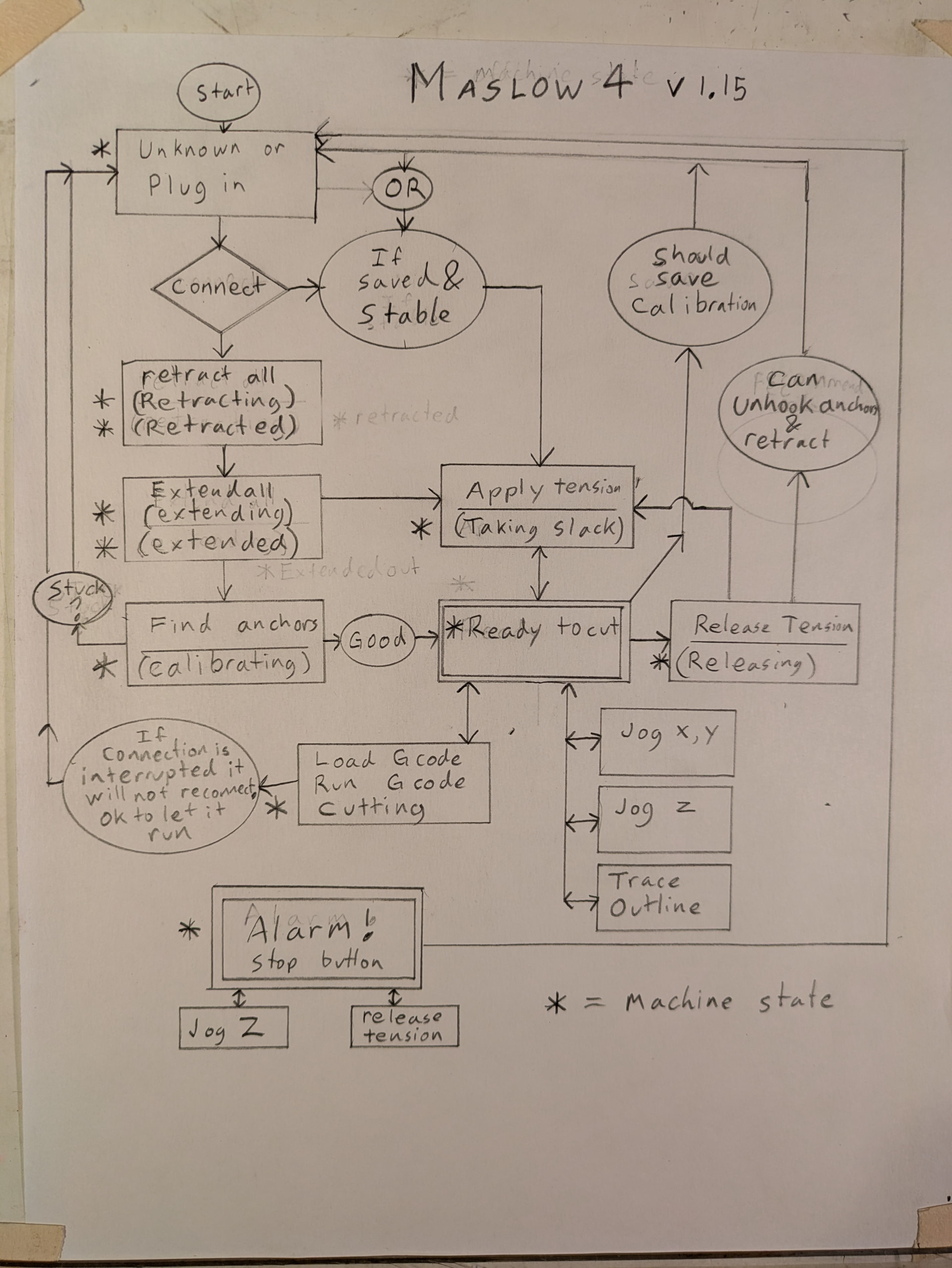

As we’re a state machine - do we anywhere have a state-transition diagram? Do we have tests derived from that?

Is there a checklist or state change flowchart or grid that we can sketch out for users to run through for testing their build before they start cutting the first time or when they change something even if it imperfect it might be good?
States to transition between:
Power on
Retracted
Extending
Extended
Calibration
Tension release
Tension on
Ready
Alarm
Jogging while alarm
Stopped?
Jogging XY
Jogging z
Cutting or running gcode
Trace outline
Reconnect
Restart
Hard restart
Test
first off, I know the original poster is not limiting things to these states,
but to start the conversation, I’m starting here.
Second, I will start with talking about the firmware, not the UI.
maslow internally has 11 states right now:
{ UNKNOWN, “Unknown” },
{ RETRACTING, “Retracting Belts” },
{ RETRACTED, “Belts Retracted” },
{ EXTENDING, “Extending Belts” },
{ EXTENDEDOUT, “Belts Extended” },
{ TAKING_SLACK, “Taking Slack” },
{ CALIBRATION_IN_PROGRESS, “Calibrating” },
{ READY_TO_CUT, “Ready To Cut” },
{ RELEASE_TENSION, “Releasing Tension” },
{ CALIBRATION_COMPUTING, “Calibration Computing” }
look in FluidNC/src/Maslow/Calibration.cpp for the
Calibration::requestStateChange() function to see the code that decides what the
rules are for changing from state to state and what each state does. and the
Calibration::home() function that is heavily overloaded to move belts based on
state.
many of these states are short term states for a particular action (retracting,
extending, taking slack, calibration in progress, calibration computing)
When you power on, it checks a bunch of stuff, including that the maslow.yaml is
sane. after basic initialization, it checks if there is a valid saved position.
If not, it goes into the “unknown” state and you have to retract to get it into
the retracted state, at which point you can extend (going to extending, then
belts extended) at which point you can either calibrate or take slack, either
one will get you to ‘ready to cut’
If there is a valid saved position, I think it goes into belts extended state so
you can apply tension (initially it went to ready-to-cut or retracted, but Bar
changed it to require apply tension and I haven’t looked to confirm exactly
which state it goes in)
when you hit ‘find anchors’, it goes into the calibration state, does some
stuff to find some data points, sends those data points to the browser and
switches to calibration computing. When the browser finishes the computation, it
sends the results back to the firmware and the state switches back to
calibration. This is a fairly ugly process where there is information kept from
one invocation of the calibration state and the next and when you enter the
calibration state, it has to look around and figure out what’s happened and what
it’s supposed to do next. There isn’t a ‘start calibration’ and ‘continue with
next poitns’ state, it’s just all under ‘calibration’
it’s in ready-to-cut that all the useful work is done. while you are ready to
cut, you can be idle, or not idle. when it transitions to idle, it checks if
it’s position matches what’s saved, and if not, saves it’s position. as it
transitions out of idle, it marks the saved position as invalid. More on what
can happen here later.
The alarm mode is a legacy from FluidNC, it’s the rough equivalent of the
unknown state (i.e. the machine doesn’t know where it is), but with a
traditional style machine you can just hit ‘home’ and the machine will find
where it is, but with a maslow you have to do the rehang dance. In alarm mode
you cannot jog x/y or execute a gcode program. We should probably change that
button on the maslow screen to represent the unknown status and bring up the
menu that lets you retract/extend/etc.
trace outline is a UI function, it looks at the loaded gcode, plans an outline,
and sends instructions to the firmware to move around that outline and back to
where it started. To the firmware, it’s just a series of jog commands

What does the computer call the state when it is cutting?
Does this look accurate? suggestions? I missed the home button.

I’d have to go over it with a fine tooth comb to be sure, but it looks pretty darn good to me!
I also asked the AI to come up with one from looking at the code to check against and here is what it came up with:
for the maslow code, it’s ‘ready to cut’, the idle/not idle flag is separate
Diagrams look similar Man vs machine! When would idle not idle be used?
take a look at http://blockdiag.com/ as a tool for doing flowcharts for online
use.
I see a number of things here
Z jogging is not limited to ready-to-cut or alarm state
it doesn’t wait until you connect to do a bunch of stuff (like checking for
saved state, connecting to wifi, auto-update)

There are really two separate state machines. The states like Alarm, Jog, and Idle are all FluidNC states.
The states like Retracted, Extended, etc are Maslow states.
