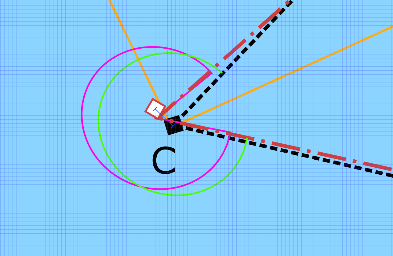

Maslow needs a datum or known point (x,y) (Bottom Left Corner of the sheet etc) then traverse to points A,B,C…H etc. see image one
At each node (A,B,C etc.) Maslow creates different internal/external angles and these can be measured using trigonometry because the lengths of each chain should be able to be derived from the encoder output. I also had the thought that if the velocity of the sled is constant throughout the time taken for the calibration the distance travelled might be able to be derived (aka distance = time * velocity).
I have drawn up a hypothetical path and how the maths of closed traverse work in image one.
The second image shows the variance in distance in blue and there is also a subtle difference in external/internal angle, also very useful for the later corrections.
Another idea would create a triangular control network between each of the nodes for comparison to the actual cut path.
I hope this helps flesh out the Bowditch idea.

You don’t need to know where A, B, C are physically on the sheet. using this method Maslow should only need to know that it is starting at the correct datum. I would imagine that the gcode file .nc should have all the nodes configured (preferably with a triangular control network - think Voronoi) with predetermined angles and distances inbuilt for reference. an optional z-axis operation might occur when it reaches the node if tangible testing is required?
I omitted this step in previous posts: at the end of the traverse, the sled returns to the datum (or what it thinks is the datum) and this is where the operator measures the error (or mis-closure) and applies the Bowditch corrections to the device settings. The method is repeated until the error is sufficiently reduced. I hope I am not confusing anyone too much the maths is sound (property boundaries depend on this technique) and the method should scalable to the unique circumstances of the Maslow.

Does this next image marry what you were trying to convey where there is a dynamic point on the sprocket where, depending on the angle the chain, has its zenith contact point?
this appears to be some type of dynamic ratio between motors - with an interesting symmetrical inverse on the other end.
hmmm.
the maslow is very repeatable, if you tell it to go to 1234,3424 it will go to the same point, no matter where else you have told it to go in the meantime (the motion is not relative to any fixed point), so going on any path and back to the same coordinates will now show any error between your start and finish points.
so your problem is how to know that it’s not where it is supposed to be at the various other points you stop at.
your diagram is close to right, just remember that the ‘start of the chain’ is the top center of the sprocket.
There is no symmetrical inverse at the other end, there is an unknown amount of extra length added to the chain (but the same amount added to both sides), some amount of ‘stretch’ to the chain that’s left the sprocket, and some amount of loss of distance on the calculated length because it’s a curve, not a straight line.
