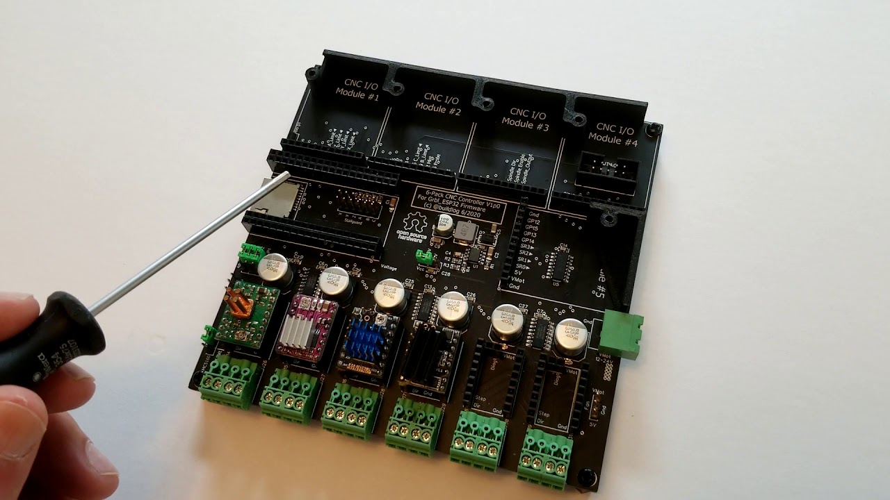

I’m nearing the end of installing Bart’s 3 driver board on my 2008 +/- Zenbot Mini, converting it from LinuxCNC and a Gecko G540. So far I’m very impressed with the board (although the magic smoke and flames left one DRV8825, seems to be common with these 5 for a tenner boards). The ZBm is a conventional Cartesian moving gantry router with a sub Maslow working area of 6x8 inches (150x200mm). I’ve cut a few projects and it’s working well, but let’s say the wiring is a less than competent bodge, speaker and telephone wiring that’s awaiting some new parts. I like to think I’ve learned something during it’s 10 years of hibernation but will keep the fire extinguisher handy.
Bart announced a new board yesterday, with replaceable plug in modules along with 6 stepsticks. At first glance it looks well suited for Maslow development although it would need stripping down for production. A video and blog post are up, tindie arrival “soon”. No price but looks more spendy than the current boards.

Check out Bart’s latest video when you get a chance, depending on the price that might become my goto CNC controller. He talks about DC motor (or maybe it was servo) modules, so making one for a Maslow may not be terribly difficult, might be worthwhile for a beta test board. If I actually get my Maslow going again (just ordered one of Metal Maslow’s sleds) before snowbird season you can consider me for the list. Right now my Maslow looks pretty forlorn and feeling abandoned after being ignored the last couple years while we were gone.
He mentions that it might be supported by future hardware, but I don’t think they are quite there yet. Maybe I can get the ball rolling :grin:
Here’s the video:
I maybe could have been clearer, sorry. I don’t think Bart has a Maslow driver (or DC motor with encoder) on his own project list, but the mention suggests that one could be developed by a Maslovian with the appropriate hardware design skills. While the video suggests that it would be a comparatively easy task they don’t say easy for who :slight_smile:
