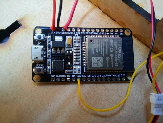

I will get you a photo this morning of the connection from ESP32 to the LEDs and ESP32 to the Arduino.
I had to take it to pieces to get the photos and in doing so I remembered something I’d put in the box that I’d forgotten about. I used a resistive divider to step down the TX line voltage from the Arduino (5V) to the levels that the ESP32 can handle (3.3V).
I’ve put additional pictures in the github repo but I’ll try to also post a couple of pictures here. The first one is the Arduino end. You can see I’ve wired resistors between the TX pin and GND then fed the signal wire to the ESP32 from the junction between the resistors. The signal goes into the RX2 pin on the ESP32.
The connections on the Arduino end are actually made on the top board which is the motor driver board, but the signal is coming from the Arduino underneath - that was just the easiest place to tap in. I also take a 12V DC (and ground) feed off from motor driver board to feed the 12V input on my LED boards.
The LED boards each have a 5V switchmode regulator on-board (their daisy-chain voltage down the ribbon cables is 12V). That way you don’t end up with dimmer boards further down the chain. I take a tap off the 5V regulator on the first digit and use that to feed 5V into the VIN pin on the ESP32 and I connect the GPIO13 pin of the ESP32 (display signal out) into the DIN pin on the first display.

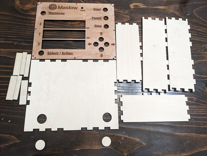

I was inspired by the z display idea and made a new controller box to house the raspberry pi and the mega along with some gpio inputs to the rpi and a BIG display for X-Y-Z when shuttling. I think when it runs, I will have elapsed time on X, gcode line number on Y and z will be z height… not coded yet, but I like the box so far.
Once I get the controller thing figured out in the other thread, I’ll complete this thing. the real reason is that my tab-placement skills have been lacking lately and the vacuum has been pulling out small chunks and wedging the sled causing it to lift and tilt and mess up the cut. if I had a pause button for when a piece broke loose without having to log into my phone again real quick and find the pause button, it could save some material and some time.
the x location will double as a menu selection and the select button when pressed will change the mode from x-y to z and then to zero or save home or reset home options… not sure the logic on how to set that up just yet, but that is the idea.
