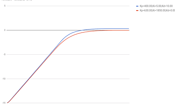

I spent some time last night playing around with the velocity PID values, and I thought I was making real progress.
Tonight I spent some more time, and the graphed results look much improved, the original PID settings are in red and one of my test runs is in blue. Each spike you see is a change in the set rpm. At the left it starts as 2RPM and moves up to 16RPM on the right, the vertical axis is the error off of the desired RPM:
Sadly, while the analysis would suggest an improvement. Real world usage seems to suggest that I have gone backward. The sled seems more jerky in its movement. I think the issue is that real slow end down there at 2RPM is not very consistent. I have messed with it a lot, and I don’t think I can get that lower end any better.
Any suggestions?
Am I going about this wrong? I figured since the velocity PID was later in the control sequence I should start there.
Am I passing judgement too soon? Should i get the velocity PID as close to good as possible in a test case and then start the process on the position PID? Maybe since the reactivity of the position controller output has changed it can no longer be relied upon to work properly?
Any suggestions would be appreciated. I have tried numerous techniques (increasing this, halving that, taking 10 percent of this) but at least in the testing environment, I seemed to do the best just working up in order P->I->D going back to make only slight tweaks along the way.

I think the two PID loops are going to be interacting in your tests, so rather
than leaving one alone and trying to get perfection on the other, I think you
are going to need to alternate the two, tweak one a bit to try and get a little
better, and then tweak the other.
I also expect that moving the sled alone vs moving it while cutting is going to
be quite different, especially with an aggressive cut (say a 1/2" bit cutting
all the way through 3/4 wood)

For the velocity controller, I am pretty confident that the non-linearity between output and measured value is a real issue. Bar’s graph from a while ago does a good job showing the non-linearity.
In order to get my blue lines above, I had to use a lot of KI, but that causes too much damping down at the low end where we need a lot more KP.
The two options I have seen to deal with something like this are Gain Scheduling and Linearizing the Output. I am leaning toward gain scheduling which basically entails having more than one set of PID values and breaking up the values into input ranges. I suspect that two buckets would improve our results significantly. Sadly this also increases the complexity.
OK, I got the new PID library safely integrated. I tried the PonM feature on the velocity PID and that was a mess.
But good news, I think I achieved a modicum of success with the Velocity controller tonight. I struggled for a long time trying to get a reasonable output at very low RPMs. I was noticing that at times the motor was actually briefly running in reverse at the start of a command to turn slowly.
In short, I discovered and removed the running average from the speed feedback. That made a huge difference. I suspect that was causing other issues as well. The PID controller seems more than capable of handling the quantization noise.
As a result, I think I achieved some good results without any gain scheduling or other sophisticated solutions. I am using KP = 40 and KI = 3 with KD = 0. Be cautious, these settings may not work well without disabling that averaging function.
I also learned that the analytical approach is a good starting point, but you have to throw it out the window to get good working numbers. There are just too many sacrifices to be made for all of the scenarios (moving up, moving down, high tension, low tension) at some point I had to make a subjective call as to what values seemed to work the best. I hear what sounds like Integrator windup starting, but I haven’t seen it max out yet, but I will keep my eye out for it. I also still see some chain vibrations when moving the sled at the top 9 inches of the work surface in the center. Hopefully, tweaking of the positional PID will solve this.
Finally, disabling the PID calculations if the motors are off also seems to have made a big difference. The integrator term was maxing out if the machine was just sitting there since it never stops exactly on the point it is supposed to be on.

Ok, I got back to it today.
I spent a large percentage of the day trying to “linearize” the voltage -> RPM relationship. I really thought it would help the velocity PID. Anyways, after many hours and a stupidly complicated looking function, I wasn’t able to discern any benefit and in fact it may have been worse. So I threw all that away. One other option I thought of was to have different PID settings for the positive and negative velocity controllers The voltages are obviously dramatically different for each direction.
I do think I learned that the accuracy of the velocity PID is less of an issue. I think its most important aspect is that it doesn’t oscillate at low RPMs. Oscillations at higher RPMs are much much less noticable. And the positional PID overcomes a lot of velocity errors.
So I finally moved on to the Position PID. I enabled the PonM feature. It operates completely different from a normal PID, you have to start with I then move on to P. Anyways, in order to make my pretty graphs, any honestly to even tune it (becuase the values are so different) I added a position testing function.
Below are a few of the graphs, the original PID is in blue my testing version is in red.
As you can see, the old design liked to settle on a point, but often times that point was over or under zero. The testing version never misses getting to zero and rarely if ever overshoots.
It seems to work very well in real life scenarios as well. But I still have a bit more testing to do. Irritatingly I did have an occurrence of integrator windup that happened similar to before when the zaxis was retracting. I am hopeful that dialing back the KI term in the velocity PID will solve it and not cause more issues.
I have continued to make progress and found a few other related changes that have really cut down on the jerkiness of the machine. The graphs continue to look good and a subjective test of a difficult cut in the middle at the very top of the work surface is noticeably less jerky.
I tried to test a real world situation by cutting an identical test pattern using the old and new tuning and comparing the sum of the reported positional error messages in the logs. However in total cumulative error the old system gets a 609 and the new one gets 1100. I think this is caused by the old system’s willingness to overshoot.
So I am digging into how we break up the segments to be cut. It seems like we calculated the loop cycle time as .0001575 min/loop or 9.45 milliseconds per loop. We break up the commands into segments of 9.45ms in length. So I have a few questions:
  1. It seems weird that our PID loop runs on 10ms intervals, but our movement requests are sent on 9.45ms intervals. Maybe these should be the same? At some point we are sending a positional request that gets overwritten before it gets acted on by the PID.
  2. How do systems like this normally work? If the machine could reach the requested position in the time requested, its movements would be very jerky. On the other hand, if the machine doesn’t reach the requested point in the allotted time, you get the error that I am seeing. I had been calibrating the machine for large movements at a time (2-22mm). But in reality at the maximum feed rate of 900mm/min the distance for each cycle of the loop would be .14175mm. So should I be calibrating things at distances 100 times small than I have been looking at?
I think my answer to question 2 is that I have damped the system too much. We need to accept some low level overshoot in order to decrease the rise time.
I think the idea is to get the rise time to be close to the 10ms threshold. Then the overshoot would generally only occur when stopping since a new position would be requested at the time that the overshoot would occur. Then, as others have suggested, we add in some acceleration profiles and we should be able to limit the overshoot when stopping too.
I do wonder if this means that PonM is the incorrect method for this then.
