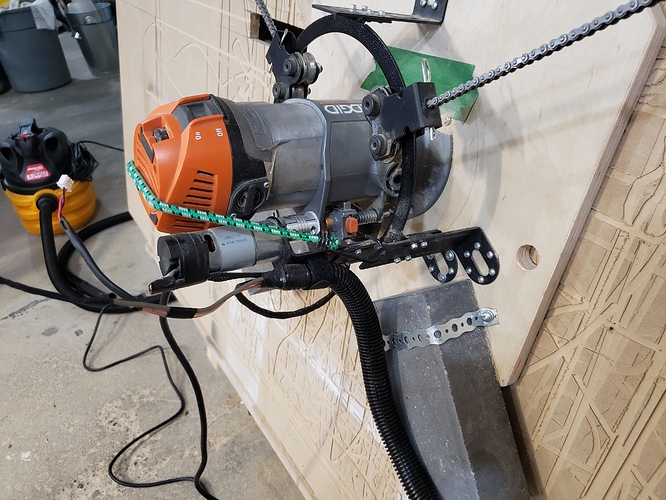

Couple pics of my setup:
2nd pic- rigid router mounted (pretty standard).
1st pic- laser mounted. I fastened laser inside 3" abs so I could use router base to hold it. Works great for switching between router and laser.
Close up of laser mounted in abs pipe. The blue rings are from 3" caps for abs, they worked for the pipe to fit router mount.

note that if your mount isn’t the same weight as the router it’s replacing, you
will have some additional inaccuracy in your system (unless you calibrate it
with the laser)
