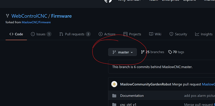

I am kinda stuck and confused anyway. I went to github.com/WebControlCNC and see the repositories. I see one for Web Control and another for Firmware. The Firmware repsitory shows that its a fork of MasalowCNC:master. It also shows that it is 6 commits behind MaslowCNC:master. Is this the repository that I need to fork?
fork that one if you want your updates in the holey branch.

you only fork the repository once. With that fork, you get all of the branches from that repository. you can select branch and the files will change to show / be that version. Make the changes to the one repo and then submit a pr to the master for webcontrol with the same changes and see if it will take it. This is where my inexperience begins to show because I think there is a way to submit the same changes to both repos or a way to merge the changes from the one repo to the other, but I don’t know how to quickly and easily get that done. There are others who know how on here that are probably laughing and the blind leading the blind. Hopefully our discussion will get corrected and others will find some value in the information that is correct.
I forgot to ask. If WebControlCNC:Firmware is the holey firmware, where is the triangular firmware?
the master branch of the webcontrolcnc/firmware repo is triangular.
The holey branch is the holey firmware.
they both reside in the webcontrolcnc/firmware repo as separate branches. When you clone the repo, you get them all and you have to select the correct one or make a new branch based off of one of them to start your changes and then you merge your changes back in with a pull request.
to answer your specific question, you would branch holey and add your changes and branch master and add your changes. however, since bar’s version is going in the maslowcnc/firmware repo, you could submit your changes as a PR to the webcontrolcnc/firmware master branch as well. I don’t know how many differences there are between them, but if only 4 commits, then the webcontrolcnc/firmware branch is pretty close and branching off of the maslowcnc/firmware repo that is ahead will bring the webcontrol repo up to date with your PR. I’d try it. We likely want them in sync anyway at least for triangular calibration.

Just so that I am clear on this. Your thought is that since the MaslowCNC master (Triangular) is only 4 commits ahead of the WebControl Firmware master (Triangular), I could submit a PR to the WebControl Firmware master to merge in the changes from the MaslowCNC master. This would bring the WC master in line with the MaslowCNC master. I could then PR the Holey branch to merge the changes from the WC master.
Am I close?
I think you got it… at least as far as I understand it. The only think I would add is that the webcontrol triangular version was at 1.28 and the maslow version was 1.26, so webcontrol had some improvements and there had not been movement with outstanding PR’s in the maslow version for a couple years, so the firmware “master” had defaulted to the webcontrol repo to work with webcontrol. If the maslow repo has merged the updates from the webcontrol repo, then it should be up to date. To me it does not matter which is the “master” as long as they are active and accepting and testing new additions and features in a reasonable timeframe.
