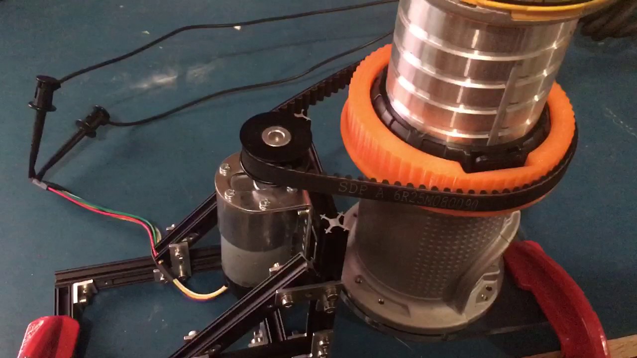

What I am thinking to meet these goals is a design which uses four kevlar (or some other low stretch material) cables instead if the chains and which has all of the electronics and motors mounted to the sled. Cables need to be used instead of chains because if the motors are on the sled we need to store the extra in a compact area. Also the chain has proved to be a hassle.
This type of design would simplify calibration by making it possible to calibrate with a single button press. By pulling each of the pairs of cables taught one after the other we could measure the distance between each of the four attachment points. This would give us enough information to fully calibrate. It would be nice to have current readings from the motors rather than stalling the motor as we do now.
This type of design would improve the accuracy in the extremities because in the lower corners we could provide the extra tensioning needed to pull the long cable tight and the sled would be lighter without the bricks allowing us to go higher between the motors.
This type of design could cut faster because we are currently limited by the force provided by the weight of the bricks and gravity. If we control all of the forces we can apply more force in the direction we need to cut.
This type of design would also be more productizable because all of the parts come attached to the sled and could be purchased as a built unit. The only external thing which would be needed would be four solid attachment points. This design would also work in fully vertical or horizontal modes.
The first big challenge to building this design would be how to accurately measure the length of the cables. Chain on a spocket moves a fixed distance per rotation while cable going onto a spool winds in more or less cable with each rotation depending on how the cable is stacking. This rules out our current method of using an encoder on the back side of the gearbox which is a significant loss.
To make up for that we would need a very high resolution encoder on the other side (8000+ steps/revolution) and we need a way to relate it’s rotations to the cable movements. I would like to explore using pinch rollers which roll as the cable moves in and out. We would need to verify that they won’t slip; ie if the cable moves in and out a lot of times a mark made on the roller and the cable will still line up.
If that looks ok we need to find a way to read the position of the roller. A larger roller will be less likely to slip and more reliable in general, but a larger roller would require a higher resolution encoder. I’ve played around with the magnetic AMS encoders and they aren’t linear enough for this type of work, the other ones I’ve seen are too expensive.
What I would like to test first is a system to use the sensor out of an optical mouse to read the movement of the roller. Optical mouse sensors are cheap and easily available and can have very high resolution. Unfortunately they have a problem with drifting over time. To solve that I would like to color code the roller with black and white striped to give us a concrete reference for position. Reading the black and white stripes gives us a low resolution position (~10 steps/inch) which won’t drift while the optical sensor gives a very high resolution position (~8000+ steps/inch) which drifts, but which can be corrected by the measurements from the stripes.

You don’t need a very big spool to spool up 9 feet of cable/rope on top of itself (it’s ~9 feet from one corner to the other). I was/am working on a design very similar to what you are talking about, but it had a spool that had a width equal to the cable/rope so that the cable/rope stacked on top of itself. I was going to use metal wire rope and assumed there would be no crush when it was wrapped. The spool would start at about 3-inch diameter and max at around 5 inches. I was trying to find a different geared motor to handle the larger diameter spool but also thought a simple chain drive arrangement of say 4:1 could work and the original motors could be reused. I’d plan to then use some math to figure out how much cable is fed out as the motor turns (I’m sure this part could be worked out). I was planning on fixing the location of the spools, but allowing them to swivel along the midpoint of the spool.
This was my idea for the spool. The funky looking inner part is designed so the 1/8-inch cable terminates up against that jog and then wraps ccw. It’s all theory though.

Do you have an idea on how the rope would ‘exit’ the sled? Would it be safe to say that when the cable exists the pinch rollers, its on its way to the attachment point? If so, do the pinch rollers ‘swivel’ at all?
Idea to solve the distance calculations.
Mount the thread spool on a threaded shaft so the thread is wrapped onto the spool as a spiral instead of overlapping. With that method a simple encoder on the spool shaft would be sufficient to calculate distance.
I think that the cable might need to pass through an opening after the pinch rollers so that we can retract the cable fully to a hard stop to establish a zero length point. I am imagining that the rollers themselves are fixed but because they are attached to a carriage which can swivel around the router the cable can move to always point to the router bit

A simple way to have four motors rotate freely around a round sled would be to simply have two linkage kits. One for top pair or motors and one for bottom pair of motors.
the actual motors and encloders can be mounted directly to the center of the linkage arms
And since all the linkage arms would be the same,it would be realtaively cheap to get them laser cut.
crude sketch showing basic dimensions
