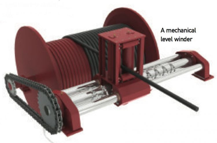

Level-Wind is a mechanism used to even and orderly lay a line onto a reel. Level winds distribute the line across the traverse a level winding on Depending on the use (measuring line with motor encoders), level winding is needed to achieve a consistent length of line being wound per revolution.

you can’t accurately calculate how much the line will pile up on itself, because
it does not stack evenly (and the stack will be different depending on how much
tension it was under as it was wound up), so measuring the line movement (pinch
rollers, or one loop around a roller, or optical) would be required.
