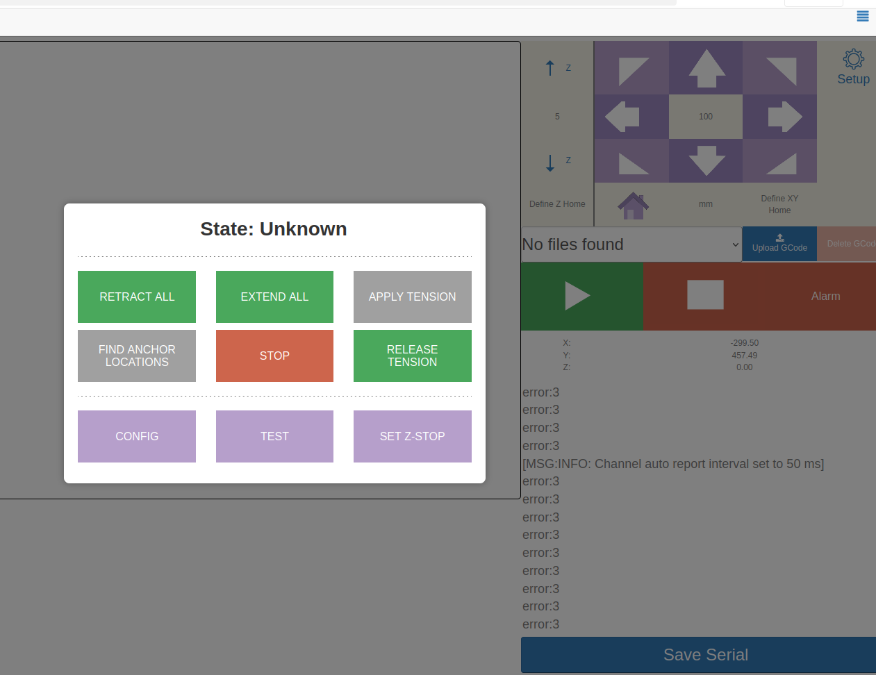

Ok, so when I lose connection and click the helpful “reconnect me” popup it wipes everything, must retract and extend before trying to calibrate again. The maslow isn’t saving states
Also I moved from my driveway to the back yard which is a straight line of sight 20 feet from our house router (newish and pretty good) To improve the signal but it is still glitching out. I can often see the maslow on the router list of devices with an IP address but it the computer still does not connect even when the router sees it.
Currently firefox on a linux ubuntu mint dell laptop.
Here is the log as it restarted
Maslow-serial(13).log (2.8 KB)
it did suggest that maslow? was corrupted this time which is new for me and that I should restart the machine.
Which version of firmware are you using? It looks like it has the wrong version of maslow.yaml file, Sometimes a power reset can fix that weird erroring. Try connecting directly to the via wifi instead of via your home network.
I think the error 3 in this case was a temporary thing. I am using 1.12 and uploaded index and yaml from the same batch.
Thank you for your help.
This sounds to me like it’s not actually a WiFi connection issue, but that the machine is restarting. Restarting will cause the WiFi connection to reset, but that is a symptom not the cause.
Are you seeing any error messages? How stable is the power connection?
Power seems very stable. It really seems to be a connection problem? Only the “reconnect me popup and then the serial stream seems to be wiped and start new.
Does it start back up in the alarm state?
error 3 means that it tried to read or write a parameter in the yaml file that
isnt there.
if it happens once with a new version, it could be that there is a new parameter
and it’s checking if it exists.
If it happens a lot, or repeatedly, it could be a corrupt yaml file.
I’ve sometimes seen problems like this that show up every other boot.
The esp board has two banks of flash (so you can update one without risking
breaking the system as you are running on. I’ve wondered if there is some
condition that only manages to write a maslow.yaml file to one of them, so each
boot you switch between them (which would be a smart recovery mechanism),
causing errors/parameters to go away when you boot and come back when you boot
again. ???
