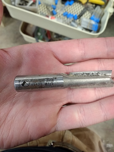

The cabinet shop that we share space with uses these:
I’ve played around with a couple and they seem to work well
They have this funky and difficult to photograph tip which makes them “center cutting” meaning they can be plunged straight down into the wood. Some of the bits which look like that don’t have that feature and need to be ramped down into the wood which wouldn’t work for drilling
That’s what I was wondering about, whether you can use straight plunge bits. To experiment, I had bought some 1/8-inch straight plunge bit to see how fine of a detail I could cut. I was planning on taking it slow with them this weekend (small depth adjustments at low speed) so as to minimize the risk of breaking the bit.
I ended up ordering this for the 1/2-inch bit to try out (of course, someone will now tell me that it won’t work).
Those are 2&7/8-inch long. You had no problems with using them with the R22002 and the zaxis kit?
Yep, no issues with those :slight_smile:
