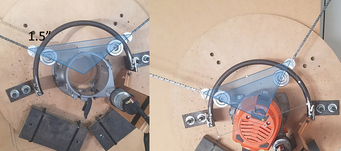

The maslow measures out the chain by having you set the motor so that one of the
teeth of the sprocket is pointing straight up, it then rotates the motor to fed
out a known amount of chain.
In addition to this length, there is some other distance from the chain to the
center of the bit. This number is what you have to enter into ground control.
This isn’t the distance from the bit to the ring as the machine would have no
way of knowing how far it is from the inner surface of the ring up to the chain
that it measured out.
This distance needs to be from the center of the bit to the chain. The only
question is if this distance is to the first pin in the chain or to where the
first sprocket tooth would fit (this is the 1/8" distance I mentioned above)

I think that the radius in GC is just an extension of the chain length to the router bit. It would seem that the angle between the chains would be the most important thing that this would be effected by the chain lengths. I made a picture at the bottom. It would be the same for a link set-up, the links are all part of the chain length.
I have been avoiding digging into the code but, I would imagine that the machine is essentially measuring position based on the 3 triangle sides (motor distance and each chain) If any of these measurements are off, it is going to come up with the wrong position.

Pivot was a poor choice and you were correct. Unless something is wrong, the chain should not pivot in the machine but remain inline with my adapter. I was more concerned with the attachment method and not effecting the chains function. I changed the method of attachment when I came across the steel link designs.

I like the look of that @bar. I think that having two bearings for each chain should mitigate some of the jerkiness that has been discussed earlier. I was planning on doing a similar setup.

I saw Bar on Friday. He provided me a half circle bar he wanted to test, with the double bearing trolley. The hardest thing about set up was making sure the ring was round. As a 1/2 circle it wants to relax. This is where placement of the L brackets was key. I had to flex the bar ends together to get it to fit round and maintain a equal distance from the bit in all directions. The only issure is with the casting of the bearing guides on the bar, there is a small lip that need to be sanded off to make a smooth path for the bearing to ride on the bar. This is where the only jerking was when it ran up against the “speed bump”.
It was cutting very accurate. I ran it around the board for fit and did not run up against the chains/brackets. I cut a sign out that had carving to it and it turned out great. the boarder is .25 in all the way around.
I need to do some circle testing. I was able to take the sled and tip it while cutting and it stayed on line. The bit stays centered. That is the key to this working and the most difficult. I had to adjust a few times to get perfectly centered.

In the Ground Control set up, you have to enter the exact measurement from the end of the chain to the bit. If you are off, you will have some oval issues, so play with the measurement until it works. I was lucky and measured it in a couple tries. I will take a photo of the sled and post later.
Here is the photo. image
