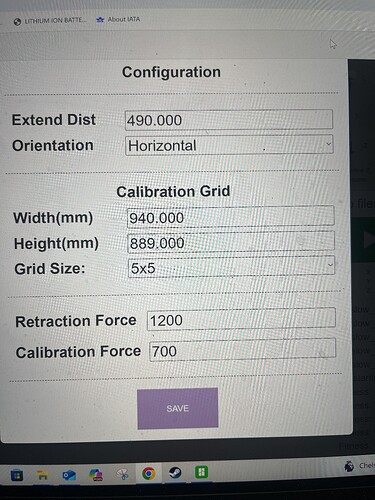

Hey y’all. I’m stuck calibrating my device.
One big issue I’ve had is the sled sometimes hits the anchor points during calibration. This has caused it to break the belts twice. Anyone have experience with the sled running into the anchor points and how to prevent it?

What size frame and what size calibration grid are you using?
My anchors are about the same size as the calibration grid 35inches x 37inches.
Is the calibration grid the size of the frame or the size of the working area?
The calibration grid should be substantially smaller than the size of the frame. Generally I’d recommend at least 18 inches of clearance from the anchor points or 36 inches smaller, but that doesn’t leave you any room to calibrate.
Trying to run a machine this big in a space that small is going to be pretty tough, its really designed to cut full sheets of plywood
it’s the size of the working area.
on a frame that small, you can do ~16 in smaller than your frame

Okay so 18 inches from anchor points a 3ftx3ft grid is too small.
To cut a 1ft x 1 ft area the frame should be 4x4ft?

2.5 ft square frame (although it is getting really tight)

one thing with such a small frame, the angle of the belts down to the anchors can be a problem, so you should add offsets to raise the anchors to be roughly even with the arms (with the router all the way down), don’t forget to set the Z offsets.
a vertical frame may need more height to reduce the stress on the belts in the top center
