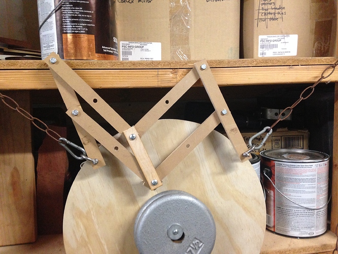

Alright, it’s late and I’m tired and this was another throw-together test but I learned something about the linkage designs!
To test a possible bar construction technique:
I cut 1" wide strips of ~1/2" plywood into approximately 9" lengths (using a hand saw to keep it real). I carefully measured and marked one with three points, each exactly 4" apart (starting 1/2" in from an end). I stacked all six bars and clamped them together with two C-clamps. I then carefully drilled through all pieces at the marked spots. I used a drill press but it could be done with a hand drill. Hand drilling will make accuracy more difficult here. I think this can be a sufficiently accurate way to make the bars but laser or plasma or water jet would be WAY better.

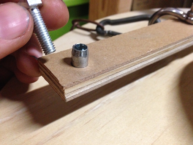

I used a screw pin shackle to give the chain rotational freedom while still using the hole in the center of the bar. This way you don’t need specially shaped bars. May still need refinement but this is much better than direct attachment.
I tried the 3-Bar Top Mount in two configurations and the 3-Bar Balanced. I wanted to try them both with the same materials and hardware at the same time so I could really see the differences in performance.
The biggest thing I noticed was that with the Top Mount design any error or slop in the joints added due to the compression-tension trade off. In the Balanced design any error or slop in the joints effectively cancel each other (they probably still lead to minor inaccuracy but it’s a consistent offset no matter where the sled is, with the Top Mounted one the compounded error changes based on arm angles and that’s not fun at all).
Of the two Top Mounted set ups I tried the one with closer arms felt slightly more stable.
I think you can see in the pictures of the Top Mounted one that the vertical arms are slightly splayed, this is the compounding error I was noticing.
Even with my weights directly centered on the sled it feels quite “bottom heavy” using the Top Mount, [EDIT: after sleeping and re-assessing, I no longer feel this to be true. It was a perception when held in my hands but on the chains it is very well balanced) but with bricks on your sleds I imagine you’re already used to that. I just added 15lbs of weight in the center of the sled.
Another possible problem with either design (if stacking the bars like I did) is that the chain attachment points are not on the same Z-plane. This can probably be fixed and my not affect too much but it probably matters enough to think about it.
Here’s a far too small version of the Balanced design, there’s clearly not enough clearance with 8" spacing like this.
I just wanted to feel it compared to the Top Mount using the same weight and materials.
While I like the idea of the Top Mounted one because it can be made smaller and more compact, if I were to build myself one right now I’d probably go with either the Balanced or the 45° design. I just don’t like compounding errors!

I spent some time with it this morning (after getting sleep!) trying to figure out where the slop was coming from. There is very little coming from the bolts at the joints. I used these sleeved bolts I had laying around and I drilled to fit them pretty well:
While the holes are tight enough that the sleeve doesnt fall out they are loose enough to allow for rotation. There is very slight yet perceivable movement in the joints. After further inspection I don’t think much of my error was coming from those joints.
I think the biggest culprit is the anchor points to the sled. These are just large (3/8?) screws that go through the stack and screw into the sled. I had originally thought this might be a problem but it turns out with the weight its more of a problem than I expected. What happens is the top anchor point is pushed down while the bottom is pulled up and together they throw off the geometry enough to cause misalignment at the chain of just over 1/4"!
I used some spacers to hold the assembly off the sled but they were free-floating. This could probably be solved by securely glueing (and screwing) a solid spacer to the sled and mounting to/through it. That puts the moment of rotation directly under the first arm as opposed to 1" below it as is with this mockup.
If you look carefully you can see that the two “horizontal” bars on the right in the image below are not parallel to each other. This is due mostly to the anchor slop.
I attempted to alleviate this by adding a piece of 1/4" plywood under the screw heads to force them to stay exactly 4" apart. This actually worked quite well and put this design back on the table for me. In the picture below you can see I rotated it pretty far and the horizontal bars are far closer to parallel than before (though they are still not perfect).
I believe that most of the remaining slop in this system is in the anchor holes; even though I drilled them the correct size they are not sleeved and I think the wood pushes into the threads slightly and allows misalignment. It’s pretty minimal and I think it could be solved with a smooth shank bolt, or a sleeve, along with solid spacer blocks (glued and screwed to the sled)
I think I mischaracterized this one. I think the impression of bottom heavyness was only when holding the setup myself (like, in my hands). When I re-visited it this morning it was apparent that the sled is quite neutral rotationally. If I rotate the sled it easily stays where I put it, there is no tendency for it to rotate back.

With all that said I think there are ways to reduce friction and increase rigidity without adding much work or cost. It might also be worth noting that it appears that if I lengthen one chain to the point the linkages touch the center weight (which represents a router) it doesn’t appear to throw off anything. Instead the entire sled tilts around the center axis and everything seems to stay aligned… This is just a cursory observation without the proper tools or set up to test it. So if anyone has made one with an actual Maslow (or at least not hanging from a shelf by nails :flushed:) maybe check to see what happens when things bind. It might not be as bad as we thought!
I bolted my spacers very securely and used 1/4 inch bolts. I don’t think I have much movement, certainly not 1/4 inch of movement
My center of mass is much lower, bricks at the bottom. If I force mine to collide I don’t see a dramatic sudden change, but I do start to see a rotation with a center higher than the bit. It isn’t huge, but we are talking about 1/16 accuracy, so I think it is enough to cause a detectable error.
I didn’t have 1/4" of slop either. The slop at the anchors was closer to 1/16"-1/8" (I never measured it), but I believe that is amplified through the system then added to the other side and in the end there was about 1/4" error, total, at the chain ends. I really have nothing to measure against so that’s just a guess.
we are aiming for 1/64" accuracy. I think that to get to that level, we will
have to account for chain droop, but right now we are facing problems where
people are off by 1/2" or more (depending on calibration)
that sounds about right. If the slop at the anchors is 1/8" on each of them, and
the vertical arms are twice as long as the space between the anchors, that would
result in 1/8" slop from each of them adding together to the 1/4"
