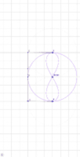

I think I have a solution with only 3 bars!!
Maslow 3bar
You can play with it here:
As long as AD is equal to BC and DC is equal to or less than AB then E will always trace a circular arc segment with its center exactly halfway between A and B.
Changing the ratio of AD and CB still results in E tracing an arc however the center gets shifted left or right (and I am not certain it’s still a circular arc, but it does look like it is).
The purple line is the path that E can trace. E would be a chain connection point (this mechanism would probably have to be rotated so that the arc segment that E travels lies where the chain would want to run) E is halfway between D and C.
EDIT: I think technically this is a 4 bar linkage because the router base acts as the 4th bar… But it uses only 3 moving bars…

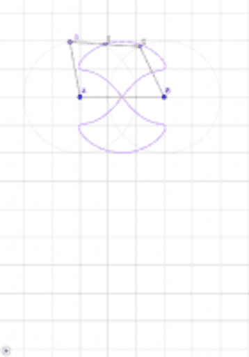

Here’s a sideways version. This on either side would get the job done. (appologies if there are issues, never used GeoGebra before :slight_smile:
Beat me to it! Thanks! It could even be at a 45˚ angle… It’ll be interesting to feel how it actually works when I make a real one. (Geogebra is also new to me but it’s pretty awesome so far!)

Point E can also be moved along line segment CD, moving the center of the circle without affecting the shape. This should allow more flexibility when it comes to mounting points.
Another point (pun intended) is that the positions of the points matter, but the shape of the bars doesn’t have to be a line as long as the shape is rigid and the points are placed correctly. This could help us design around the router and other parts.
Certainly in the sideways version this would be important. As when the sled is all the way to a side, the lower bar linkage arm would need to run through the router. Similarly in the original version, moving the sled to the top of the board might also cause an issue.
Hopefully some version of a 45 degree angle resolves the need to using bent arms.
I just did some more testing and found that while the drawing I posted is REALLY close to perfect, apparently the only time the distance from the center (unlabeled in my drawing) and E remains constant is if AB and DC are also equal lengths. Basically it needs to be a parallelogram in order for E to trace a true circular arc. My bad.
It will still work though, just DC needs to equal AB.
Here’s an updated model with the radius from the router bit to the chain-end labeled so you can mess with lengths and see how it affects the arc. I also rotated it 45˚ to help envision how it could be installed. Drag D around to see the movement, adjust the segment lengths in the panel to the right.

Actually, since Maslow’s motor arms are above and beyond the edges of the cutting surface I don’t think the sideways version would be a problem in real life. The router/sled is never directly below either motor. My mind likes the 45˚ look but that would require two bars to actually cross each other, which could be done but adds complexity.
There may be another combination of lengths that produces a perfect arc for long enough for our needs. As has been mentioned in this thread already, there is no need for a full circle or even half a circle. Two relatively short circular segments would suffice. If we can get a linkage to trace a proper arc for just the needed sections we’d be fine.
We won’t need to pivot more than 90 degrees, the chain is never directly above or directly to the side of the sled. If anyone with a Maslow and a protractor wants to figure out the exact angles needed by measuring at the corners, that might help (probably also possible to approximate with drawings/videos if I have time later). We’d also need to add a little bit of slop to account for rotated sleds, so maybe ~90 degrees is a good starting point…
To get around the overlap issue, I see a couple of possibilities. There may be an angles other than 45 degrees that won’t see significant overlap for our <90 degrees of motion. Or maybe we could have different lengths (AB/CD and/or AD/BC) for the left & right sides. As long as the ratios are right, size shouldn’t matter. (not sure if this is what you meant).

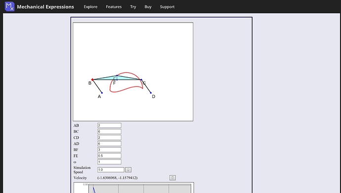

This site is much easier to use than Geogebra…
http://mechanicalexpressions.com/explore/kinematics/4-bar-linkage.html
