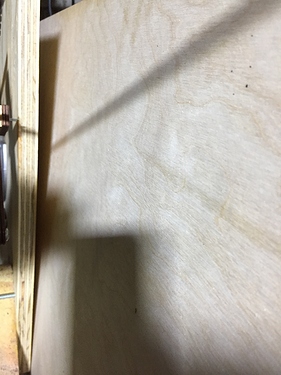

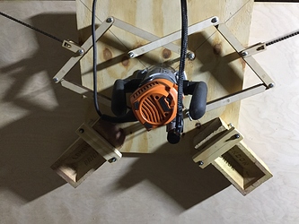

Hi, I just discovered this topic searching for “gap between the sled and the surface” and instead of starting a new post, perhaps I can share my situation here. I couldn’t get the original Maslow CNC kit, so I ordered various bits form multiple sources and I got this linkage kit:
When I attached the chains, I noticed a 4cm gap at the top of the sled, which doesn’t look right to me. The router I have: AEG Router MF 1400 KE. And the frame is the default frame as described here:
This is how everything looks:
I haven’t tried cutting anything yet only, only tested the basic movement. Also this is a temp sled as described in these instructions:
http://maslowcommunitygarden.org/Maslow-triangulation-linkage-kit.html, but I guess I would have the same issue with the normal - round sled.
@brewed_over, as I understand you mounted by linkage kit not in the center, but 2.5" above it? Maybe you could post a photo of how it looks? Also any advices / comments from other are very welcome too.
I think your center of gravity is a bit out of whack. Can you try raising the linkage kit in the z-axis (i.e. make the pillars supporting the kit taller.)
The linkage kit (or any triangulation kit for that matter) relies upon the kit being as close to perfectly centered around the router bit as possible. Raising the linkage kit upwards on sled (i.e., vertically in the y-axis) would be detrimental.
Ah! I see what you mean, I noticed these spaces here in the photo:
Perhaps my mistake was that I used the four middle nylon bushings as spacers. Well actually I inserted them in the linkage kits holes, then removed (now realising, I shouldn’t have done so) them and used as spacers.
Looking at the instructions again, I see that I missed / misunderstood, this bit:
“Once you have tested your spacer blocks and are happy with the balance they should be glued securely to your sled.”
