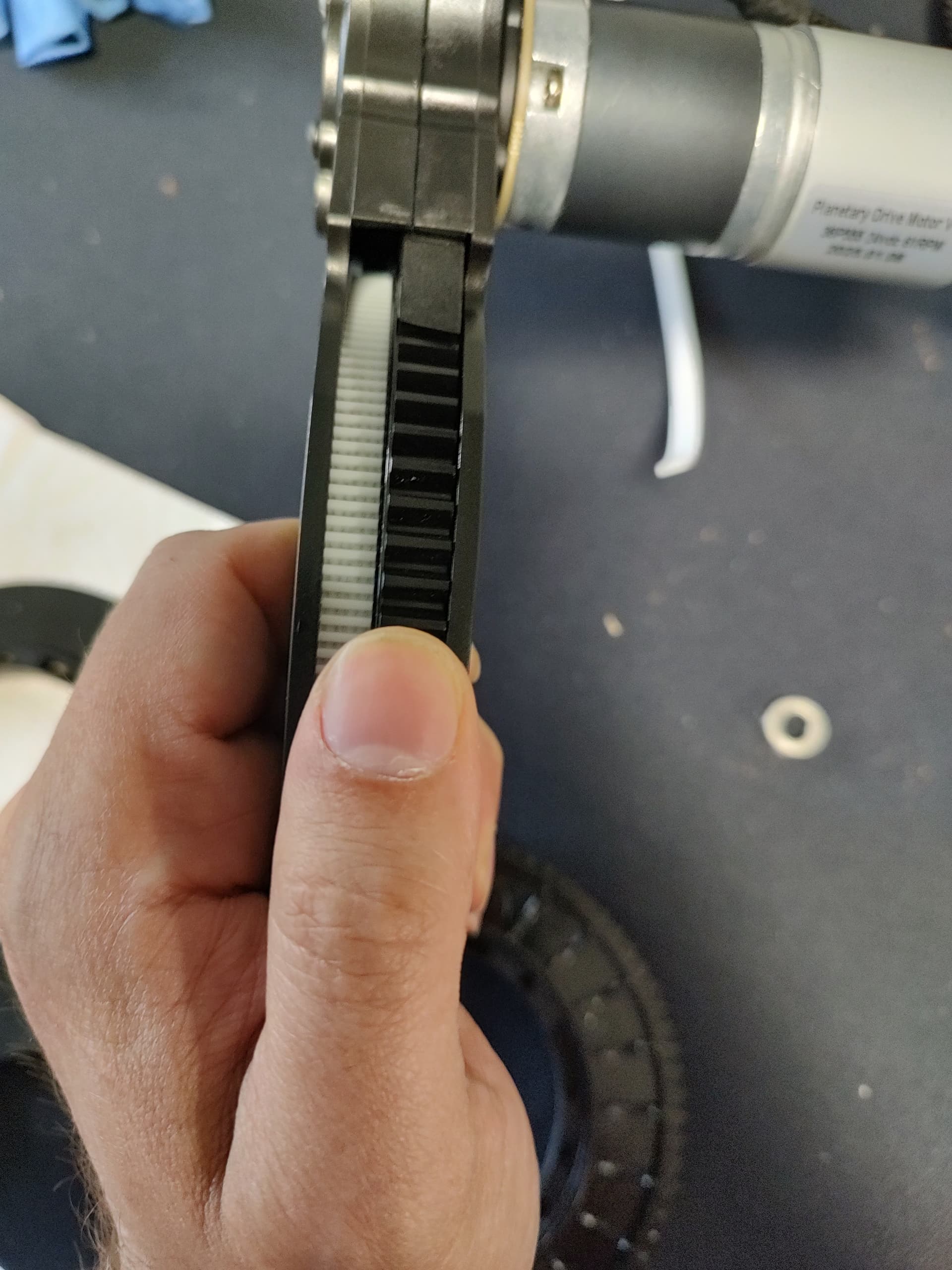

Note, you can check the amount of friction after assembly, there is a tiny bit of backlash if the belt isn’t retracted under tension - enough to rock the spool back and forward a few tenths of a mm with your thumb - it’s very noticeable when you can / can’t do it. If you’re not sure, you can easily extend the belts 10mm or something small and check.

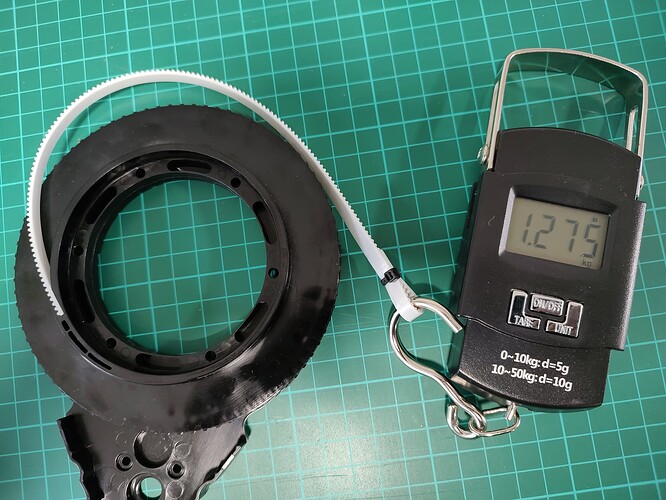

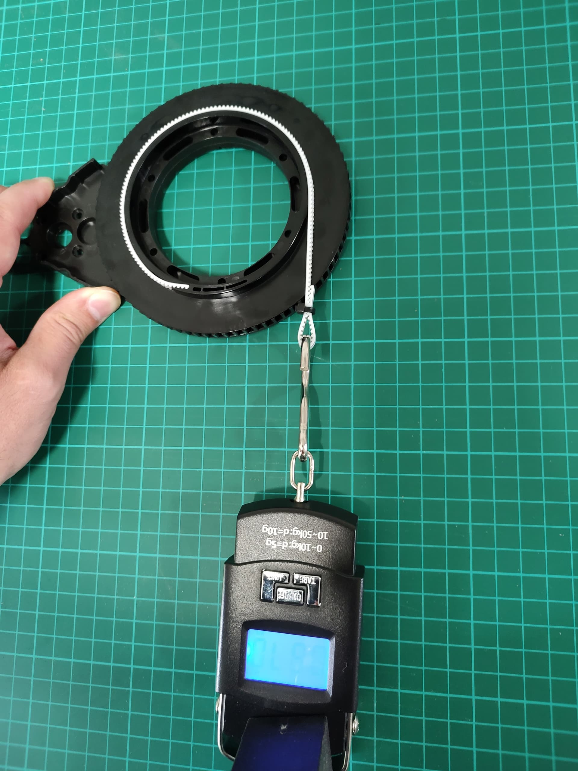

To give some indication of what kind of friction I mean, without anything bolted together I could see ~1Kg (so 10Nm) of force not turn just a spool on an arm:

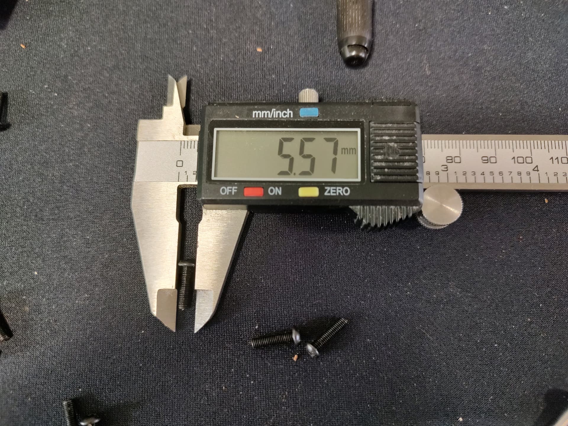

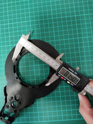

My thinking was - if I’m having to use force to put the bolts in, are they deforming the arm slightly and causing (at least some of) the friction? There has also been a bit of talk about having to crank the bolts down enough to engage the locknut end. Either way I went looking for some bolts with a smaller head and 14mm long.
Note - my digital callipers are fairly cheap, so don’t assume the measurements are absolute, but it’s good for relative at least.
The stock heads were about 5.6mm:

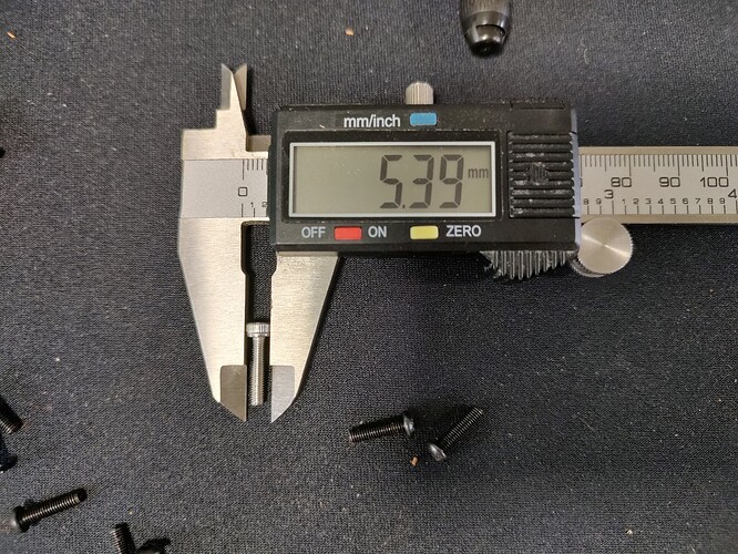

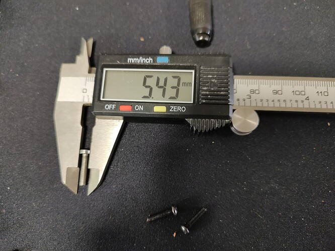

Socket Head cap Screws seemed the best of the various I tried:
The ones in the last picture are the M3 x 14 option of these:
The thing I noted is all the listings give the head diameter as 5.5 / 5.6 etc, with a tolerance - these just seemed to be the ones that ended up the smallest when I got them.
With these - they drop into the bolt holes on the arm loosely, including the arm I had that was tight on the originals. They also allow the nut to be just tight and rely on the threadlock on the bolt rather than tension (i did whack a little blue threadlock on too just to be sure).

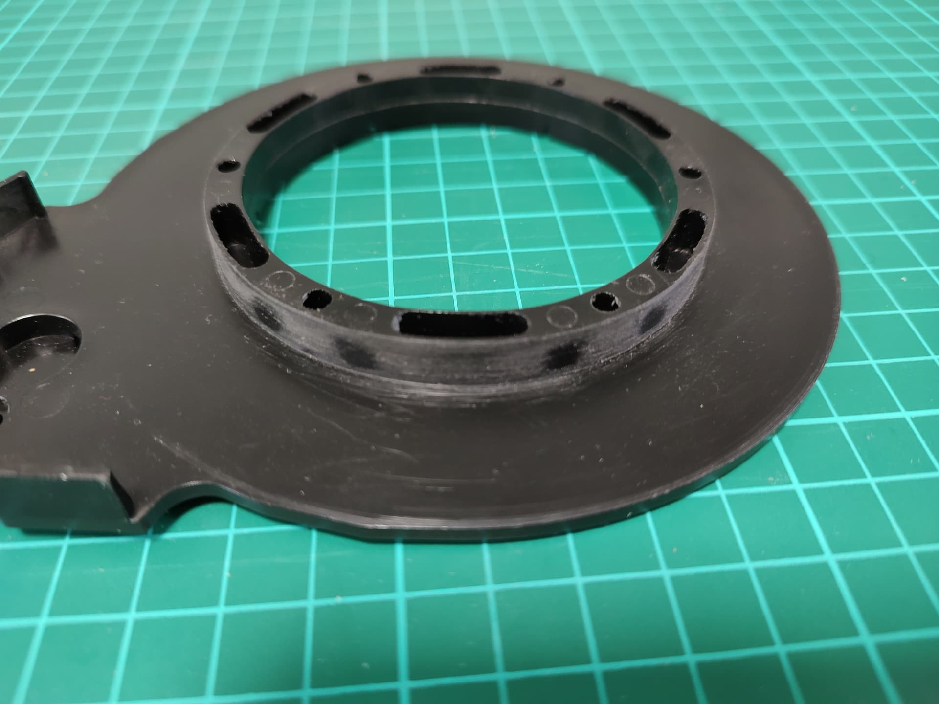

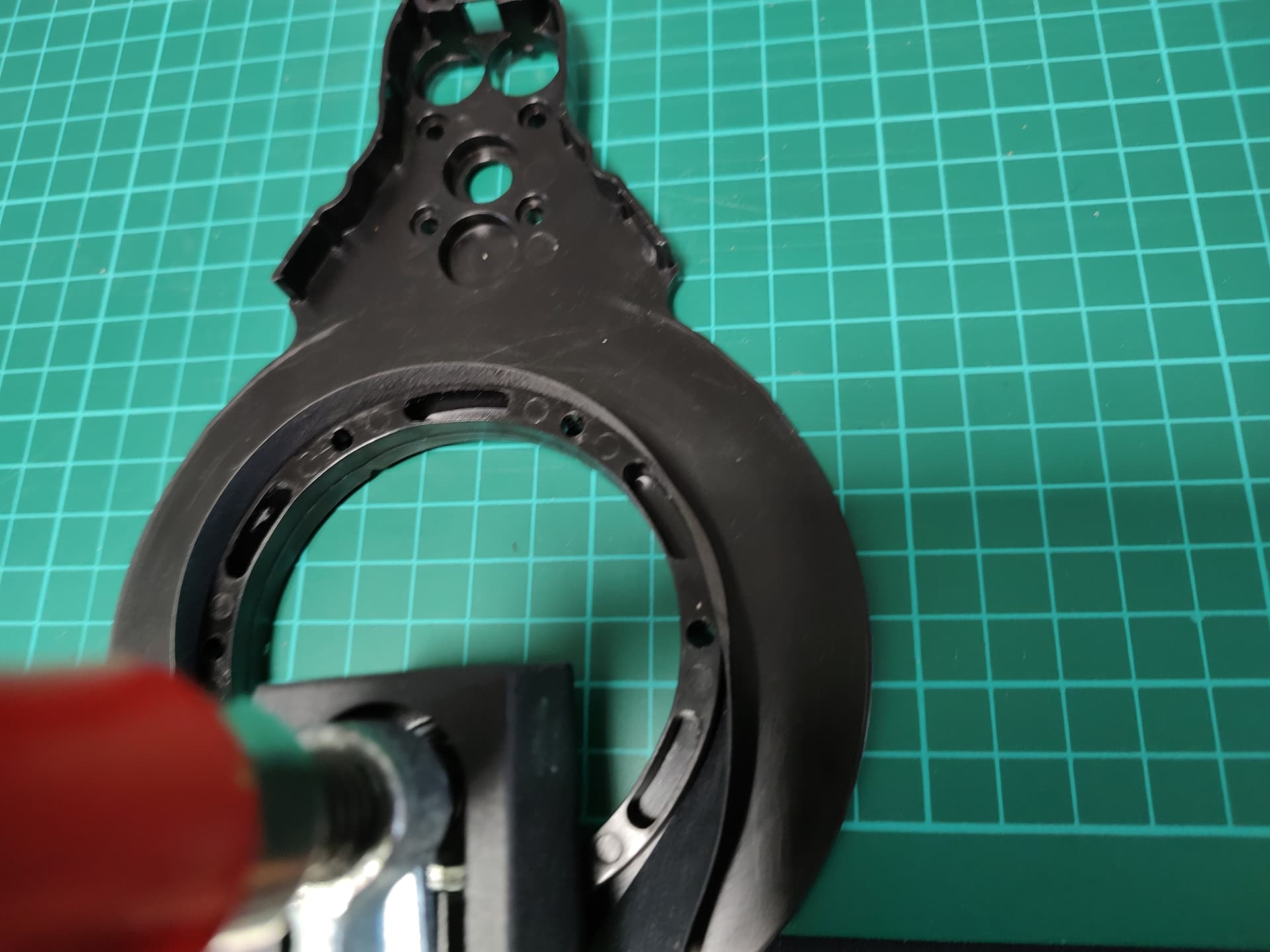

My initial measuring (and what I could feel) suggests the arms I have aren’t perfectly round in cross section:
Sanding a little shows this up quite well:
I wonder if this is due to different cooling rates for the different thicknesses?
So how to sand a slightly inclined cylinder?

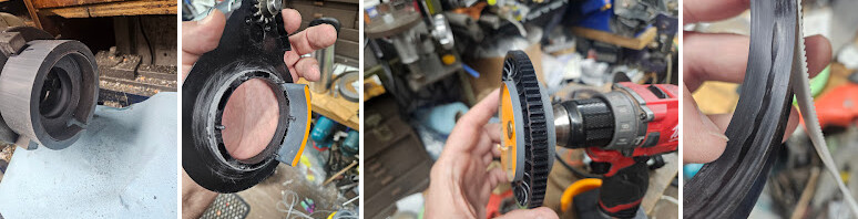

I tried a few different ways. To try and keep the material removal to a minimum, I tried some valve grinding paste (mostly because I wanted a grinding paste and I had some lying round):
I just used a little of the fine, dabbed on with gloves, and just turning the spool on the arm. It works pretty well, but ultimately I ended up cleaning it up with wet and dry paper anyway, plus it’s messy, so I wouldn’t bother.
What really worked for me (like others), was wet and dry sandpaper - using 200/400 for material removal and 1000 to smooth (wetted). I tried both clamping the arm down to sand, and freehanding it. Not sure which was better tbh, I think freehanding is fine.
With that, I worked my way through all the arms as I reconstructed. I was being fairly conservative, sanding until they span with minimal friction, sanding the spool a little first, then the bottom arm till the bottom of the spool spun on that, and then the top arm until the top of the spool span on that.
I could have gone further so they were spinning completely freely / had a little play. I also could have added some wax / lubricant.
But with what I did I had one arm retract a little at 300, three retract but no quite the whole way at 400, and all retract at 500. Though i’d still use at least 600, and probably 900 for calibration. And while i’m still testing, the trivial calibration I did (running just the first set of points) was giving a very good fitness at 900 - I suspect 900 will work well for me this point forward.

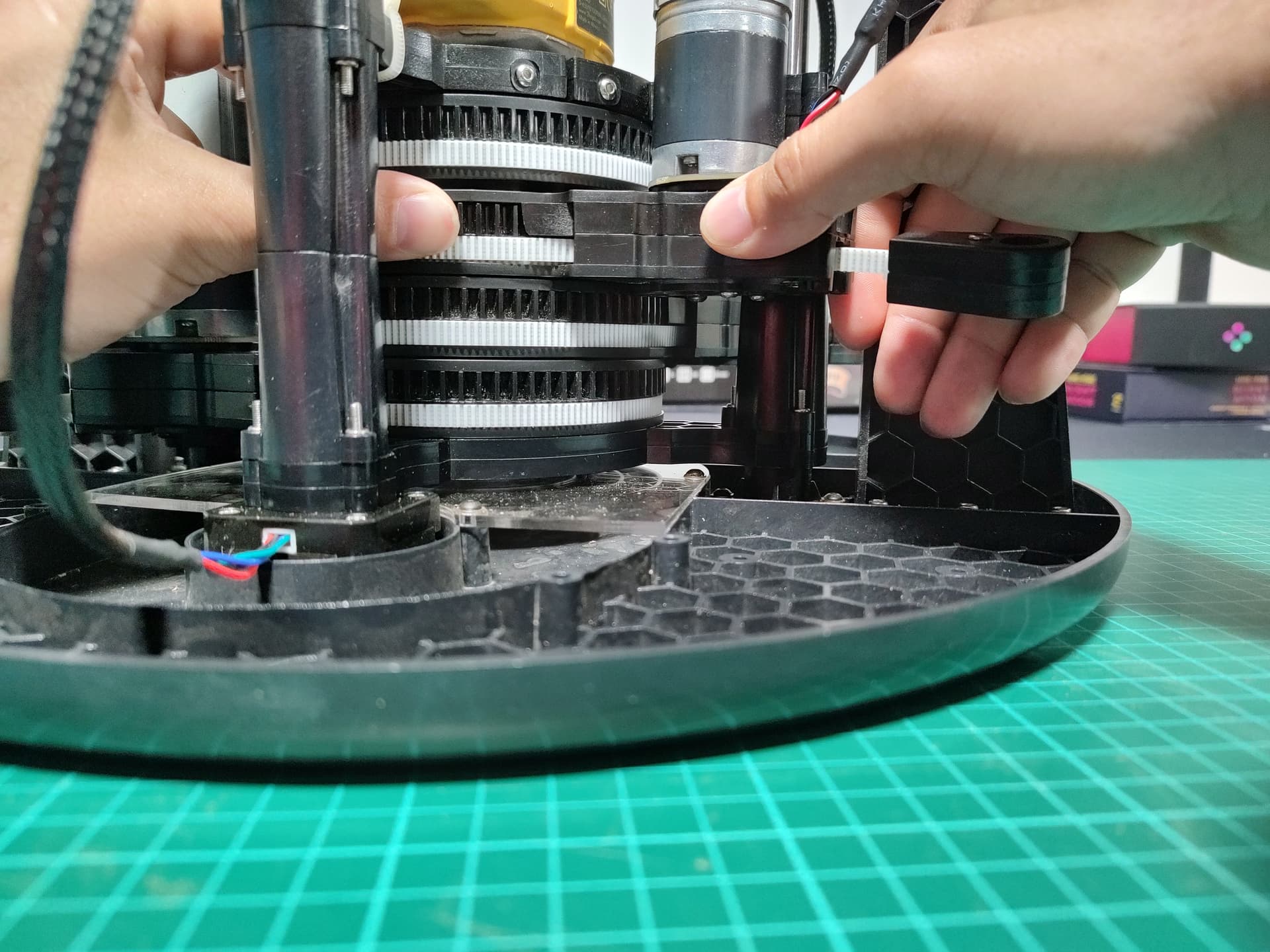

    • Assemble that arm, without the bolts too tight, and check you can rock the spool with minimal force (see pic:).
    • If needed, sand the spool or arms a little more until you’re happy.
Should be able to rock it with gentle force once done:

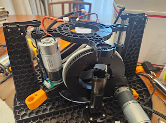

I tore down my Maslow and polished out the rotating parts… Significant reduction in torque required!
BTW, if you want to tear down, you can get the spools out after taking out the router and 12 bolts.
Calibration would have gone better if I hadn’t swapped a couple dimensions for TR…
After I fixed that it just too most of a forever, but FINISHED!
It can actually drive in a straight line now! Progress!!!
