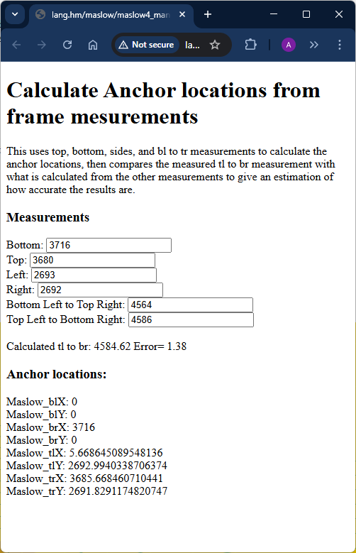

When is it OK to give up on calibration and use Maslow_Scale_X and Maslow_Scale_Y to "fix" scale errors
I’ve been struggling to get my maslow to draw squares - it is giving me rectangles
Rather than burn through wood I have a pen holder fitted and am drawing on cardboard with it
I have tried the automatic calibration, and a manual measurement calibration and I get the same result.
Drawing a 500x500mm square results in a 502x489mm drawing
Nice right angles, but short on the Y axis by 2.25%
This is fairly consistent between the auto and manual calibration
I have a horizontal setup approx 3700x2700mm between anchors
This is the results from @dlang’s fantastic calulator showing the dimensions and a 1mm measurement error in the manual diaganol measurements
For the automatic calibration I get numbers that look something like this

So, not good, in that they don’t match the measured values at all well but they do give me the same X and Y scale errors when I plot my test squares.
So is it time for me to give up on getting the perfect calibration and just set Maslow_Scale_Y = 1.0225?
It feels like cheating to fix the issue this way without understanding the cause
Any advice is welcome
-Andrew
if it works for you it works for you, period.
keep an eye on it, the error may not be linear, so the scaling may need to
change (either due to position, say near the edge, or due to improvements in
future firmware upgrades)
the x/y scaling is a hack, but that just means it works for at least some
people, even if not the theoretical ‘right’ answer.

Hi, where can I find the link to that calculator?
http://lang.hm/maslow/maslow4_manual_calibration_simple.html
Thanks for the quick reply.
If I use the calculated anchor points, is it still necessary to fine-tune the axis scale?
If your measurements and calculation are 100% right you do not need to adjust the x scale or y scale.
If you Maslow has any issues, like stiff spools or misaligned magnets then it still won’t work.
it depends on how accurate you need the machine to be and how far off it is.
in theory, no. In practice, possibly.
