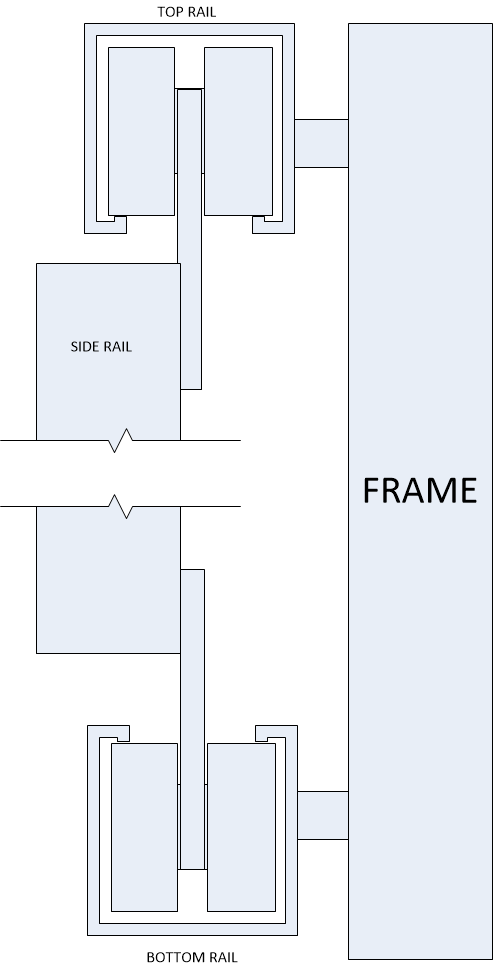

I’ve posted a couple times about a similar concept and still wonder if it’s feasible (I’m never one for just giving up). As @dlang has said to me, you would be better off switching to COREXY setup if you do a full set of rails. There’s the thought that you couldn’t move the sled smoothly if you put rails on and use the current motors in the corners because there would be a tendency for the rollers/rails to rack because it’s being pulled at an angle. I can see the potential for that to happen.
I did look at using two fixed horizontal unistrut channels (one at top and one at bottom) with unistrut trolleys to suspend two vertical unistrut channels that the sled would ride in (one on the left side of the sled and other on right side of sled). The chains are then only supporting the weight of the sled as the vertical rails are supported by the two horizontal rails (which in turn are fixed to the structure).
To me, the biggest Pro would be that it suspended the sled off the surface. This eliminates tilt and also allows you a great deal of flexibility to do contouring of the workpiece.
For cost, You can get eight unistrut trolleys (two wheel, not four wheel) for $100 off ebay. They’ll work in the superstruts you can buy at Home Depot.
but aren’t they designed to work pulling away from the unistrut? and pulling
straight down?
In this case, gravity is working sideways to your mounts

They are designed to work pulling away from the unistrut, correct, but if “tensioned” properly, I’d think you could get the bottom wheels to ride on the tracks as well. By “tensioned”, I mean having it so that there’s a little pull between the top wheel and the bottom wheel… sigh… you made me do a drawing…
How practical this all is, how achievable it is, etc… I don’t know. I’m quite happy at the moment with my stock frame (with 2x4x10’ stiffener between motor mounts) and the results it produces. Nevertheless, its a nice thought experiment.

I don’t think where the chain mounts is a problem, I think its that it’s being pulled at an angle… Another drawing time!!
If you use COREXY, you pull the sled left at 90 degrees. Using maslow, as shown in the drawing, you are pulling it at an angle which would tend to cause the two vertical rails to want to rotate. You’d really have to have everything tight to avoid that and I don’t know if it’s achievable without too much friction being added.
