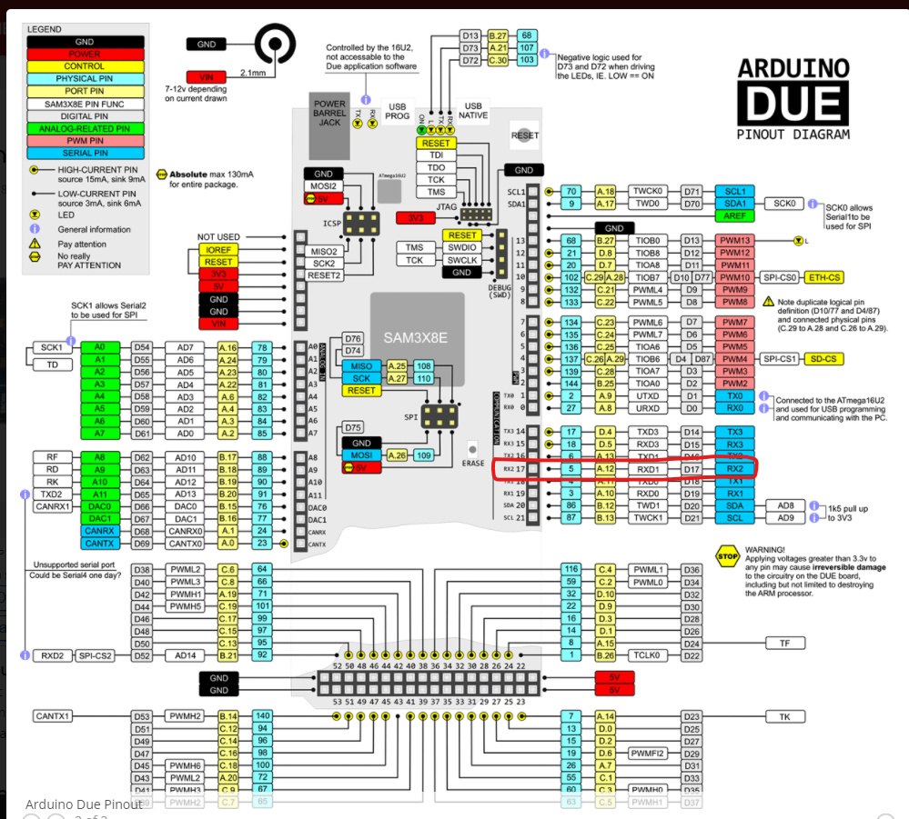

here are my observations:
I don’t believe that the Pin numbers relate to the code that is called in the cpu map, for example on the example above for the UNO @ame showed that the pinouts were on D11 or D12 depending on spindle control, and the code agrees with him, sort of, the exception being that it calls bit “4” to reference pin 12, and bit “3” for digital pin 11 - the physical pin number.
3 and 4 relate to the naming of the pins as control bits under the programming protocol (I think - please shoot me down if wrong). Pin 11 and 12 are called out as PB3 and PB4 - the same holds true for the X and Y limit switches and other coding in the UNO code.
note that in the Due code it refers to 13, but references “Due Pin 50 C.13” I think 13 is the address for the programming bit, not the pin number, the code may actually be watching pin 50.
Now if @Orob is correct and physical pin 13 is no use because it is on the LED Bulletin flash channel, but D17 is accessible I suspect the correct bit number is going to be… A.12
Which seems to be a comms channel, this is from the Arduino webpage:
Pin 13 seems to be connected to Z+ and the LED - seems correct
No idea how you would reference pin 17, it can’t be bit “12” as that is probably on pin 51, marked up as C.12, or PC12 on the Arduio site.

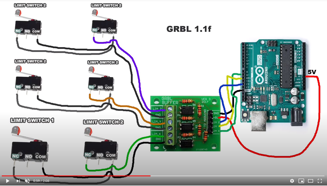

but in everything there must be an answer, given all the above and what is in the current code I suspect the system is watching physical pin 50 for Z-Limit, with 2 switches wired in paralell, one for each end of the z-axis and a resistor/filter of some description inline - like this, but only for the z axis with the wire going to pin 50…
or without the isolation…
this helps… and confirms the UNO connections. v. tempted to try it…
