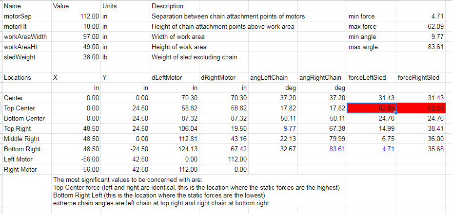

I am curious about the relationship between the force exerted on the sled by the left and right motors and the performance and accuracy of the machine.
I’ve been gradually working on upgrading my machine, and one of the big changes is a new, adjustable depth top beam. I almost finished my own Z-Axis when I realized that my frame can’t support it presently. The CG of the sled is too high for the motor mounting brackets I made up originally. So I already need to modify the frame to support the sled. The other factor to the new top beam is that it can be longer than my 112" frame’s current “top beam”.
Which is where I’m going with this long-winded intro. I was playing around with @dlang’s chain geometry spreadsheet and I want to make some sense of the data that I’m looking at.
This is my current, working setup:
I’ve never stalled my motors trying to move anywhere on the frame, even though the force on the sled at top center is too high for the motors. Admittedly, I determined that the machine only has a usable cutting area that’s roughly 3’ in Y by 4’.
This is the geometery that the new top beam gives me:
The longer top frame reduces this force to 40.7.
After reading through this thread, I learned that the ideal Y offset is somewhere around 30" for a 12’ top beam. In the spirit of experimentation, I changed my current Y offset from 18.5" (determined from CAD) to 30" in the spreadsheet.
The data certainly supports this:
So my question, looking at these numbers, is how much improvement would I see from my current frame’s Y offset of 18.5" to 30"? The force on the sled is nearly half of that on the higher offset. Would that potentially give me accuracy to the top center of a sheet?
It will be a small project to modify the frame to get that 30" offset. But, given that I’m already going to be modifying my frame, now would be the time to do it. And since my frame is steel box tube, I can plasma cut out slots to allow for Y offset adjustment, if I do find that I need to fine tune it.
It’ll then be a fully adjustable top beam :smiley:
Thoughts? Am I overthinking this?
your sled weight changes from 38 lbs to 20 lbs. Not sure if that is a mistake or if you will be using a new lighter sled. higher top beam gives improved top center performance.
wider motor top beam spacing gives improved bottom corner performance.
Finding a good balance between the two is the trick.

we don’t have a lot of information here. I mostly try to make it less than the
stock frame. We currently have the max feed rate set a bit lower than the
machine can move due to problems reported at max speed, and going by reports
that a 30 pound sled had problems, I made it go red about the point that would
be a 30 pound sled on a stock frame.
but it’s a guesstimate, not a hard limit.

For Funsies, I plugged in the stock frame values (from the old CAD model):
So the number to beat is about 50 (lbs? not sure of the units here). Oddly enough, the minimum force is pretty low on the stock setup as well, although it beats my current setup.
I played around with the numbers for my new setup, and increasing the sled weight certainly helps with minimum force. I’m thinking that this will be my target frame dimensions:
This gives me a good margin in max force over the stock setup. Also, the minimum force is higher than my other hypothetical setups. Looks like I will probably be looking at increasing the sled weight to 30 lbs.
Yes, the stock frame has high max force and very low minimum force. I think I
have it turn red just above 50 pounds force
That looks pretty good. I hadn’t realized how much a higher top beam helps the
max force (by drastically impoving the angles)
I also think we need to experiment with settng the frame closer to vertical.
That will decrease the friction, which will leave more of the force available
to move the sled.
