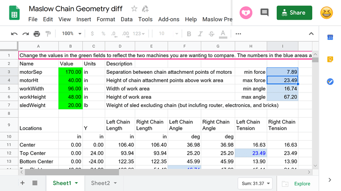

there is this spreadsheet that lets you try various dimensions, it doesnā€™t account for the frame angle (changes would be welcome)

so going to 14ā€™ 40" increases the max for by 2.58 pounds and decreases your min force by 1.7 pounds, so itā€™s worse in both places than a 12ā€™ 30" frame
That doesnā€™t make any sense. Something mustā€™ve gone wrong in the comparison.
I put in 170" motor seperation and 40" work piece distance and got about 7.9 and 23.5 for min and max force which is better than stock and better than 144" distance
In this sample image the green rectangle is about 48x96", the distance between the motors is about double that or 196" and the height from top of rectangle to motors is about 40". Putting those numbers into the spread sheet gives min and max forces of about 10 and 26.5. a difference of about 16. Compare that to the ā€œstockā€ set up which has a difference of about 30.5. the bigger the difference the more variability in the cutting forces.

10ā€™ 18" is min 3.3 max 33.7 (stock)
12ā€™ 18" is min 6.4 max 40.2
12ā€™ 30" is min 5.7 max 25.4
14ā€™ 40" is min 7.4 max 22.8
16ā€™ 40" is min 9.3 max 25.5
