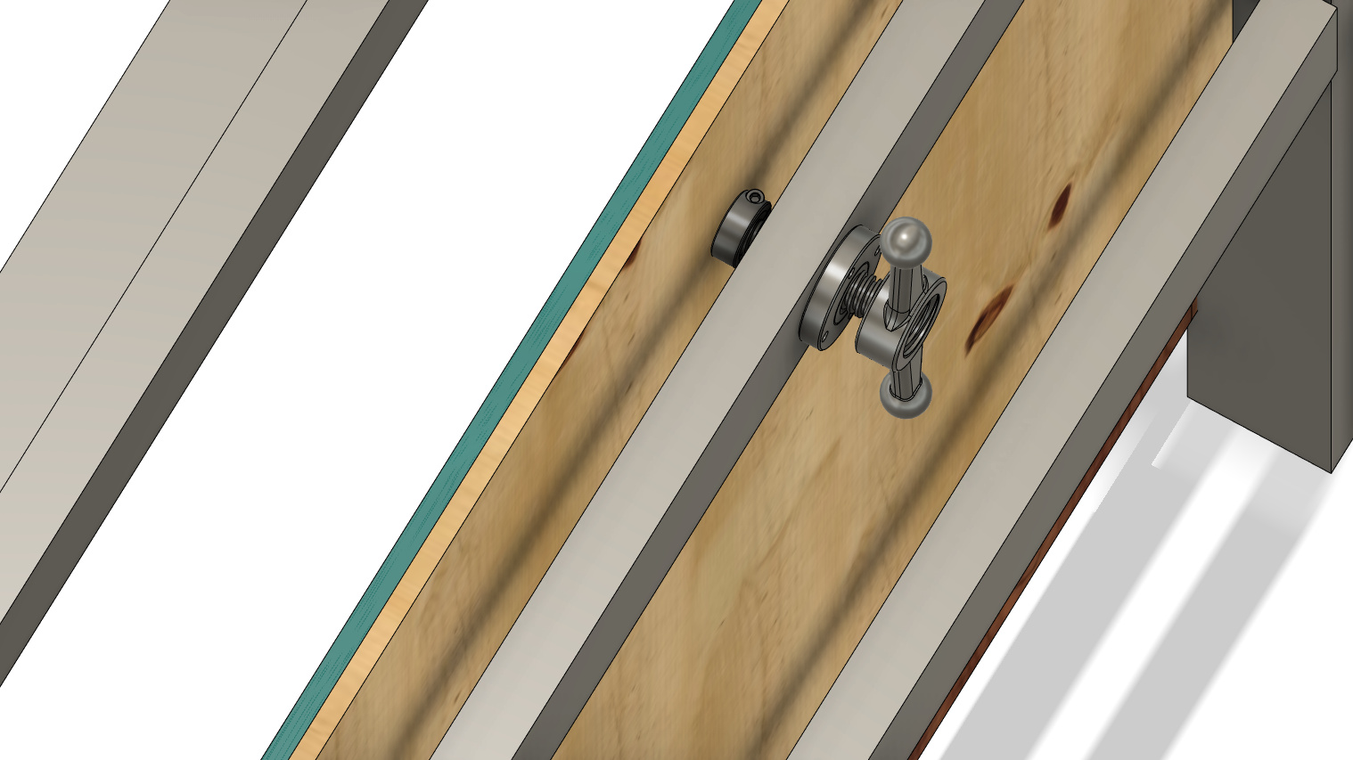

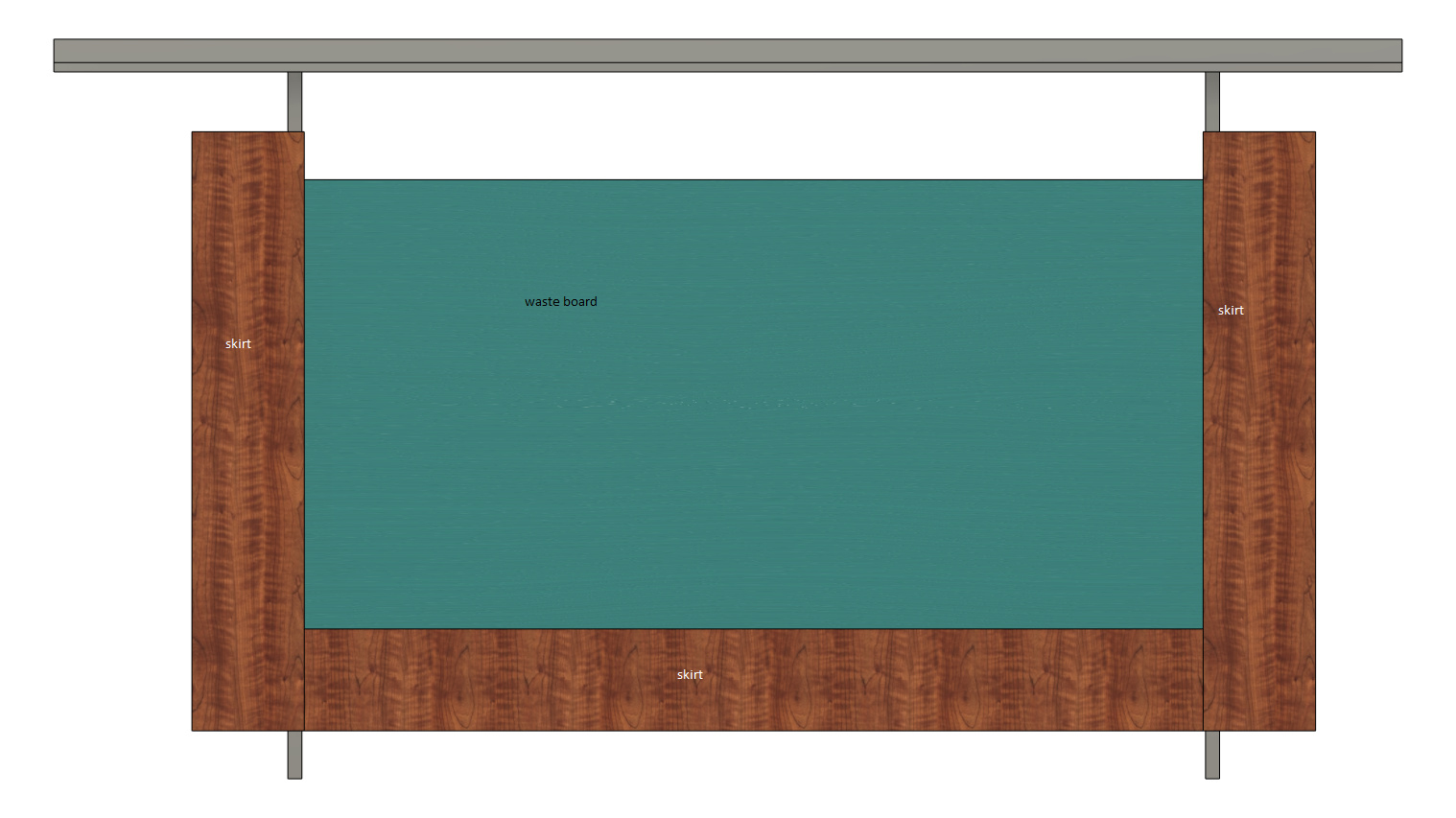

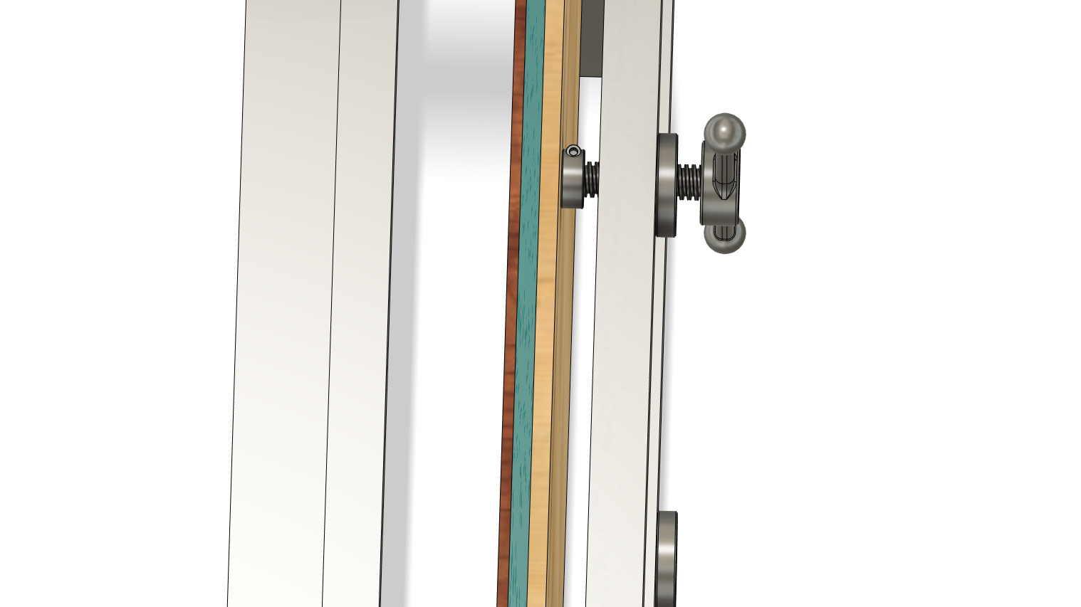

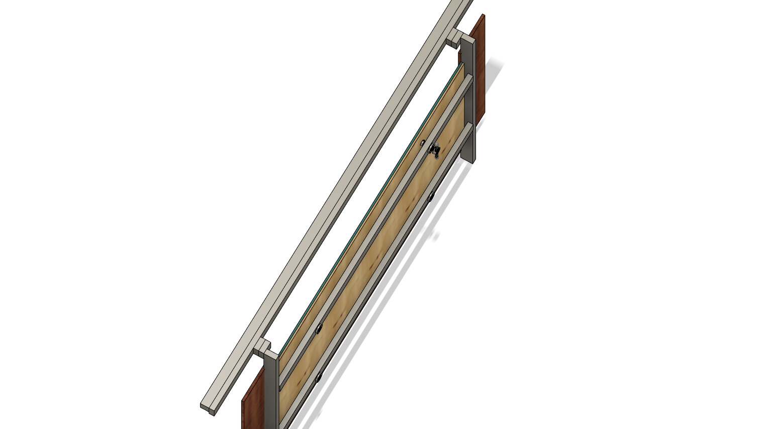

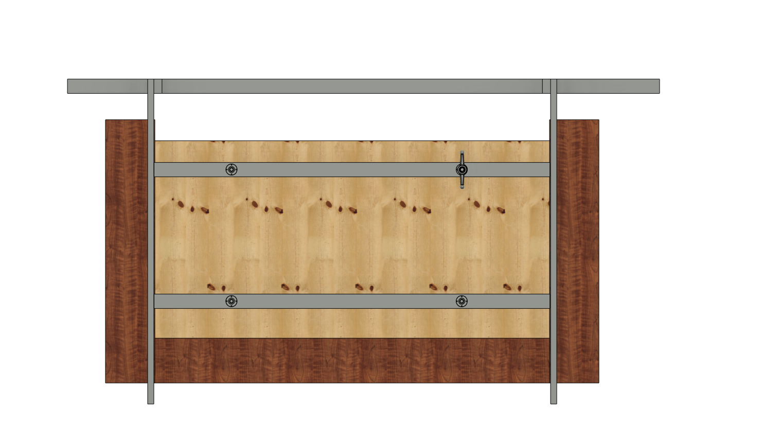

To all,
Second frame build is being designed mentally right now, I have the original Maslow from the Kickstarter campaign. Had built the default frame in my garage with a 10’ top beam for my first build, which was finally taken apart after motor gear failure and wife had enough of it sitting there in the garage for approx 1 year idle.
New frame needs to be wall mounted (small but long shed).
After many hours of cutting large projects 12’ top beam seems to be a must for lower/outer edge accuracy (or longer? love to get more feed back).
Also thinking to use unistrut or similar just for the top beam for rigidity.
Really need a skirt for full 8x4 projects.
Musings:
Why not keep the top beam fixed (motors and chain) and also the 8x4 skirt fixed and in level/aligned with each other.
Have a MDF bed with a foam waste-board adjustable from behind at four points using a screw system similar to the z axis/router depth or that of a C clamp system?
This would allow each screw to be adjusted to keep the work/cutting material level to the skirt which is fixed and aligned to the motors/chains.
If working on a smaller dimension project I would need to put filler pieces around it to make a skirt.
Just beginning to learn Fusion 360 so may take me a little while to post a mock-up of what I envision
basic drawings mocked up one of the mechanism hope they make sense
angle close up
