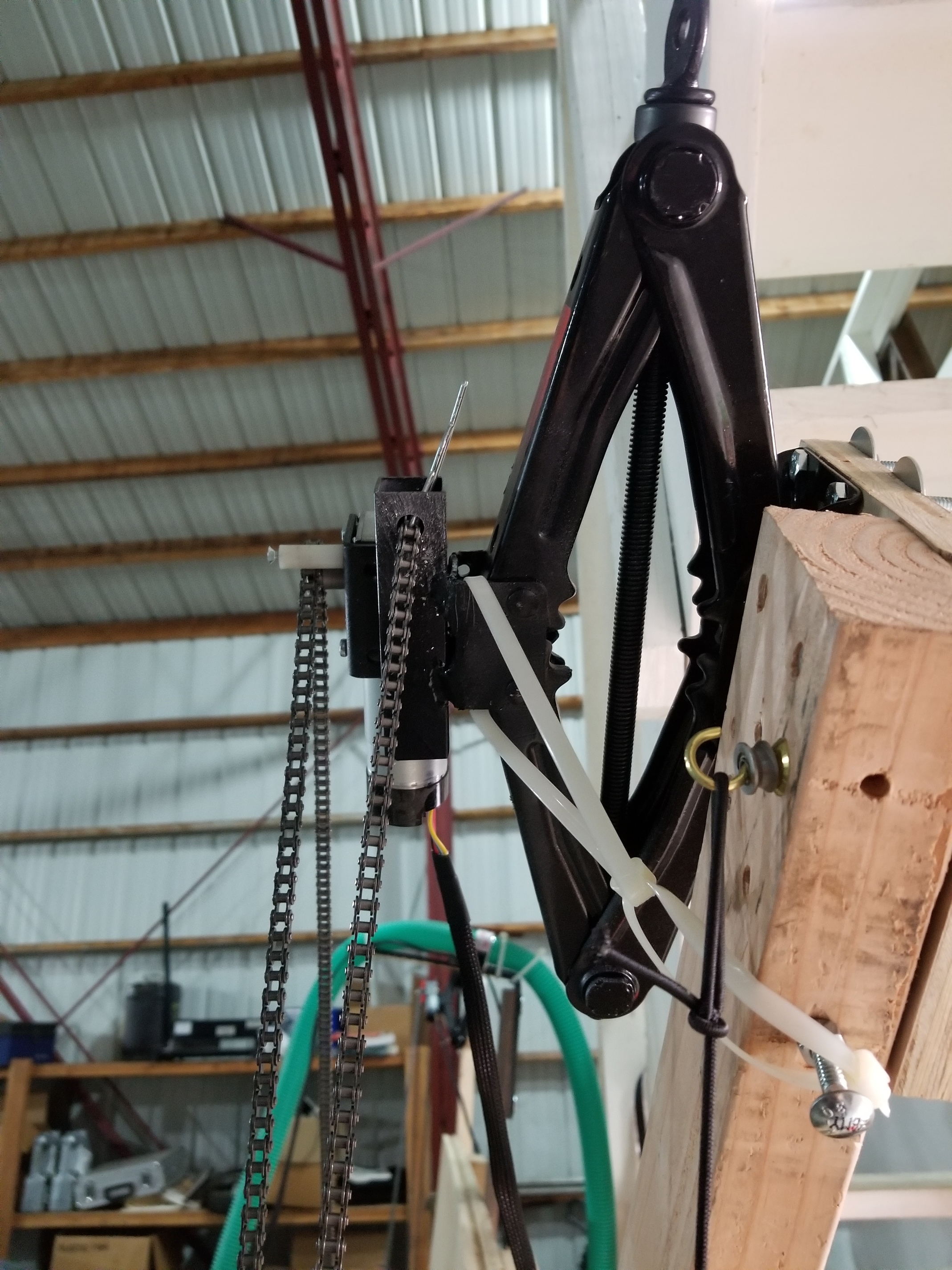

I know this is a little wacky but what about mounting the motors on a Jack.
Fasmov Scissor Jack-1.5 Ton,Black https://www.amazon.com/dp/B01MUODRKY/ref=cm_sw_r_taa_t9SoAb0DP0G8H
I like the idea. Now if we could just find a small one at a reasonable price
not as small, nor likely rigid enough, but closer to the right price range

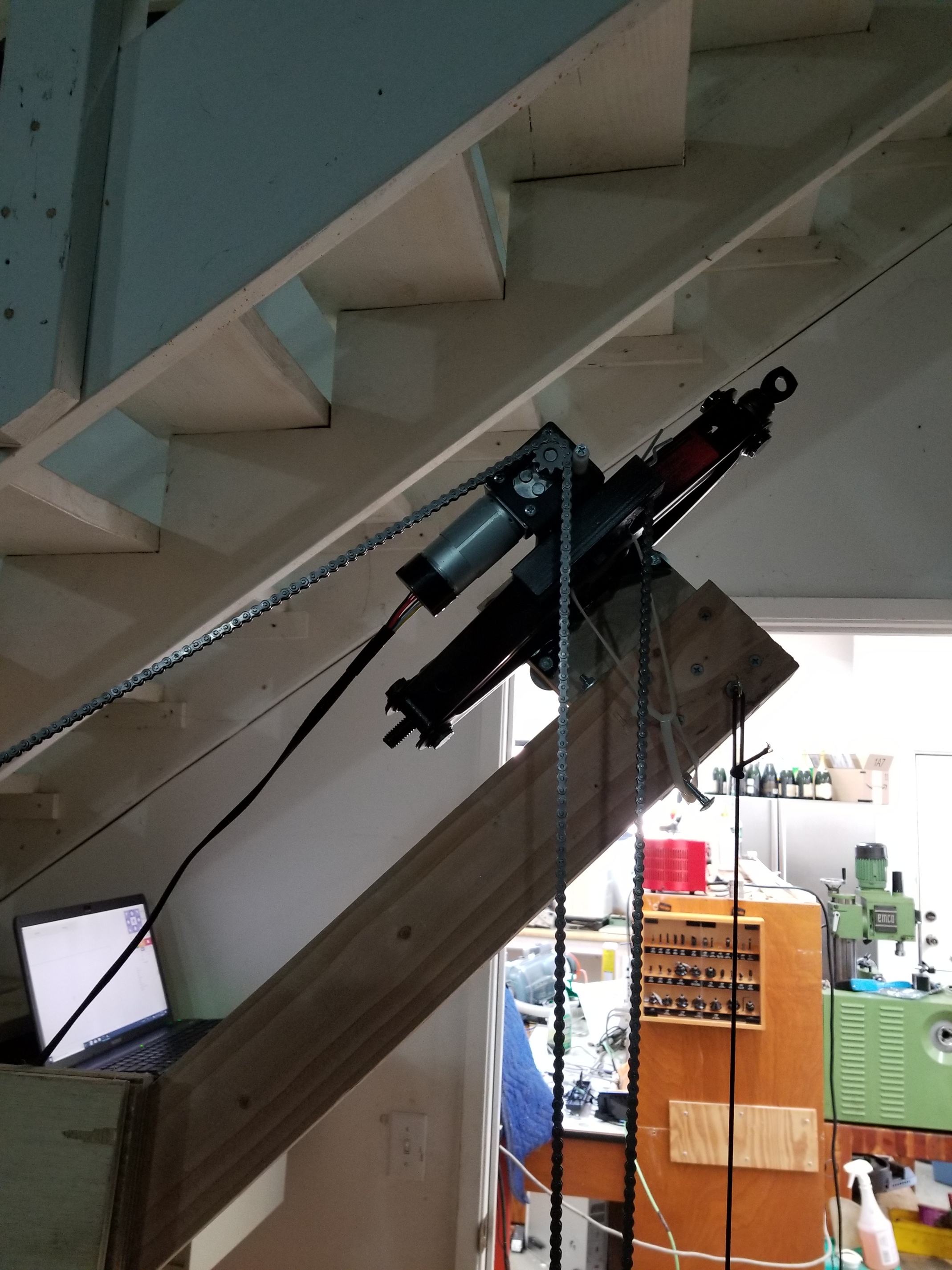

I tried using the jack idea and it work pretty well. I had to use zip tie to keep tension as it did have some play.
20171228_13500820171228_13501220171228_135029
nice work!
