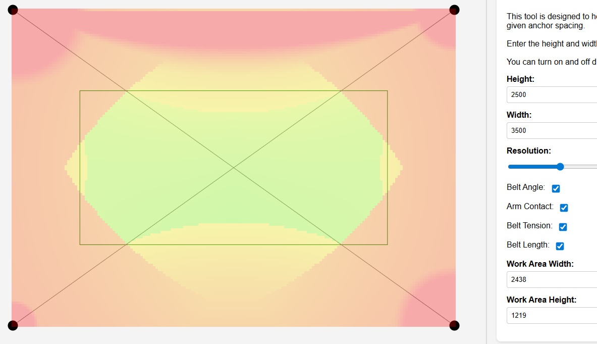

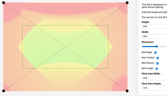

EDIT: I just read 1st post again, “Anchor point measurements for accurate cutting on 4x8 sheet”. Neat, am curious about best practice recommended dimensions too. So… I looked at…
- Building the Frame — Maslow
Attaching to the Floor — Maslow

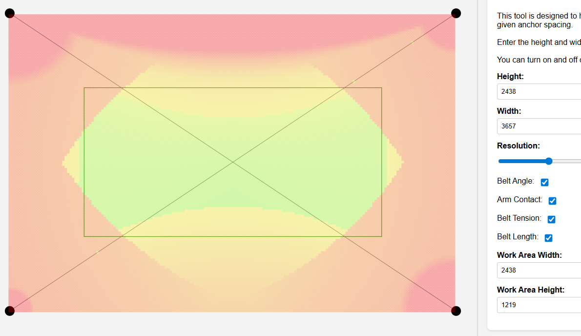

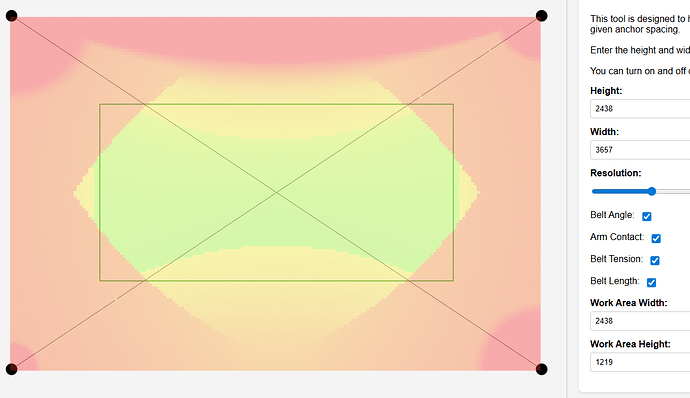

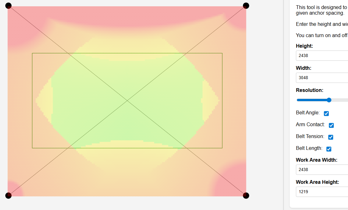

- “roughly rectangular shape 8’x12’ (2.5 x 3.5m).”
Shows wood frame design 8’ x 10’ (2438.4 x 3048)
“If you have room you can use 12’ 2x4s to get even better performance”
- 8’ x 12’ (2438 x 3657)
- Can’t see recommended dimensions, so am ASSuming wood frame dimensions would be used.
Am still curious, for garage slab setup, needing 10’+ anchor width spacing to allow car to clear (since garage door is 9’ wide). What’s the recommended spacing for holes (I only want to drill once
), given the kit’s belt lengths, and given the balance of belt force/accuracy and minimal overall slop/inaccuracy we’re striving for?
