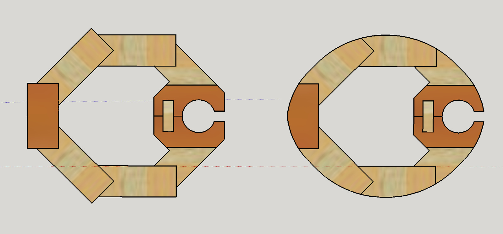

A third option for someone who’s building the boat is to also build the mast. This usually is a hollow wooden tube made up of several “birdsmouth” sections all glued together to form a polygon. Then you get all the fun of shaping and sanding it down to a cylinder. For even more fun, some boat plans specify tapered masts. The birdsmouth approach increases the surface area between individual sections that get epoxied together, forming a much stronger column.
You can also get fancy and emulate a standard mast extrusion.

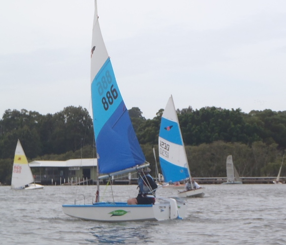

A nice alternative to the Optimist is the Firebug from NZ designer John Spencer. I had the good luck to sail the very first one in the late 80’s and the class has been slowly growing. John lived in my home town and was a regular down at the boat club where we spent our days messing about in anything that floated.
They are quick little boats and are capable of getting up on the plane, whilst also being perfect home build projects. The kids and I are going to build one this summer, albeit without a Maslow to cut her out as my shed is too small at the moment.
