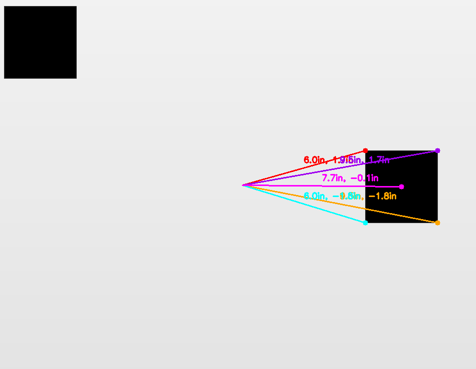

The pcb was randomly placed and captured with a web cam. Points from the gcode are linked with the image and the gcode rotated.
Using info in this blog:
https://www.pyimagesearch.com/2016/04/04/measuring-distance-between-objects-in-an-image-with-opencv/
I was able to modify its demo program to calculate offsets from the center of the image. The block square in top left is the calibration image and you tell the program how wide it is (1.5 inches, for example) and the program calculates the distance from the center of the image to the four corners and center of the other square.

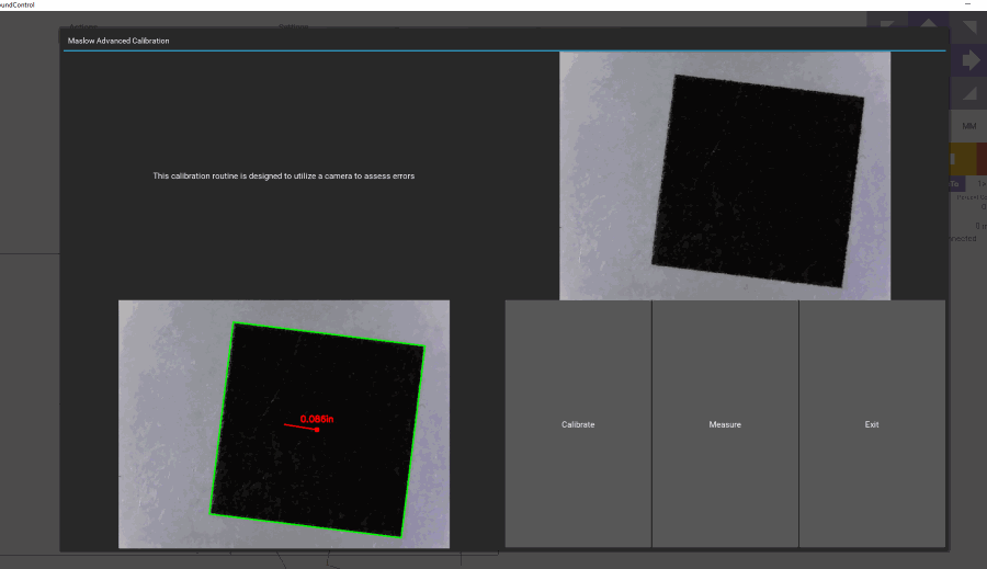

So, it’s possible to measure. The endoscope I have isn’t behaving properly so I used my usb microscope. The square is 0.5 inches. Top right image is a live video feed. bottom left image appears when you calibrate or measure. First you calibrate to determine the scale, then you “move” the camera and when you want to measure the distance offset from the center, you press measure. Exit is supposed to release the camera and exit the routine (I haven’t figured out out to exit the routine… must be something simple)
My endoscope is working better now (I think it’s behaving better since I was able to figure out how to do a graceful exit). 640x480 is way more than enough so I think the one you have will work (as long as you got one with a long enough cable). I’m going to work on a mount to install it in the body. Just need to cut some plywood into a stack of rings. I wonder what tool I have that might be able to do that… hmmm… :wink:
