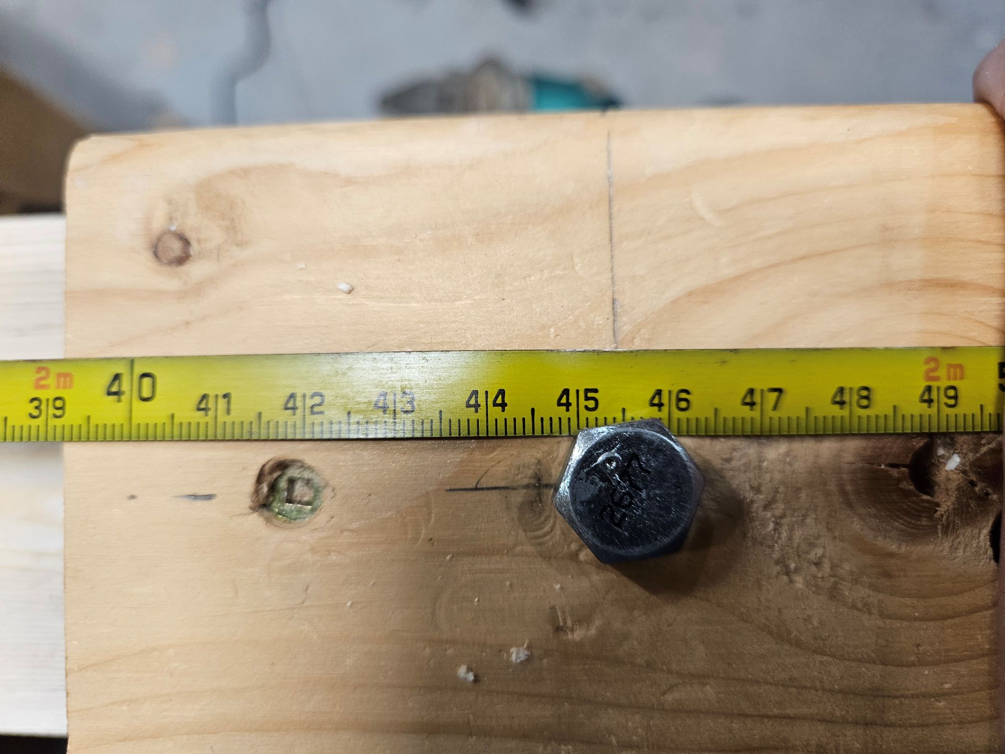

oops… my pictures didn’t come through when I commented last using my phone. Here are pictures of my width and height:
I am entering width of 2036mm and height of 1334.3mm in the software.
Here are the measurements of my frame on the angle:
I guess technically it is slightly racked, but only off by 8 or 9mm. That should be close enough right?
