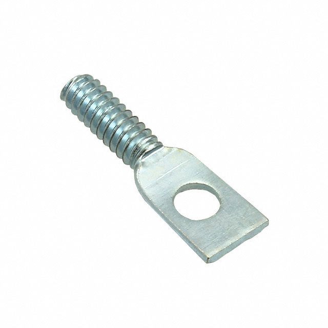

(Is there another word or space I can find M6 M8 blade screw?)
Looks like a hanger bolt. In the US, theyāre not commonly available with metric thread, but they arenāt that hard to find.
Try a search for āspade boltā. Most of the results look like they will need some change to the end to fit the chain.
https://www.digikey.com/catalog/en/partgroup/spade-bolt/58716
http://www.keyelco.com/product.cfm/product_id/14030/checkStock/1

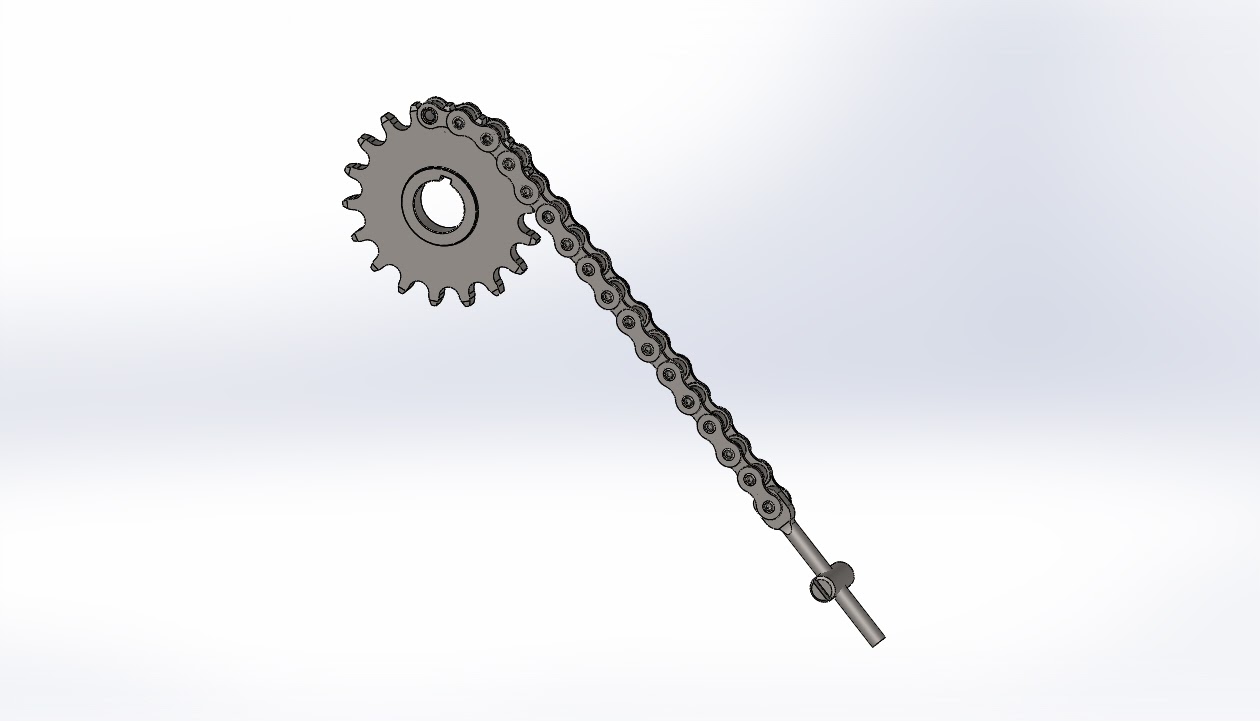

For what itās worth the kits Iām selling come with chain attachment hardware. Itās a sort of wooden clevis. I know it sounds weak but I tested them and they hold more than 150 pounds each! Thatās more than twice the force the motors are even capable of exerting!
At the time of testing I only had 150 (measurable) pounds available and they didnāt break with a full load. I have not broken one yet but I plan to do it eventually, I just need to be able to measure the force.
Of course if youāre making your own then you could probably bend your own metal āUā bracket⦠Thatās what I did for prototyping. It was super easy but not really realistic from a production standpoint (for me).
I think itās strange to buy linkage when itās this type of product Maslow is designed to produce.
You are welcome to post photos and or models of your solution.
I love mcmaster.com it has 3D models of all the components they sell.
