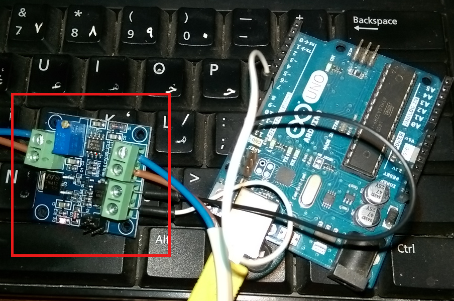

This (on the left) arrived today. I had no other chance then to play wit it.
Although I was sceptic that it only put out 9.2V at 255 PWM, the testing results are for me impressive.
I used an arduino-uno to create the PWM sigal for the module and tested and measured steps.
Further testing:
–> 40 <-- is a cool ‘S-command to PWM-value to spindle-RPM translation number’ for my setup.
This would be the setting/variable to adjust for different hardware.
Increments of 5 in the PWM result in increments of ~200 in the RPM.
But what happens with a S-command not resulting in a integer number for the PWM?
Testing with the aduino uno, putting a value of 102 for the PWM gives me the same RPM as 102.999 does (S4100 would translate to PWM 102.5), so at least on the uno, decimals for PWM seem to be completely ignored.
I could live with that, as 1 PWM difference is 40 RPM difference and I doubt that I would need that precision, but thinking that this might be a more universal pin, other hardware like a servo might require that we round that to the closest integer. Thoughts?

Just posting this here so that others can see what you bought and what it does. I have no affiliation with Banggood other than as a satisfied customer.
Regarding your constant of “40”, this needs to be recorded somewhere, but it is different for different machines. I’m not sure if it should be in Ground Control or the Arduino. Probably the Arduino.

I’m not sure I understand your post completely, but will try to answer as far as I can.
Creating a defined PWM pin in the firmware will always have integers from 0-255, no matter what you connect to it. In my case that results to a voltage output for my spindle and is 40 because of the RPM’s I’ve measured.
S-comands in the g-code do stand for spindle speed, but I thought if a variable laser exists, it could also be controlled by the same pin, simply changing that divider/multiplier so the S10000 gives you whatever value you need on the PWM pin. What hardware you connect to it to deal with the PWM is a separate thing.

Update: The potentiometer needs to be removed for full spindle speed control. It ‘kind-of works’ if the knob is not on min or max, but did not bother to measure RPM as I found that removing it gave me full control.
