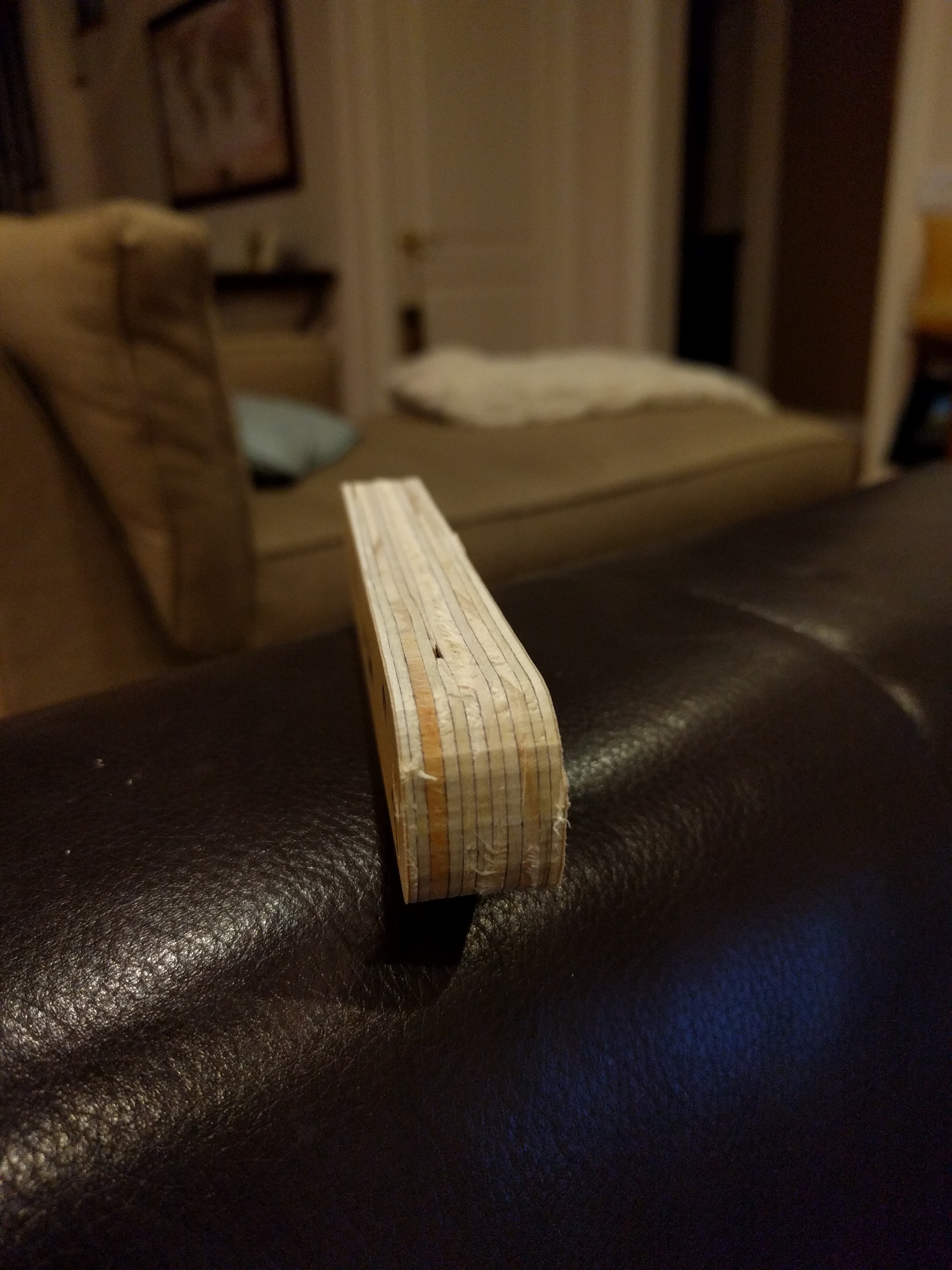

Alright, I spent some time tonight doing controlled tests.
The Short Answer
I am not sure either of these options did anything, but I don’t see much harm*. My tests are too small and simple, it is possible on a more complicated design that the benefits may be more apparent.
The Data
I cut three of the same pieces with the following settings:
  1. Cutting speed 35 ipm, Corners 15 ipm, Full Depth Finish .05 stepover 15 ipm speed
  2. Cutting speed 35 ipm, Corners 15 ipm
  3. Cutting speed 20 ipm
All had the same .18 depth of cut and 10k rpm. All were cut in the center of the machine:
They are the three cuts in the middle.
Piece One Ramp Down in Corners and Full Depth Finish
The edges of this one really do look much better. But the corners could still use some sanding.
Piece Two Ramp Down in Corners
It is hard to see in the photos, but there is some evidence of the changing speeds on the top edge. The edge is also more rough without the finish path, but it would be relatively easy to sand it up.
Piece Three 20 ipm Everywhere
I chose these settings because it takes about the same amount of time as the first piece.
The edges are still more rough as expected. But there is no evidence of feed rate changes.
