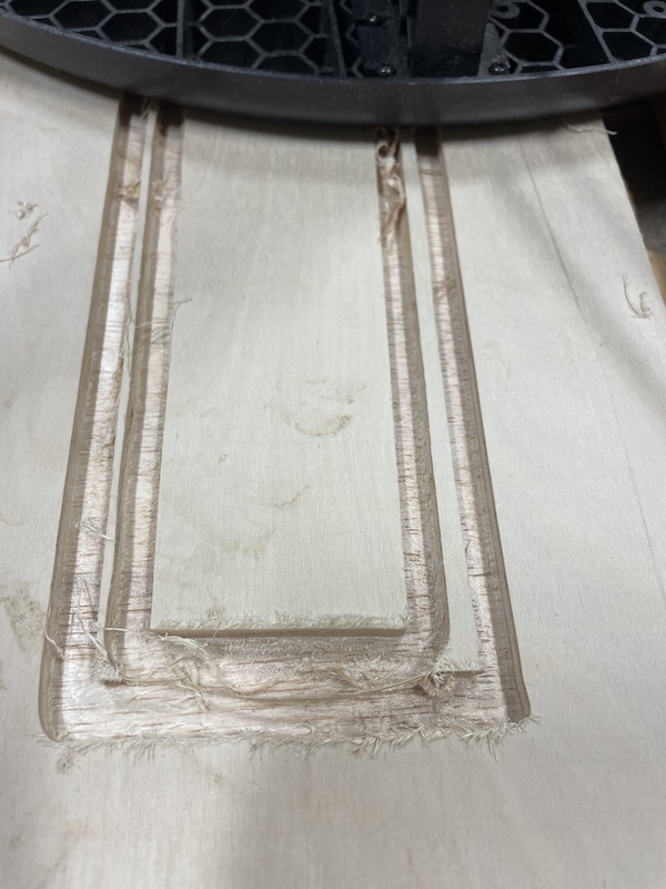

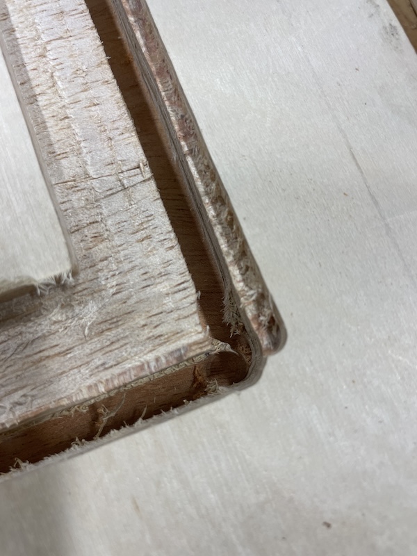

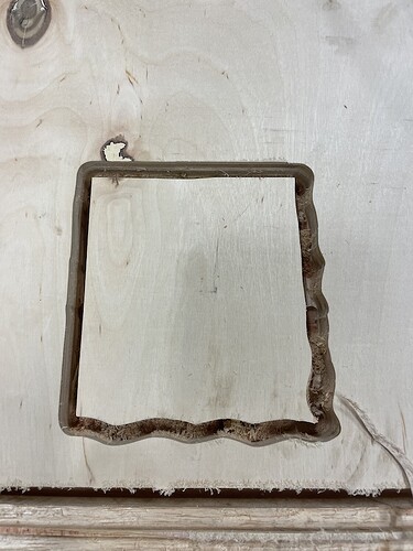

It is obvious from the photos that none of the cuts are straight. 1mm of slop I could fix with sandpaper, plane and chisel, but in many places the machine is off by >3mm. None of the rabbets were completely cut out. The baffle with round cutout is nowhere near square and looks worse than if it was cutout by hand.
After more than an hour of cutting the machine started acting drunk and finally shut itself off. The whole time I was watching the M4 like a hawk, and had not been looking at my computer screen. After the shutdown I noticed that there were some errors on the computer. Here’s a copy of the log taken right after it shutdown:

We are definitely still very much in the early adopter stage of the technology so there is a lot to learn and improve on, but you should be able to get better results than that.
What was your depth of cut with each pass?
How did the tension in the belts feel while you were cutting?

That’s pretty aggressive, but not crazy. I haven’t personally tried cutting that deep per pass, but I don’t think that is the core issue here. Generally speaking, but shallower the depth of cut per pass the cleaner the results. I’d recommend giving like 3mm/pas a try.
This sounds like the real issue to me. I think that there is something jammed up in that arm probably the spool isn’t allowing it to rotate freely. Unfortunately I can’t think of a way to test or fix that without taking the arm apart.

Just chiming in to say your speeds and depth of pass are not the problem here. Those cuts look shocking, but it’s not speed.
I have a horizontal mounted M4 using threaded bolts into my concrete garage floor too. I’m having no issue with 6-8mm passes at 2,000mm/min speeds.
(Back yourself Bar, the M4 is better than the nervousness you’re showing in this thread :upside_down_face:)
My 2c, it’s definitely a problem with that 4th arm. I have had those tell-tale “drunken” wobbly lines before and it was a problem with the grub screw inside the arm. Bite the bullet, disassemble, take your time, take it apart gently. Tighten the grub screw. Add Loctite this time. Patiently reassemble. She’ll be right as rain. :flexed_biceps:

My bet would be that the workpiece is moving, I think Bar had some trouble with that as well. If you’re already drilling the concrete for the corner anchors, why not drill a few more and epoxy some threaded anchors into the ground for the spoil board?
