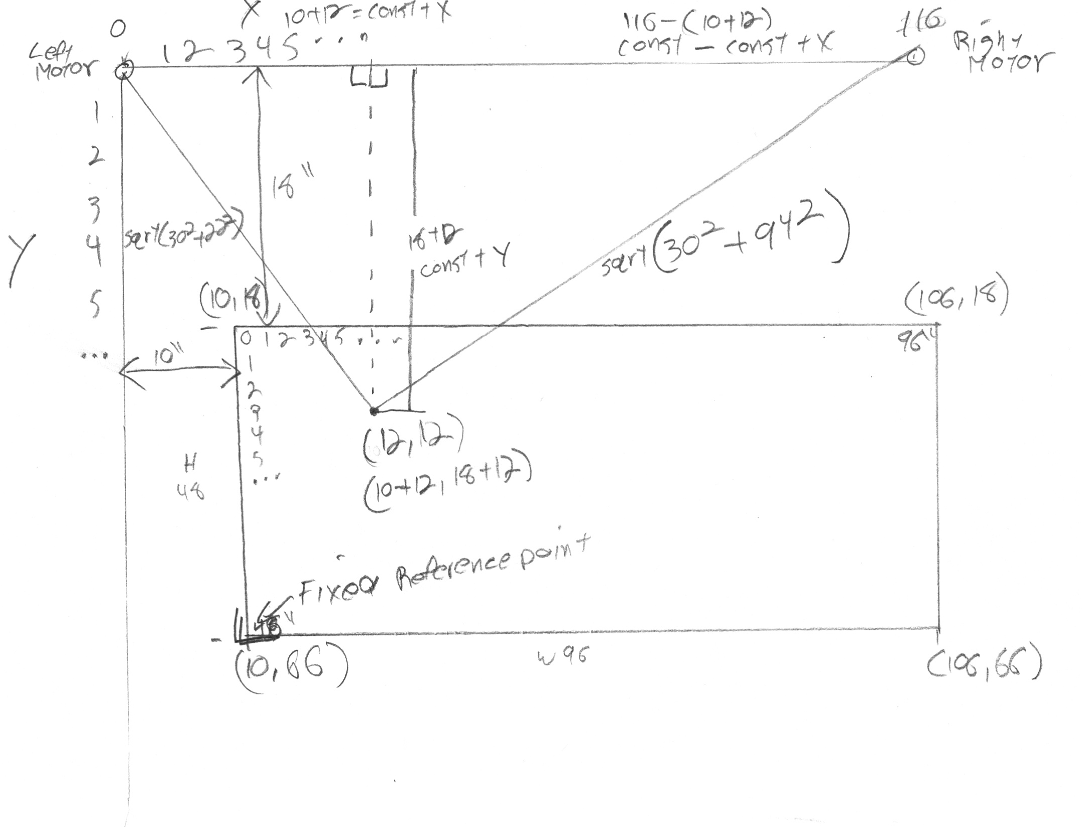

So I was trying to understand the kinematics code today and was hampered by the fact that there were several angles named only with greek letters and I did not have any diagram describing where they are. So I started to think how I would do it and at least 1 part of the job requires nothing more than addition, subtraction. and the pythagorean theorem. Please look at the attached chickenscratch and tell me where I am wrong. It seems like this would be a computationally less expensive method to find desired chain length for a given point.
  1. transform whatever coordinate system you have into cartesian with origin at left motor, only positive values growing down and right, like computer graphics.
  2. split the main triangle (Lmotor, Rmotor, point) into 2 right triangles. All the adjacent legs of both right triangles equal the given coordinates plus a fixed offset.
  3. Each chain length is just the hypotenuse solution to one of the right triangles.
_verifyValidTarget(&xTarget, &yTarget) becomes a simple matter of bounds checking the coordinates, no angles required.
I’m thinking of this with the parallelogram chain in mind, so some small correction factors might be different, but I don’t see why the triangulation math couldn’t be as simple as 2 fixed and 1 variable point.
The pythagorean theorem is at the heart of the triangular kinematics, but the motor end of the chain must wrap partly around the sprocket to an amount that varies. Look in the repo for ‘triangular kinematics’ in issues and commits to see discussions of that and some of the other details that take the calculations beyond the simple triangle.

leftChainLength   = computeLeftHypotenuse(commandedX, commandedY);
rightChainLength = computeRightHypotenuse(commandedX, commandedY);
leftChainLength   += errorCorrectLeft(commandedX, commandedY);
rightChainLength += errorCorrectRight(commandedX, commandedY);

I really so like to have people dig into the code and if you can submit documentation patches as you figure things out (or think you have and want confirmation), it will help more people down the line.
remember that the quadralateral math was there first, and it’s a lot uglier than the triangulation math, but a lot of the variable names were just re-used. Also, whoever named them had a diagram they were matching, unfortunately time, and the change in forum software has caused us to loose track of that diagram
nope, the code is the specification.
