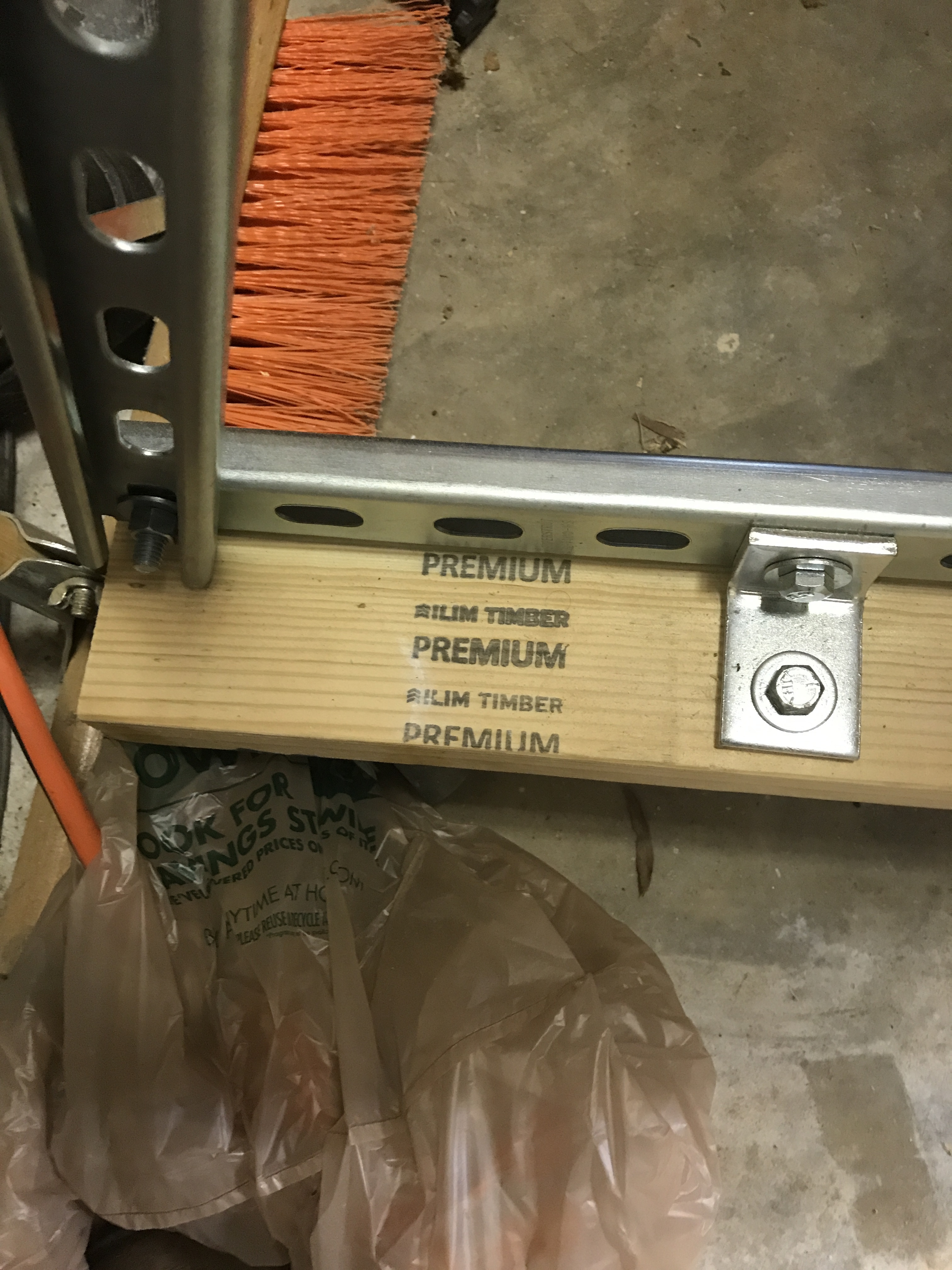

Bottom front… I have a 2x4 stuck between the bottom unistrut and the backboard to hold up the workpiece. I’ve got to find a better solution here, as it sticks out way to far and obviously will snag the sled.
The bottom with casters… this is the weakest/most problematical part so far… this pictures is looking down on the bottom front to rear piece. The angle bracket is boleted to a piece of 2x4 with casters lag-bolted to the bottom of the board. It works, but they try to “twist” too much.
I intend to mount another piece of unistrut (or a 2x4) across the back of this piece between the two legs to hold the angles “apart” at the back. I think this might help the twist if I do it right, and will definitely help with the angled legs trying to collapse “in” when I’m shoving wood into the void space.
