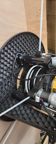

I have tried two cuts with the new Maslow 4.1 both just stopped very far in. The last was gcode from the Garden the standing desk. The unit just stopped and had to be reset. I do not know what to do, at least got the serial data this time. Could I have done something to recover from this?

[MSG:ERR: 20 (Unsupported GCode command) in /sd/Desk_Complete.nc at line 4]
[MSG:WARN: Position error on Bottom Left axis exceeded 15mm while running. Error is -64.470mm Counter: 1]
[MSG:WARN: Previous error was -64.470mm]
[MSG:WARN: Position error on Bottom Right axis exceeded 15mm while running. Error is 15.020mm Counter: 1]
[MSG:WARN: Previous error was 15.020mm]

This is saying that the bottom right arm was not moving correctly or your
calibration was way off.
was the belt slack when it ran into grief? what direction was it trying to move?
Desk_Complete.nc (262.3 KB)
Here is it.
I think may have been obstructed. I have since removed the object.
Do I need to rerun the calibration before retrying or should it be fine as long as the obstruction is gone?
Kevin Davis
Was the obstruction there when you ran the last calibration? If it was yes. How far did the cut go before it failed? You could also try running it without a bit in the router to see if it fails again.
It was not there at the last calibration. I am going to recalibrate anyway to be safe.
Also, the cut went until the obstruction diverted the Maslow, I did not notice it until I went back and looked at the cut. It actually pulled the machine off by at least an inch.

Sorry to jump on this, but I think I have the same issue but nothing is blocking or obstructing the maslow unit.
I have increased my calibration size from 400x400 to 1200x600, grid is now 9x9 and the pull force is up to 1300. It took a little while but I was getting fitness values over 2.
When the unit travels to the far right hand side of the cutting area it emergency stops stating the position is out.
I’ve checked the heat map and its actually stopping in an area that is highlighting as green.
I’ve noticed that one of my cables isn’t reeling in or pulling tight.
I’ve also noticed that my stepper motors are no longer moving but I’ve already changed the board maybe these two things are linked? @bar
My next move was to strip it down and see if they are starting to bind at the bottom or if my steppers are broken either way I’m feeling pretty frustrated agh!
This sounds like a calibration issue to me. Someone else had this same issue last week which prompted us to start working on how to automatically calculate the best calibration grid size for a given frame so you don’t have to.
Can you try running the find anchor point locations process with a larger grid (something like 500x900mm)?
Basically what’s happening is that since the process didn’t use any information from the far right side of the sheet when finding the anchor locations they aren’t quite correct over there.

the larger the area of the calibration grid the better, unless you get to a
point where the arms hit the uprights on the sled)
