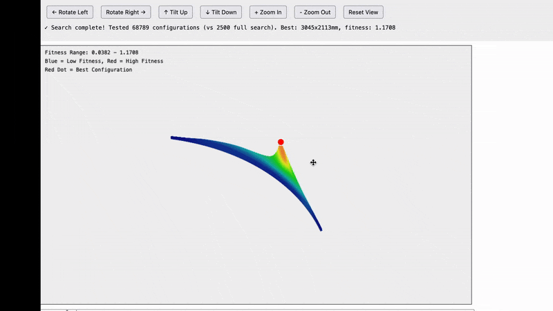

Here are the results and they are quite interesting.
ezgif.com-optimize
Note that this is not a graph of the machine itself. What we are looking at is possible frame widths on the X axis and possible frame heights on the Y axis and the fitness score for how well that frame size matches our data in the Z-axis. For example the bottom left tile is for a frame of size 100x100mm, the tile one to the right from that is for a frame of 200mmx100mm…the top right tile is for a frame that is 5,000x5,000mm.
The insight we’re getting here is that all of the possible frames which reasonably match our data seem to fall on an arc centered around 0,0.
I’m not sure exactly what this means, but it does dramatically reduce the search space that we need to explore.
I’m going to keep investigating

Knowing that we can limit the search to just around that arc (it does appear to be a circle) allowed me to increase the resolution without needing to wait years for it to compute.
There does seem to be a clear maximum at the correct frame size, but the data is quite noisy so we can’t simply walk the curve until we find a local maximum

OK I have some more good news. I optimized the system to the point that it can handle higher resolution sampling and the noise went away
ezgif.com-optimize(3)
It looks like the good points fall on a really narrow line along the arc and the noise that we were seeing was coming from quantization (basically any time one of our grid sample points happened to land close to the circle.
Interestingly I played around with plugging in a larger data set and that seems to widen out the circle which is neat, but not really that important for us since the goal here is just to get a better initial guess before we begin using the genetic algorithm to refine our results.

@bar - checking my understanding of your visualisations - is this fitness-for-a-given-frame-and-set-of-belt-measurements (Z) against X/Y where each X/Y is a theoretical X/Y length/height for a possible (assumed rectangle) frame that we think those belt measurements in Z could correspond to?
I guess my real question is - is this on one set of calibration data, or have you tried it on a few different shapes / sizes?
This is exactly correct :grinning_face:
I tried it on a few different shapes and sizes and the pattern seems remarkably consistent
Yeah, my guess would be that the arc would scale with different frames or possibly get fatter the more flex is in the system, but that’s just a guess.
My intuition is:
  • It’s an arc is because the same belt lengths can trade X for Y (ie the same belt lengths could be the actual frame size, or one that’s smaller on X but larger on Y).
  • But having multiple spaced out sample points is what gives you the Maxima for fitness.
  • The flex / stretch / etc in the system is what stops it being just a point.
But that’s purely speculation.

My hunch for why it looks like a circle is that for a single set of measurements all of the possible frame sizes seem to approximate a circle.
ezgif.com-optimize(5)
I’m not sure what that would look like when we add more measurements (in theory it should be a point), but I guess that points along the circle still appear “less wrong”
That is a very good visualisation of what I was trying to say! :joy:
I’d imagine that if you plot that movement for one of the other point’s belt lengths, then where the two arcs overlap would be the fitness Maxima…
It’s interesting that in a round about way you’ve arrived at a sampling algorithm - you’re doing a simplified grid sampling rather than picking random points in the space, but still it is a sampling algorithm!
